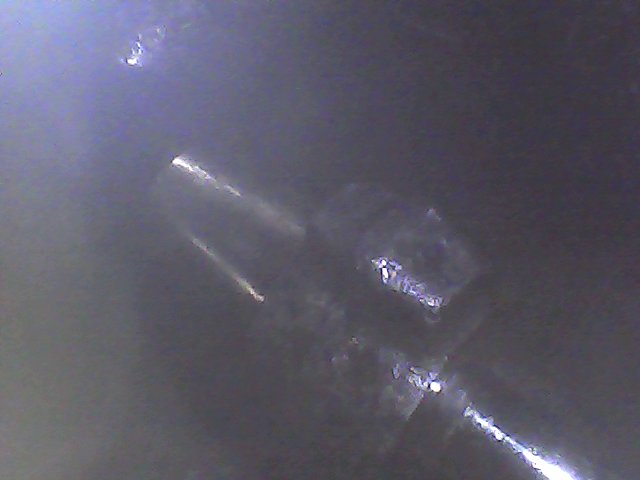

File comment: Should there be seen the top of the piston..?

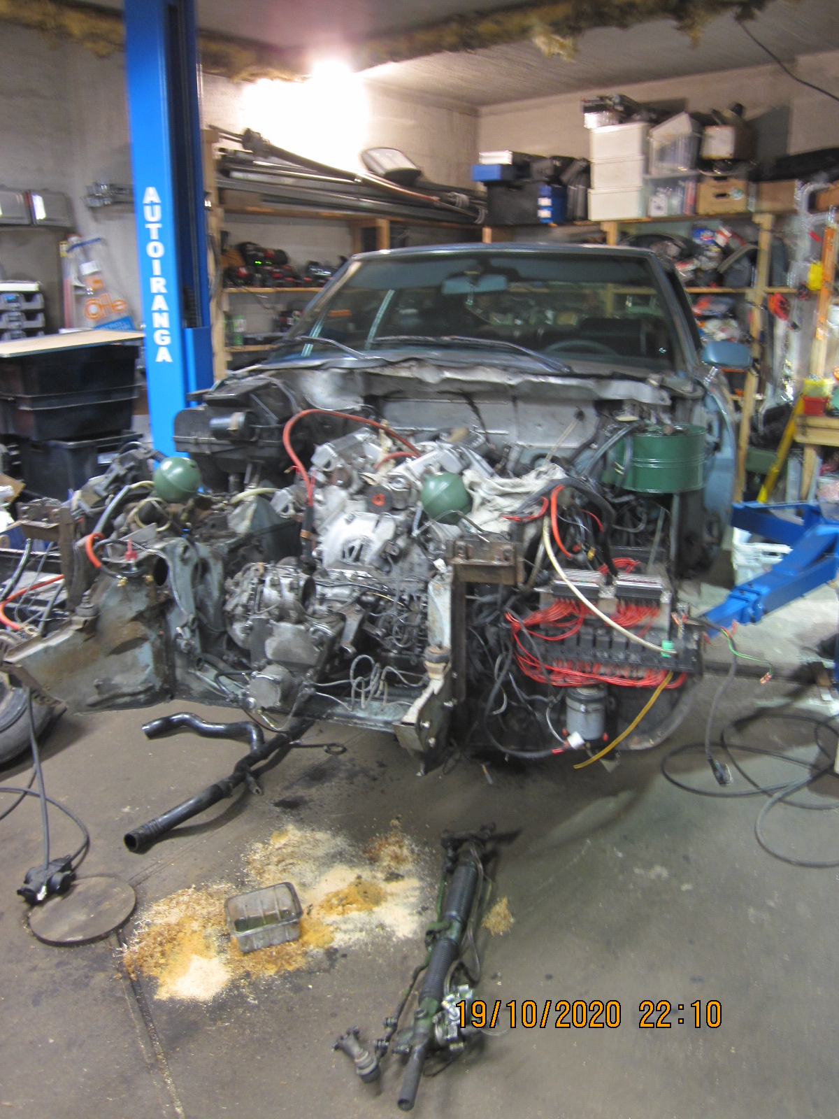

Took exhaust headers out, and then engine/gearbox out...

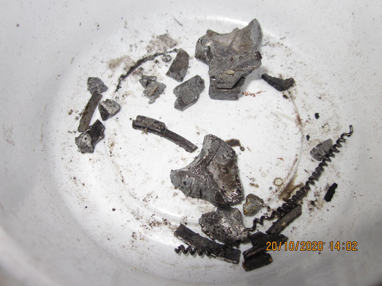

Those came out from exhaust. Piston and ring parts. Quite big pieces, wondering how much more is on silencer...
