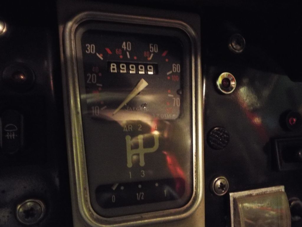

Changed oil & filter, washed air filter, checked plugs [they were OK] and swapped plugs [RtoL & LtoR] , cleaned plug leads, greased the kingpins & driveshafts, sprayed some "spray grease" on the knife edgey thingies, and adjusted the handbrake [yet again].....a couple of squirts of Olive Oil in the spring cans [Wifey did'nt have any "Trex" chip oil lying around in the kitchen :roll: ]
All ready for summer now :D .....with an [almost] nice round figure on the speedo.....and I'm off on an overnight 50mile jaunt into Derbyshire in tomorrow evening... :D 8-)

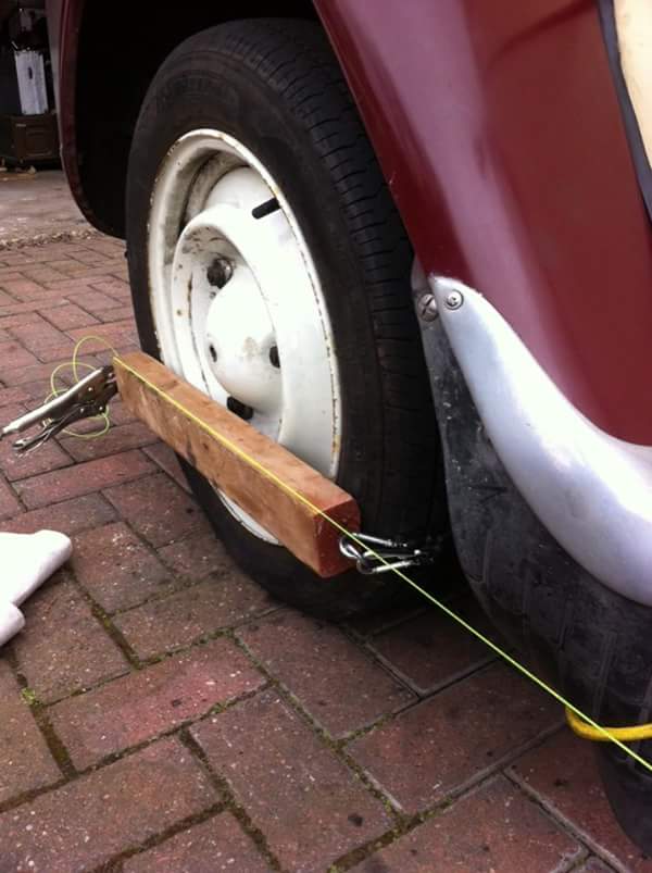

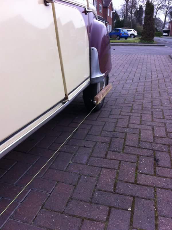

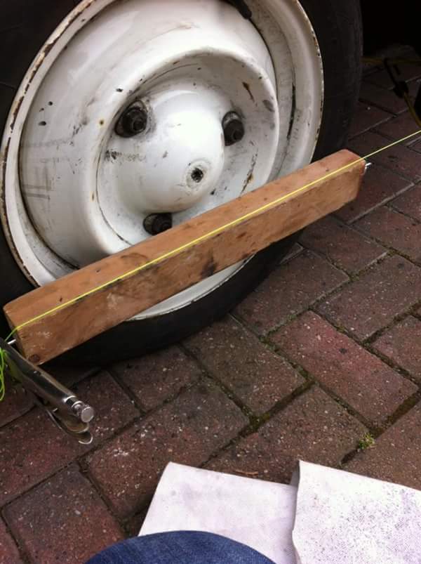

My variation on checking tracking. The two lengths of stud have eyelets screwed in each end with a bungee around the wheel, that holds them tight to the wheel. I used 2mm strimmer line attached to the rear most eyelet, which when pulled and fixed around the front most eyelet gives you your line twix the wheels, this then gives you your tracking measurement point.
I used the strimmer line as it is strong brightly coloured and only £1 from the obvious outlet as were the bungees. The eyelets l already had along with the stud so the total cost 3 quid :-)

Im doing almost the Same. Only I Use small Lego bricks which fits nicely to the Wheels...

I wouldn't dare use Lego my granddaughter would not be pleased :-)
