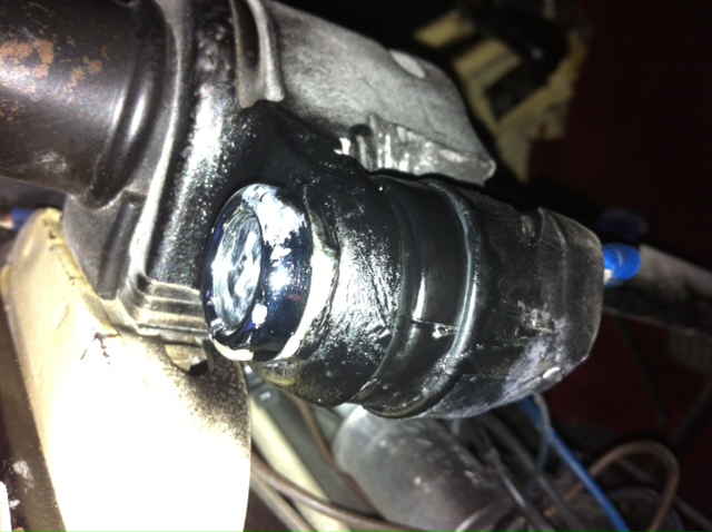

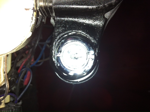

Having had my ignition switch start to jumb l decided to replaced with an after market One off eBay cost me £6 with 2 keys, it also offers a switch position to feed radio.
I cut away the bulk of the original alloy lock casting, leaving just the top of the casting where the original lock fitted. I did the cutting with my small angle grinder and a milling tool in my power drill.
The new switch is held in place with it's threaded fittings and due to the hole in the original fitment being a little larger than needed, it was filled with expo and a quick spray with some matt black finished it off. :mrgreen:
