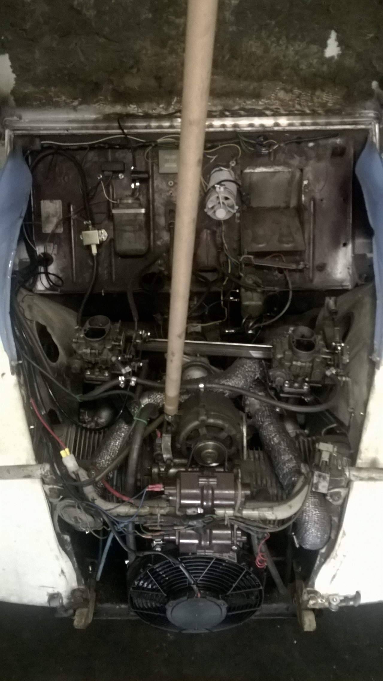

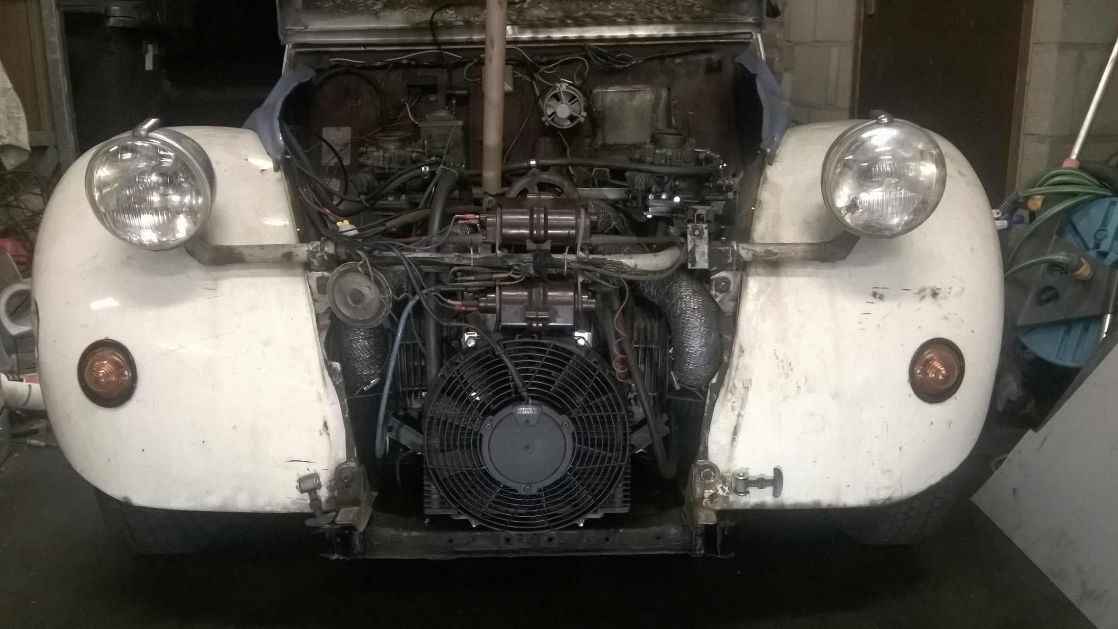

I can't imagine that any fan, small enough to fit in the tube, will be more effective than the 1 horsepower fan in front.
. Waiting for a trafic light.with the engine iddeling it is... I bought one for my Beamer engined 2cv...

Ianredspecial wrote:
I'm tempted by that fan..
here it is, no I don't mean the big black one. Take a look at the left side of the battery... It cost me 25,- euro new...
