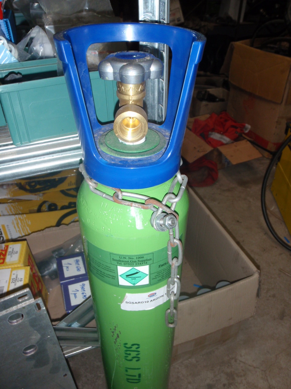

Next step. 10L of pure Argon arrived from the UK. Sean where do I buy the regulator. Another friend is roaming the UK at the moment and can bring it back
In advance many thanks
Viking

Ah!
you dont want pure argon for welding steel you really need the Argon co2 mix
you need pure argon for aluminium and for Tig welding
If your friend is in one place long enough then weldquip will dispatch the next day "to site" ie somewhere other than the payees home adress - usually when your getting plant / materials delivered to the place you are working
For that bottle you need an argon mix valve - side entry
http://www.weldequip.com/argonmix-conversion-kit-se.htm
worth getting the one with the hose as that will be the next thing- ready to go with one of these
most big towns have a "Machine mart" where your mate can walk up to the counter and walk away with the thing.
http://www.machinemart.co.uk/shop/range/guid/628688F9-084E-41F1-87F3-ADE549DC71BB
remember to gat adapter hose at £15 ish
but the machine mart model is a cheap crappy affair.
Sean

Well I'm stuck with this bottle as I can't replace it until empty. Do I need regulator for pure argon or mix?
Bugger my friend is leaving saturday but will ring straight away to find out if they can deliver latest friday or saturday morning.
Cheers
Viking
PS. Order done over the phone. Regulator is the same for pure or mixed argon.

yes Wescol the better made reg and the "argon" is the male connector and does argon and argon mix
