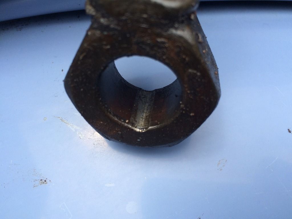

Also discovered an annoying and worrying knock on bump rebound on nearside - jacked it up and kingpin, wheel bearing, track rod end and arm seem OK - then waggled the tie rod and .....bugger it's as loose as fuck on the knive edge so looks like new knive edge at least and maybe new eye as well...plus one of the lip shockers on rear is leaking oil so new set needed as well.

Nels,
did you check the 3 x M9 bolts which fasten the damper plate onto the arm, also the M12 nuts at both ends of the damper?
Re. a 'loose' tie rod, I find that there's usually free play between the the shackle/eye and the pin when the front ride height is set corrrectly.
If the tie rod is wound into the shackle far enough to remove all play, the front end will sit far too high...

Noob error. They aren't 'loose', the shackle and knife edge aren't made to work like that. Just make sure they're greased.
June 13th, 2015, 7:32 pm
:oops: Noob.....cheers Russell only had 2CV's since 1979
Checked all those items Ken - they have been well greased but seem very loose - like very loose and rattily....
June 13th, 2015, 9:05 pm
This is the eye in question - is it knackered?
June 14th, 2015, 3:20 pm
Posts: 2247
My 2 eyes...
Still useable
June 14th, 2015, 3:31 pm
Looks pretty normal. In my opinion a dye penetrant test is more valid than a visual inspection when they're like that. Those hexagonal shackles crack, I tested loads a few years ago, I seem to remember about a third of them were cracked.

hmmm, questionable one, with some imagination I'd say this one has a crack already. had several of those as well, just welded them, left the weld on the outside, on the inside I filed them nicely in shape. never had any problems after that!
