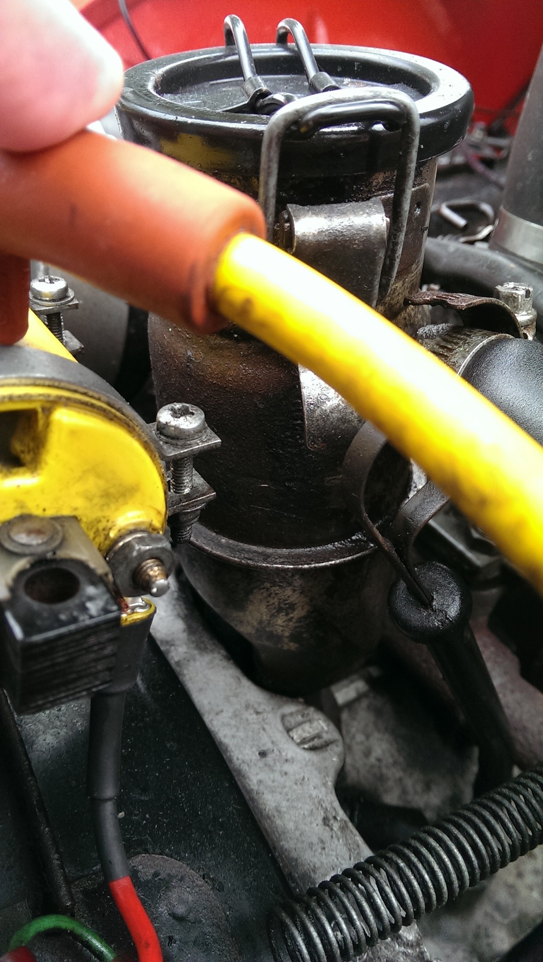

Spliced in a new piece of red wire to the coil. The old one had melted here!
My suspicions were aroused after a lot of spluttering and missing this morning - not normal at all it runs like a champ usually and always has. I thought it was going to actually stop :(
After a quick look at the side of the road I noticed how melty that wire had got, bare wires in places and melted onto a couple of other wires. I stuffed a disposable glove around it for protection and it drove home fine so hopefully thats all it was.
