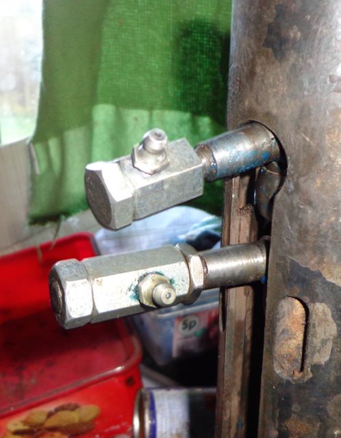

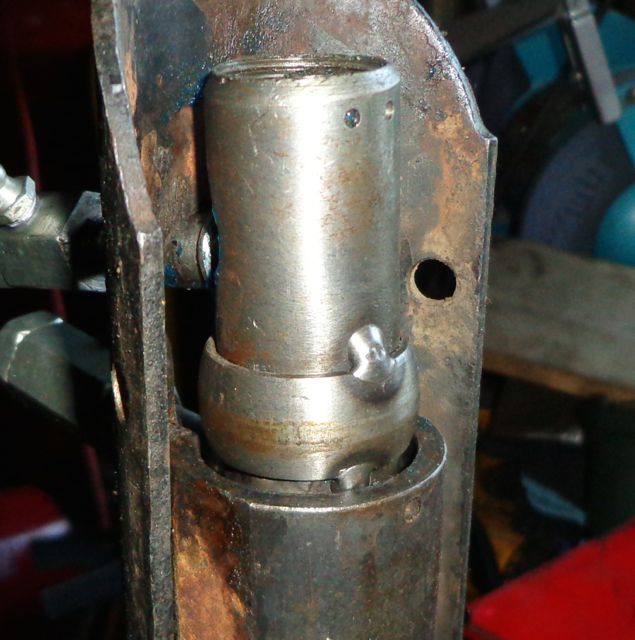

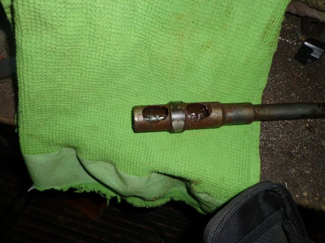

Out of Tolerance Steering Rack.
Old Worn Out Guide Ring.
New Guide Ring Welded in Place
Improved Lubrication
February 20th, 2015, 7:17 pm

February 20th, 2015, 8:00 pm
Nice work. I enjoyed doing my steering rack, they're a lovely thing.
