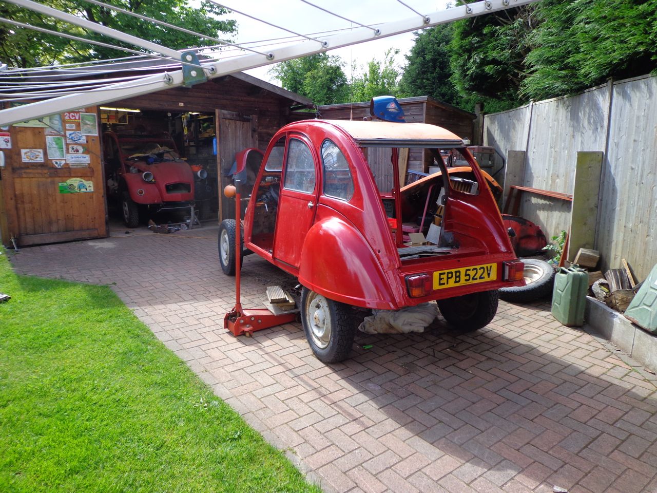

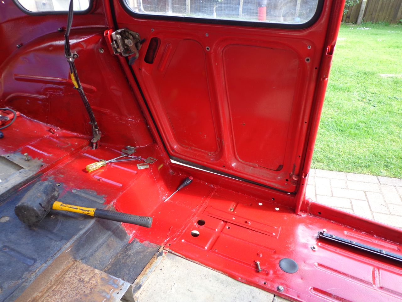

Replaced the other sill and ensured that the door post was welded to the floor.

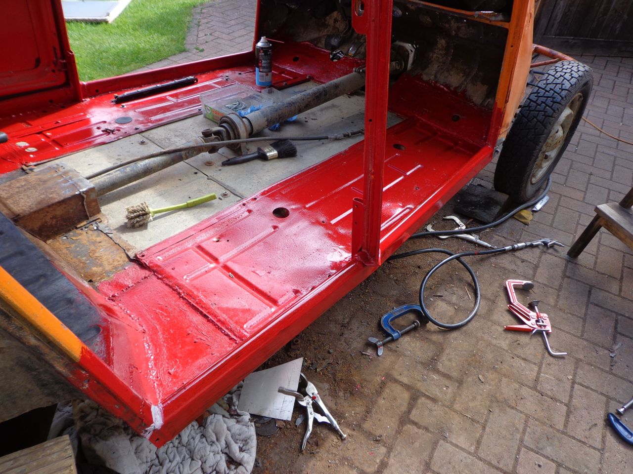

Fitted Rear Wing and Rear door..... looks OK from a distance
Rear sill alignment issue !
Will have to put a capping piece on, to stop the draft
