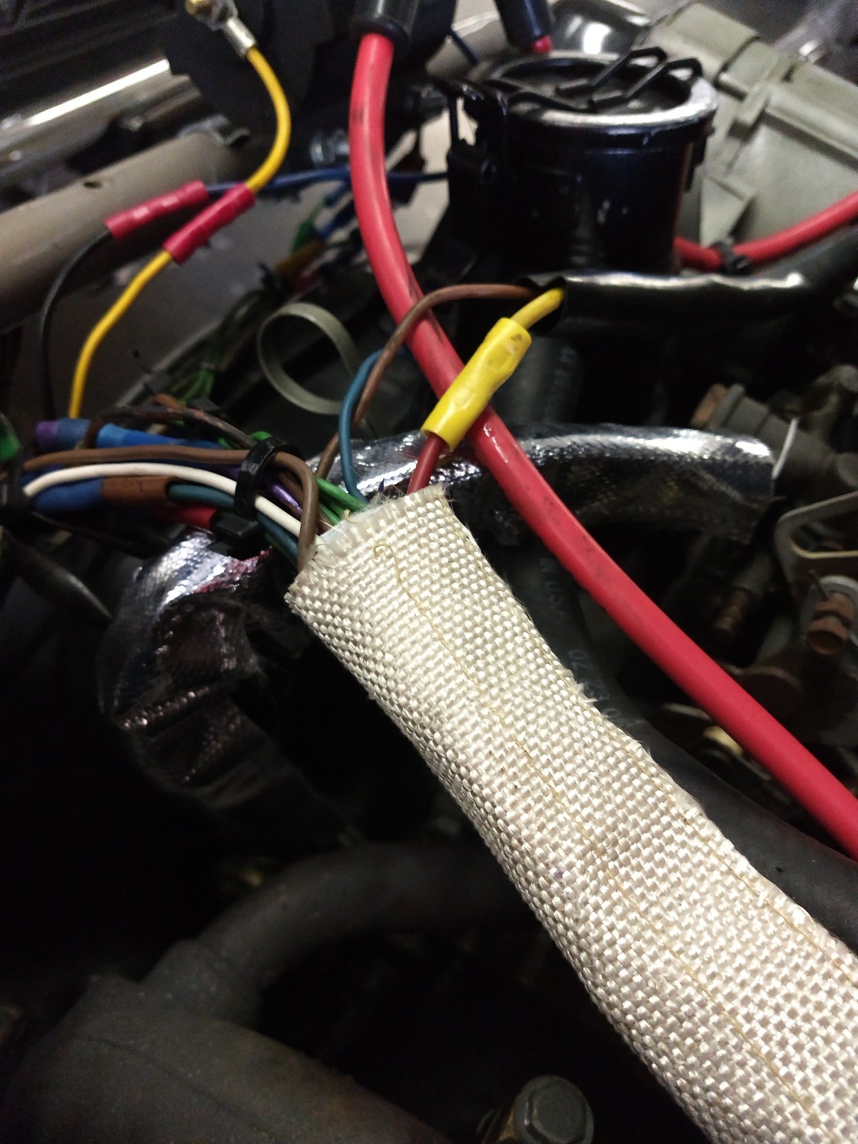

Post Re: Idea to cure starting after hot soaks
I insulated the fuel line from the pump to the carb. I don't know if this will help but it can't hurt. That's where the say most of the heat soaking in fuel lines comes from.
It's 30C right now. That's usually where I start having issues trying to start the car when hot.
At least my 2CV doesn't (has never or yet to) vapor lock on me while idling in drive thrus like my Ford has done. That sucks.

Posts: 322
bobh wrote:
for the 2CV, look up Hot start in Technical forum. I tried all sorts of things, new coil from Mehariclub, twin battery, one for the coil, one for the starter, air filter, easy start around the pivots of the butterfly shaft, compression test when hot.
And you know what fixed it - A "Dry Coil" from ECAS UK - different from the French ones. I have now had more than a year without issues and its been 40 deg C plus on some days. Winter cold starts OK as well.
Can't help with your particular problem though.
The coil I installed was supposed to be a resin filled coil.
Too early to tell since it's not as hot as it has been but the engine is not that particularly hard to start after a hot soak after adding the insulation wrap around the fuel hose.
One of the things that is supposed to help with this heat soak is to place a Phenolic plastic spacer between the carburetor and intake manifold.
The pre-cut carb spacers for V8 engines are a little pricey but the uncut material itself is not. I could buy a chunk of this stuff and make one myself and see if it helps.
https://www.ebay.com/itm/5-8-Canvas-Phe ... SwyZ5UrCNS
Wonder how thick I could make thing?
