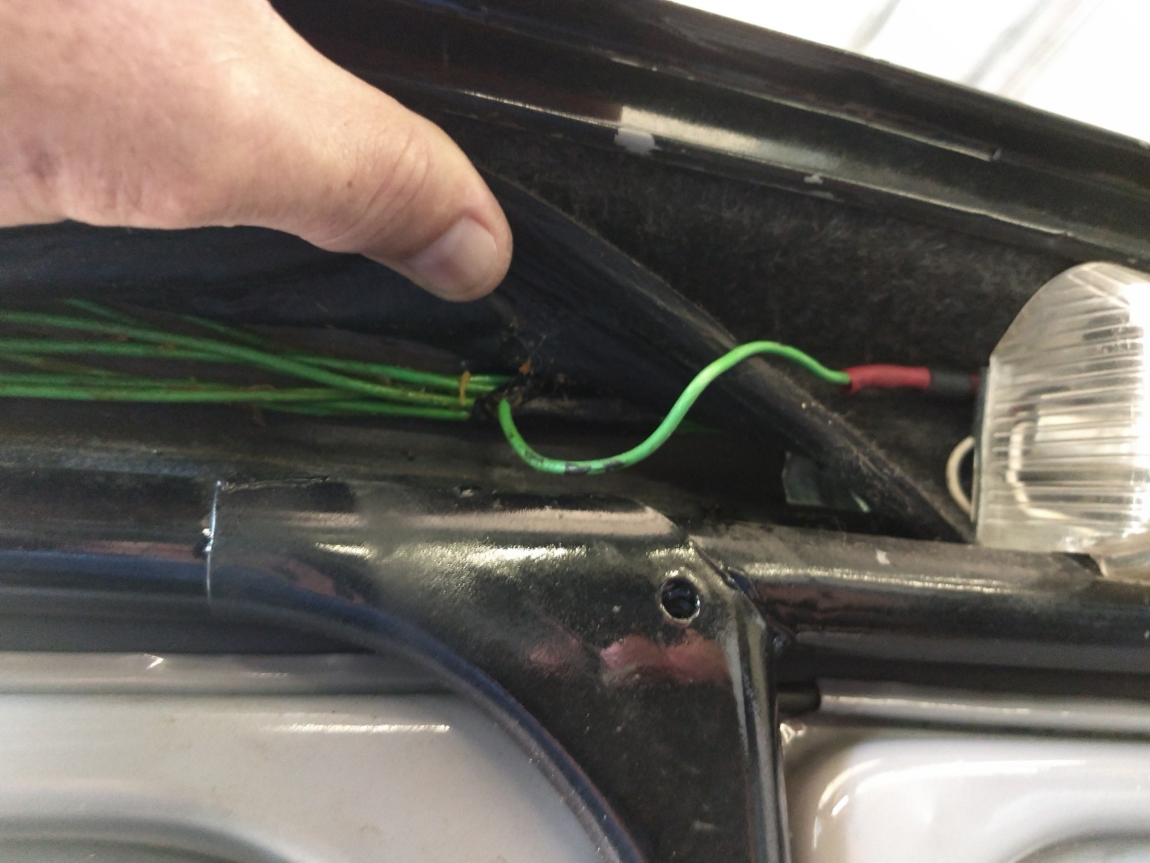

Found it! I pulled the felt back enough and there is it.

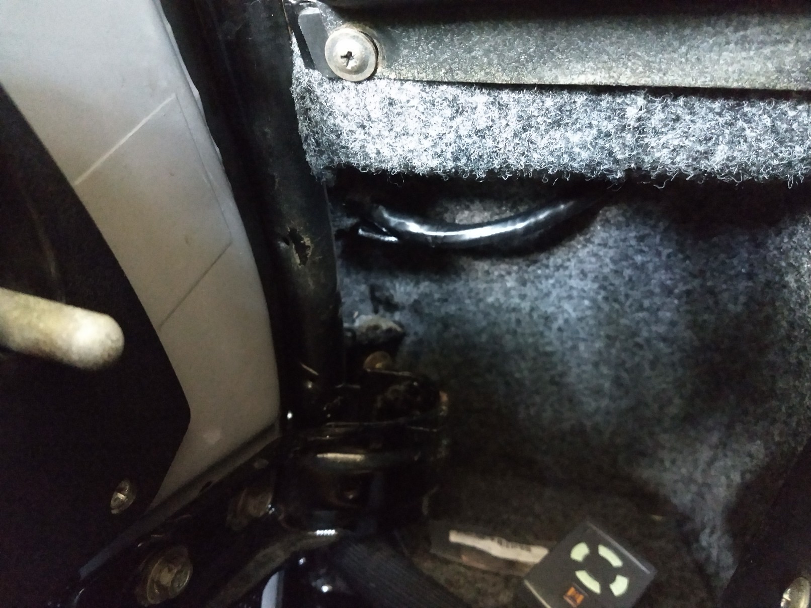

And I bet the wire is amongst these other green wires I wrapped up with electrical tape:
Now I just have to figure out which one of these green wires powers this overhead light and from what circuit it connects to. I have a wiring diagram at the house so I can look that up later.
I'd really like to add a door jam switch so it turns the light on automatically. Any you guys ever done this? I've got an idea but it's a bit hard to explain.
