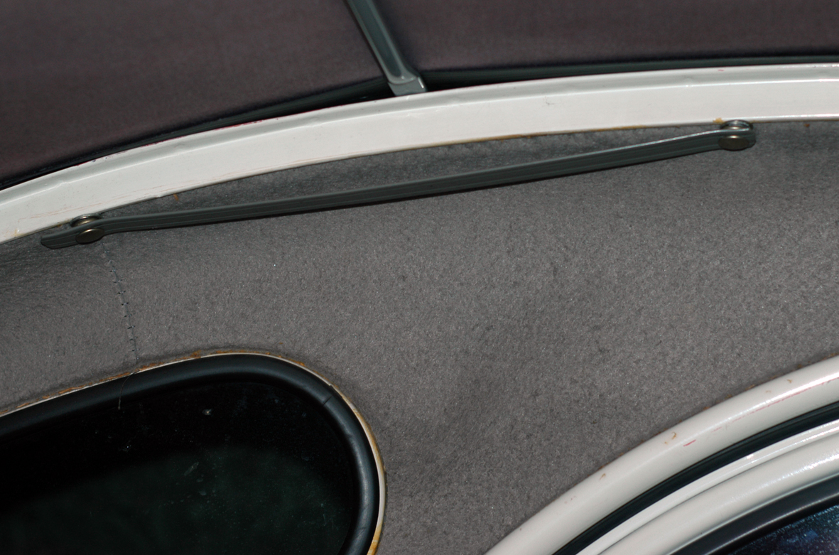

Anyone able to snap a shot of how the straps that secure the roof when it is all the way back look/attach inside the car?

Here you go. These photos are of the left-hand side of the car. The rear press-stud (ie the one on the left in this pic) is above the rear quarter-window.

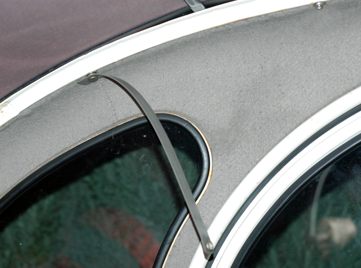

To secure the rolled-back roof with the strap, simply pop the front part of the strap off its stud, like this...
... and then pivot the strap around and loop it through the cross-bar of the roof (the one in your hand in this pic): Image
Finally, press the available end of the strap onto the press-stud on the outside of the vehicle (that's the one just behind the rolled-up roof in your pic).
Voila!

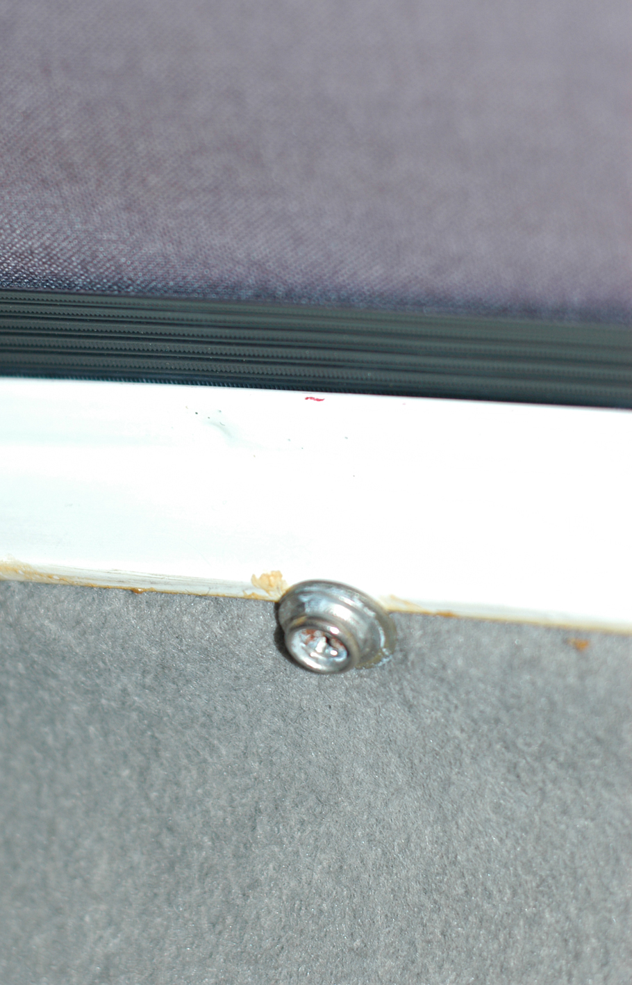

The press-studs are secured to the car body with self-tapping screws.

Thanks so much for the pictures. Seems easy enough to do ourselves. Much appreciated!
