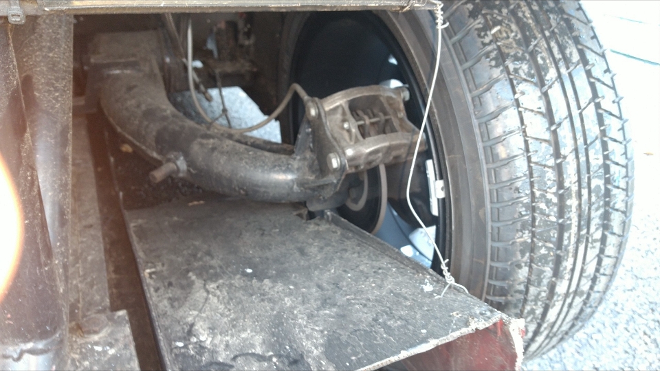

Here you go, its a pain in the ass doing this on my phone.. This evening more..
Gs Bx Xantia C5 all will do..

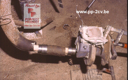

Received this from Belguim :)
