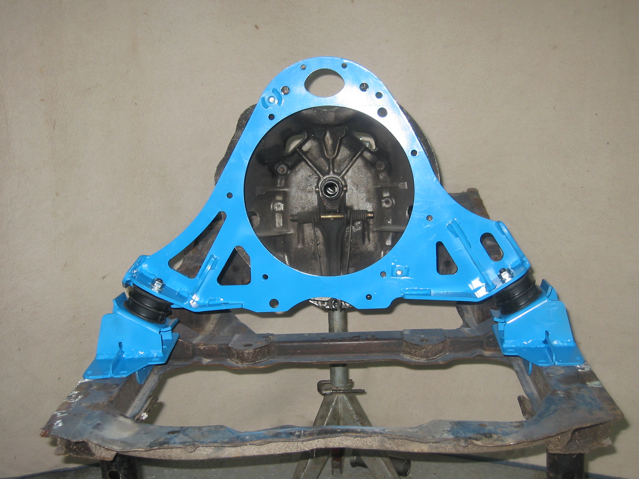

another view

Looks like it could handle 300bhp :D

well the landrover rubber mounts should be good for 150 hp
my mounting should be easy able to take 120 hp from the BMW lump
i removed as much spare metal as i thought wise!
However Version 5 will lose a bit more weight, as i have been able to make the ribs smaller.
Is it not about time you up graded the red monster to the larger engine choice!!
