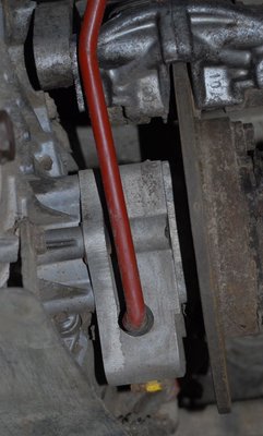

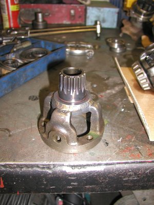

Some pics,
The output shaft is a longer new item,
Deeper new bearing carrier.
Spline welded to diff carrier.
Approx £1000.
This set up is much harder for GS as there is no separate bearing carrier.

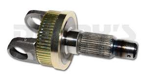

You can mill a sort of toothed pattern in the disk...something like this but into the disk.

and the propshaft (a quick look at the google pictures) seems that my thinking is right!!!
