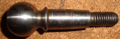

See Pic...
Is the taper a Morse taper?
How can I measure it accurately?

http://en.wikipedia.org/wiki/Morse_taper#Morse
December 25th, 2011, 10:23 pm
Post Re: XMAS Quiz (Technical)
A Morse taper looks to have a shallower slope than what's found on ball joints, which seem to be more in the 6* to almost 10* range with 7.15* being one of the most common.
Guess you'll be adding one of these to your shopping list? ;)

Hi Guys,
Results so far...
1. Took Picture
2. Imported image in to QCAD.
3. Drew lines on edges.
4. Used "Angle between two Lines" to measure angle.
5. Result = 3.56Deg.
6. Not a morse taper (No susprise there)
7. Could a CNC mill be used to measure this ???
December 27th, 2011, 2:06 pm
Peter,
have you taken into account that it's only that part of the pin which fits into the track rod which is tapered, with the majority of the shank having a uniform diameter?
A (very) quick check with a set of calipers suggests that the included angle of the tapered section might be closer to 6*.
Isn't it going to be nigh on impossible to create a hole into which that pin would fit unless the part was built up from discrete sections? :?

Hi Ken,
Realise the shank near the ball is Parallel, the angle was measured with reference to this.
Also I will try with digital caliers and some trig.
My measurements .......small end of the taper is 11.85mm Large end 12.93 Length 12.32mm.
The idea is to use this part with a fabricated steering arm and a slightly modified track-rod end.
Potentially cheaper than a rod end and also uses Citroen parts
But as you suggest, discreet sections make it more complex to construct......................
Peter
