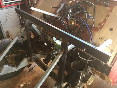

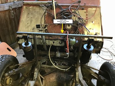

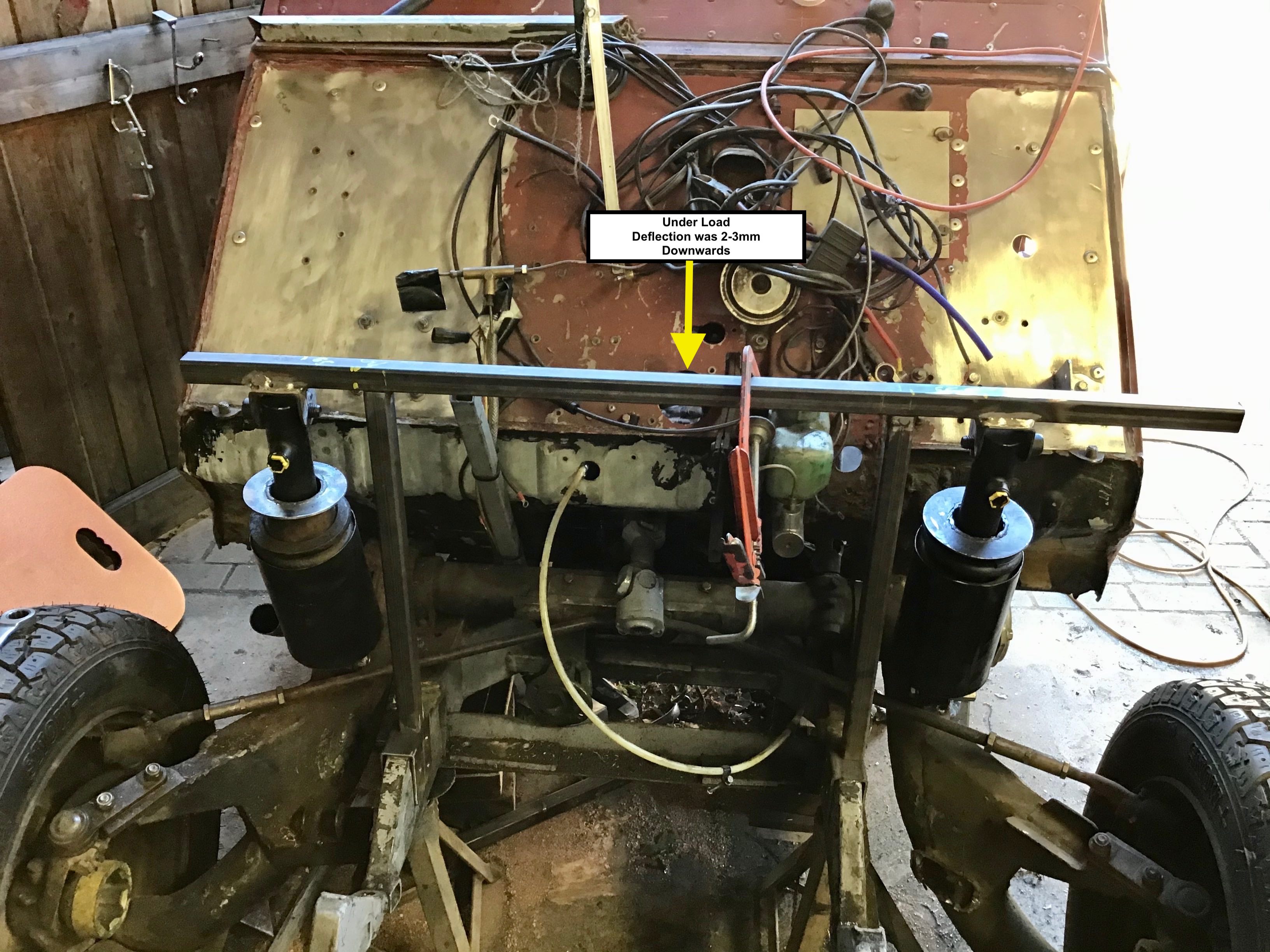

The sub-frame that I fabricated was not upto the job.
The top rail was bending when under full load.
Under examination the strange result is the the rail is now bent Upwards?

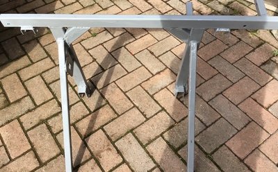

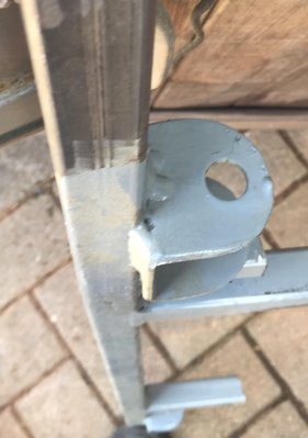

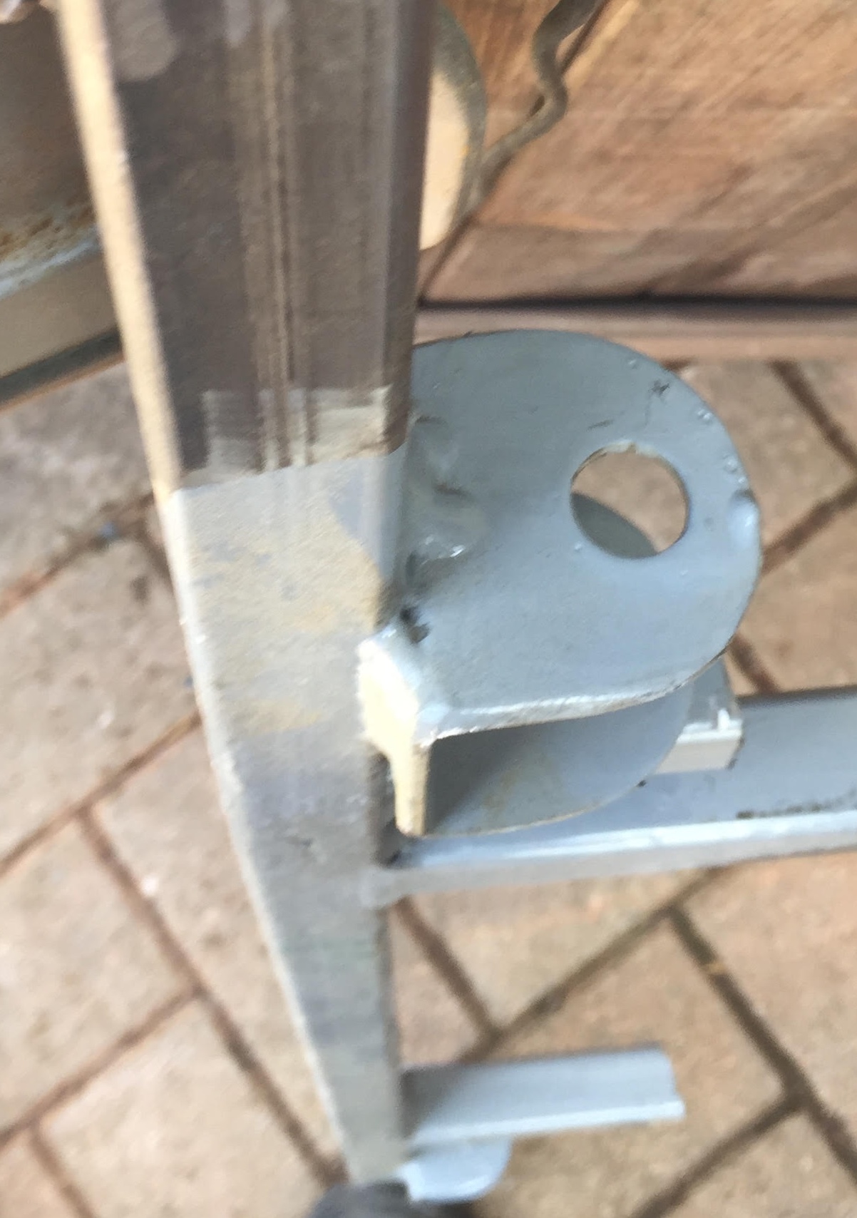

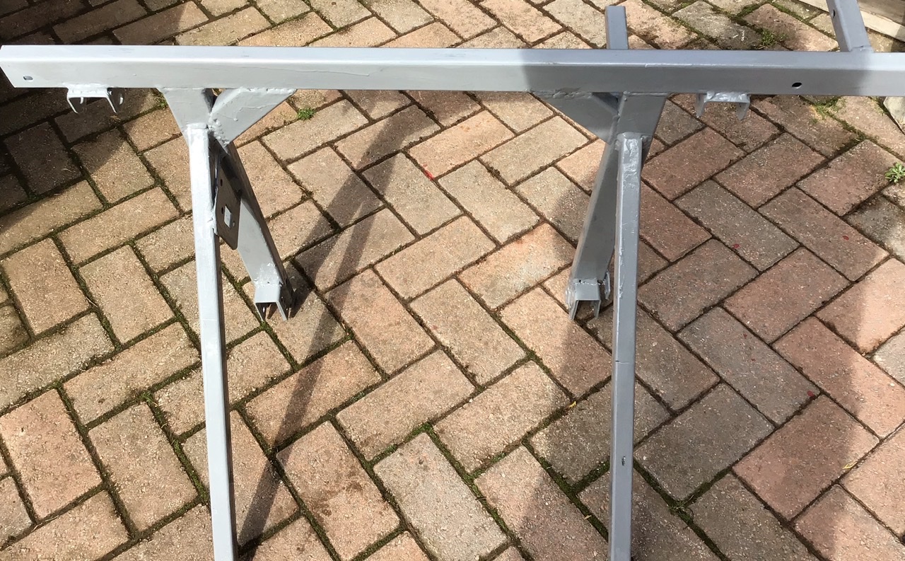

Revised Frame Build...
Steel 50x25x2.5 previous was 25x25x2.5
With a plan to add some corner gussets
August 20th, 2020, 2:24 pm

Finished and Painted sub frame @ 9kgs.

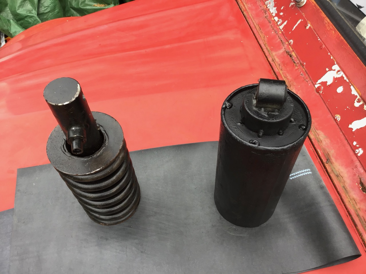

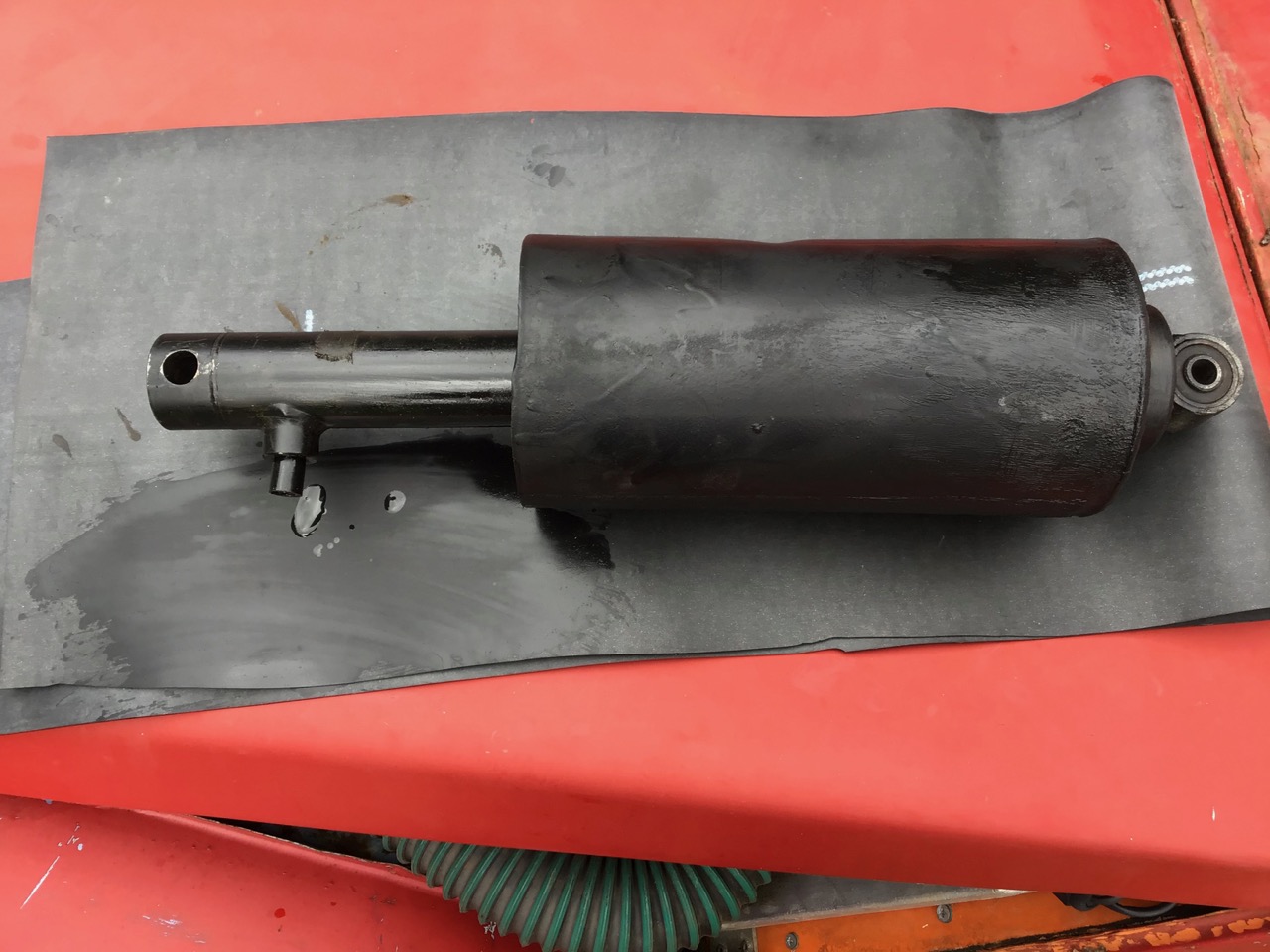

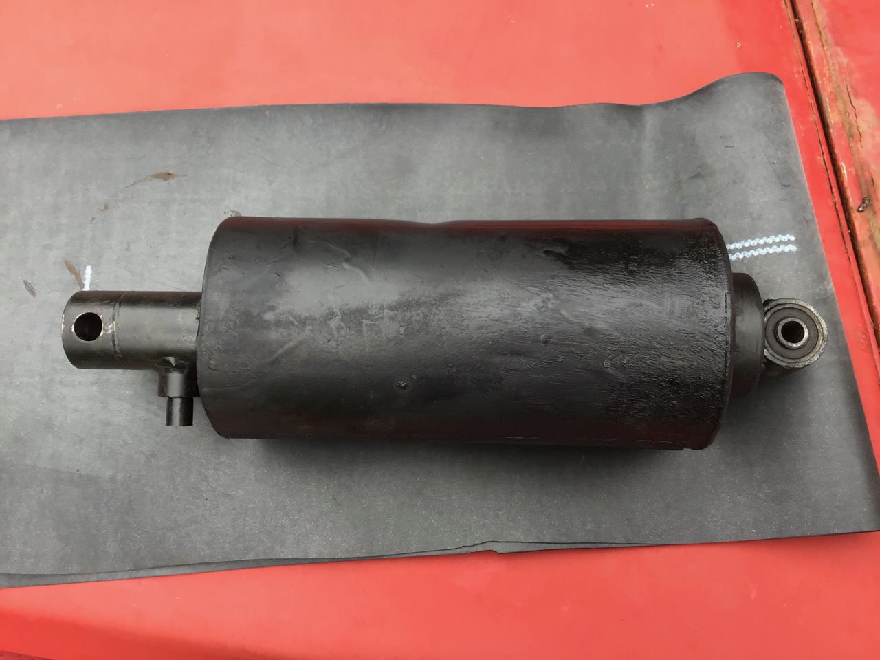

Shorter Struts.
Still need to add a top plate to retain the spring when he suspension droops.
Spring with insert and Spring Cover
Compressed.
Extended.

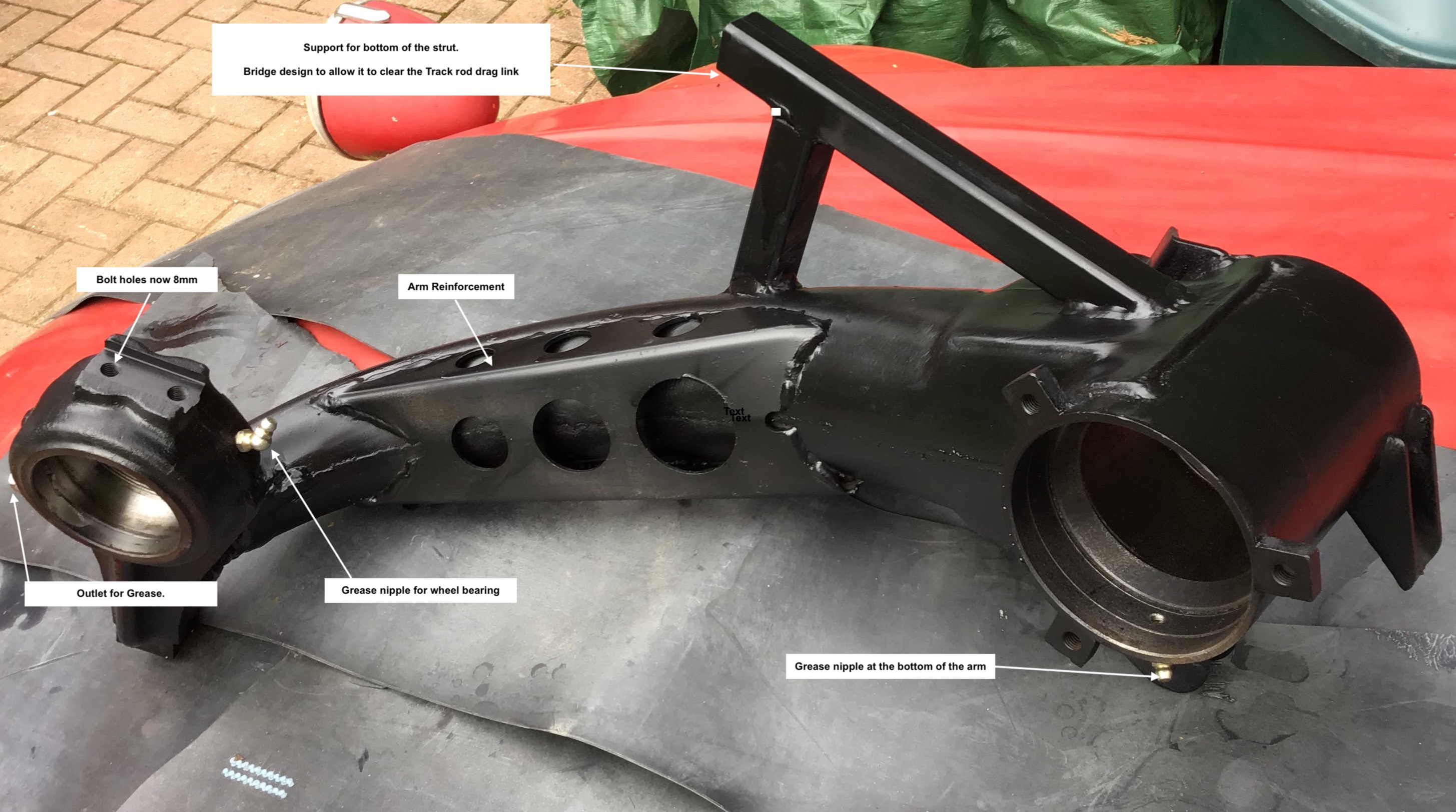

Front Arm almost there...
