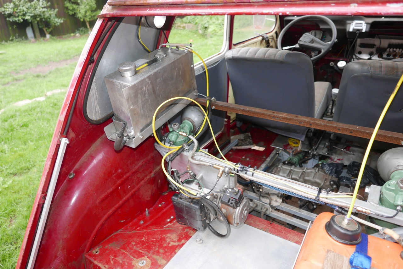

Hydraulics almost complete, waiting for feed hose and some connectors.
More pipes than a JCB:)

Posts: 2303
A DS would be jealous... ;-)

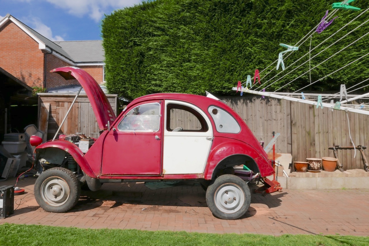

The "Beast" rises again.
Must be the sunny weather :)
