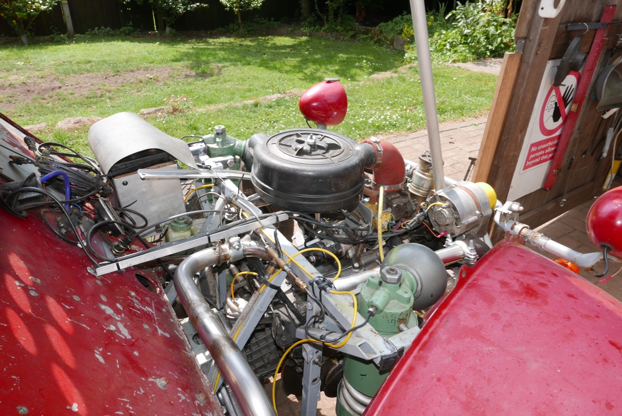

Wiring in the Car.
Wiring under the Bonnet.

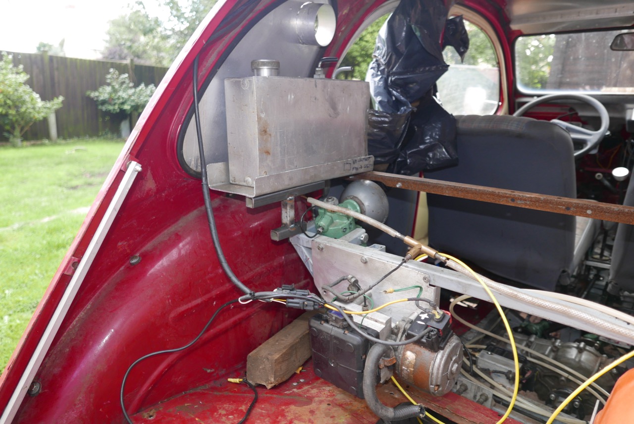

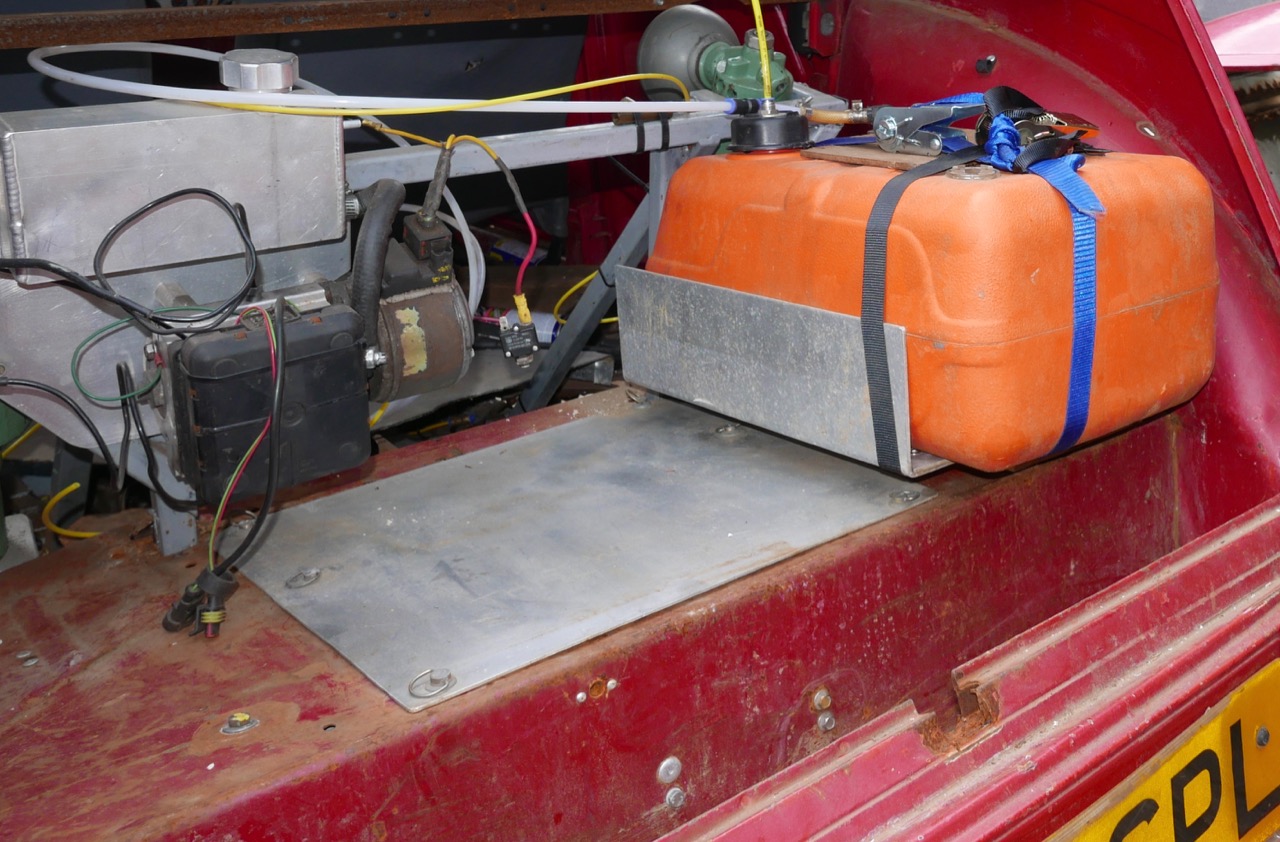

Fuel Tank Fitted.
Base is bolted to the floor and to the inner wing.

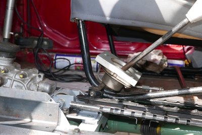

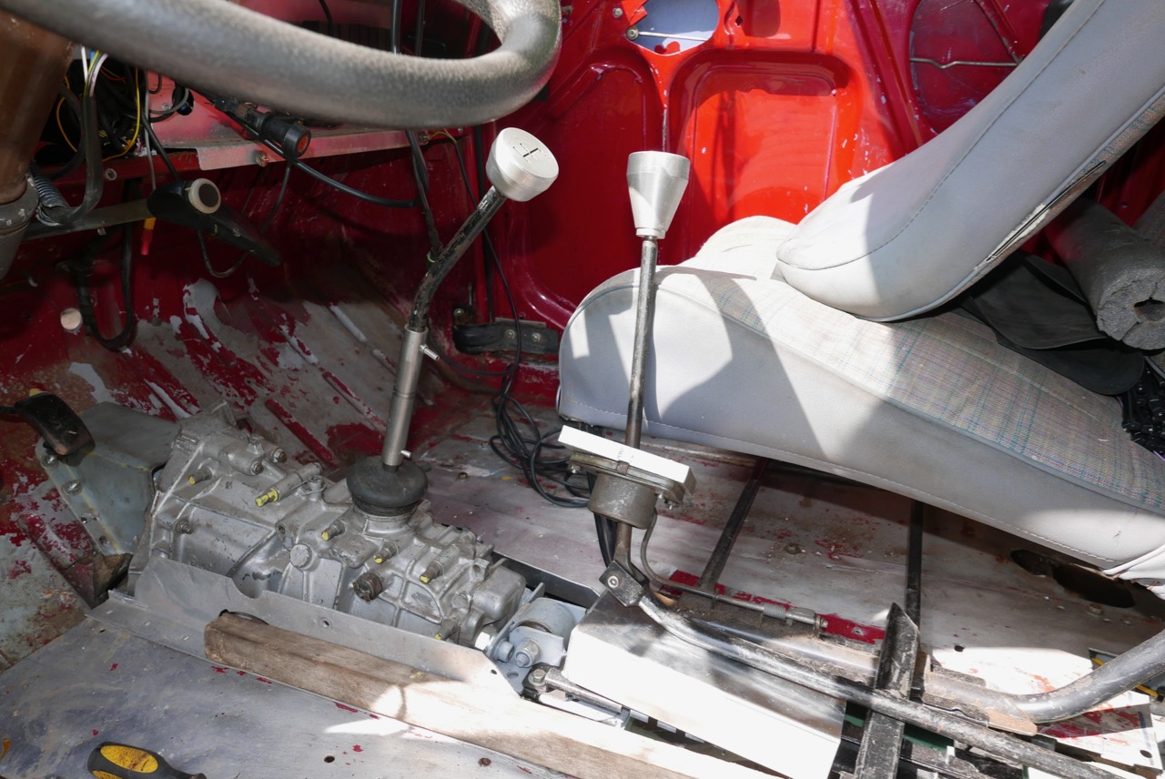

New main gearbox lever and try out for the Transfer box lever, new mount to be fabricated.

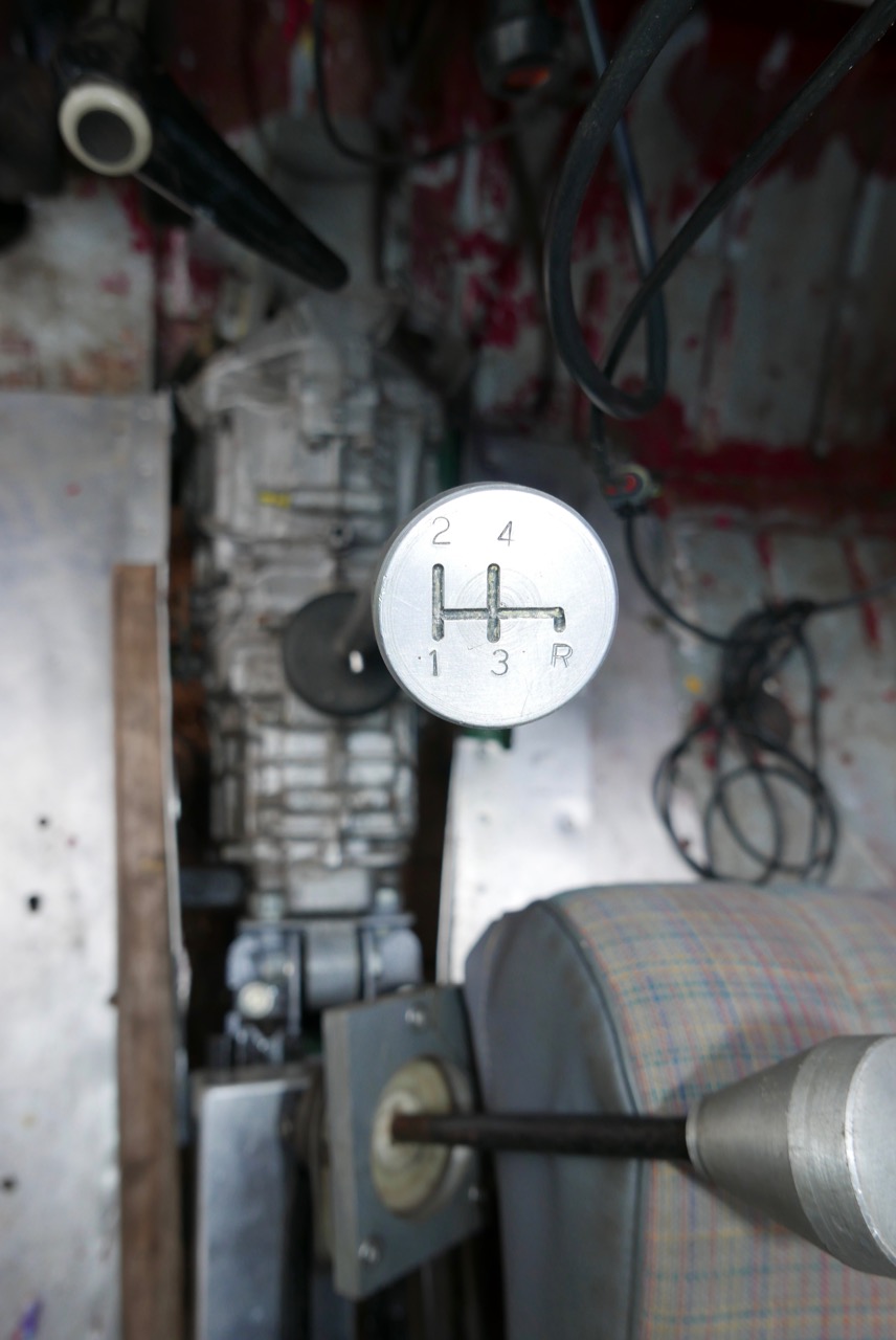

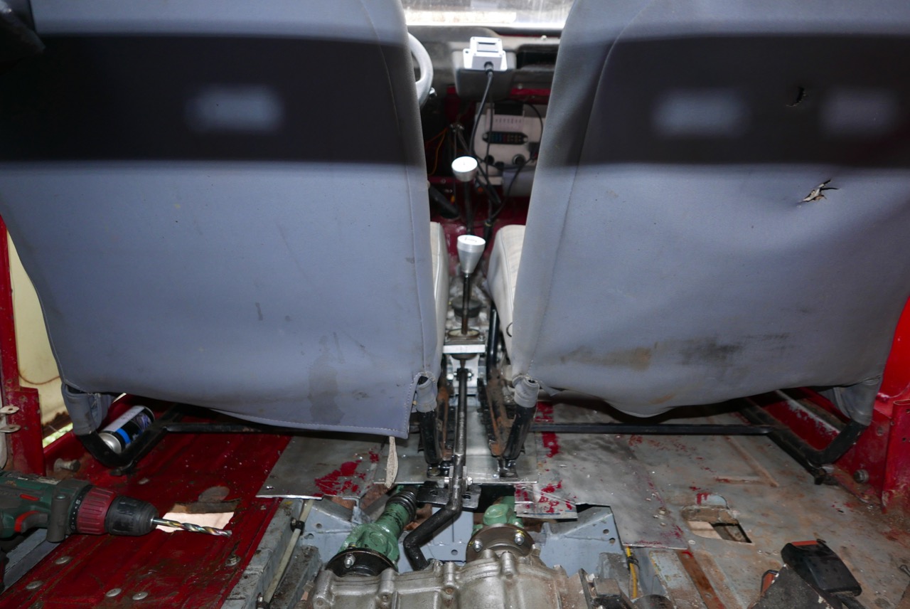

Revised shift pattern

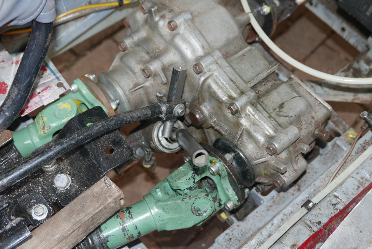

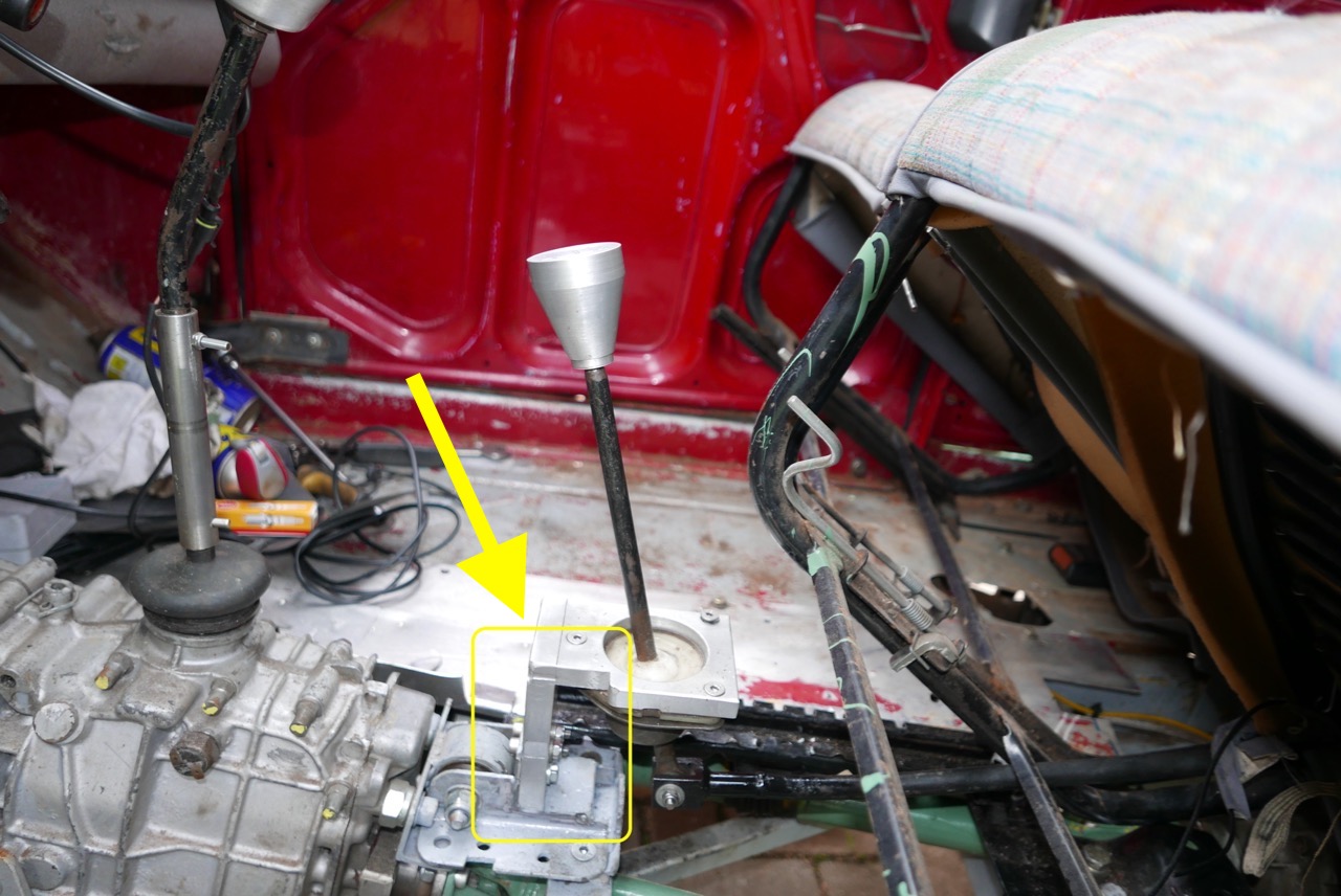

Transfer box end of gear lever.

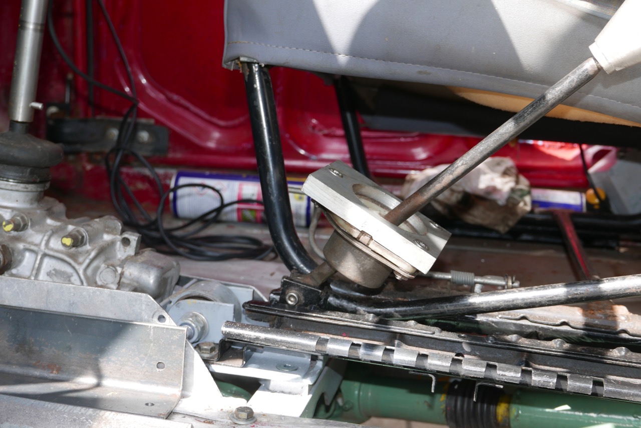

Gear Lever (Scratch Head Moment's)
Transfer box new lever.
Now vertical, needs sanding and paint.
Lever End.
Mount for the lever and linkage that doesn't interfere with the seats or the seat rails

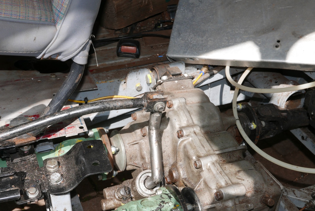

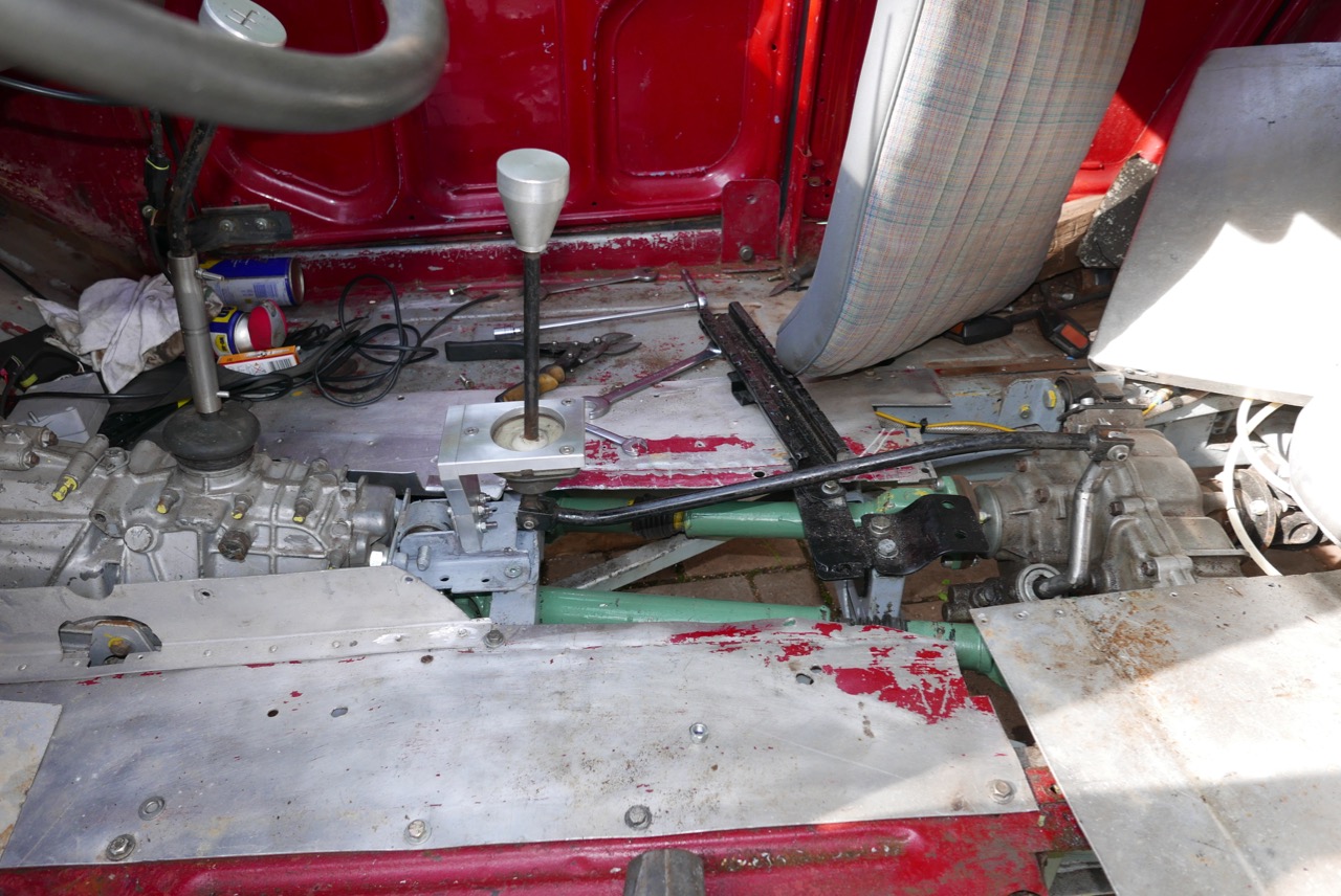

Transfer box Lever.
Mounted to the same bit of chassis as the rear gear box support.
Need the nuts to be recessed as the foul the lever a bit.
Both ends now connected and it allows selection!

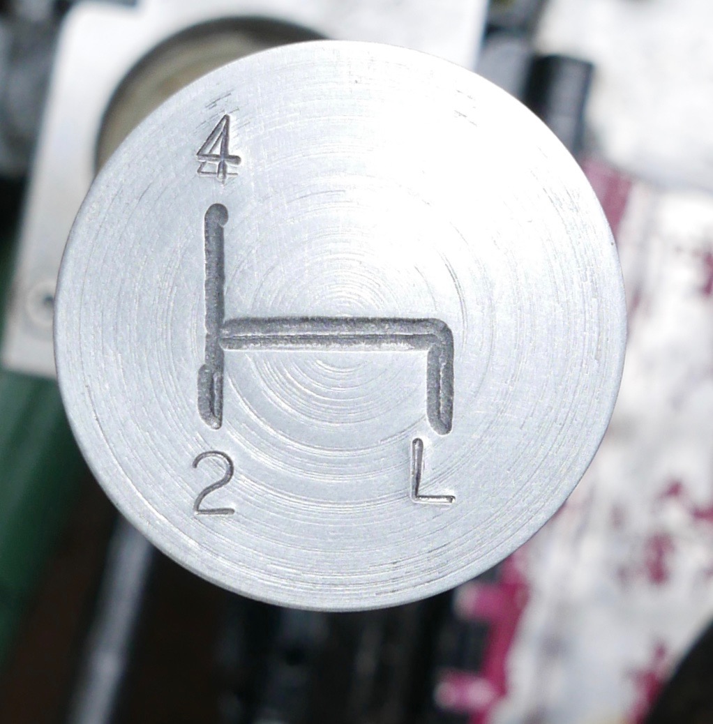

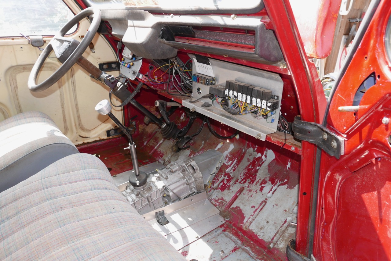

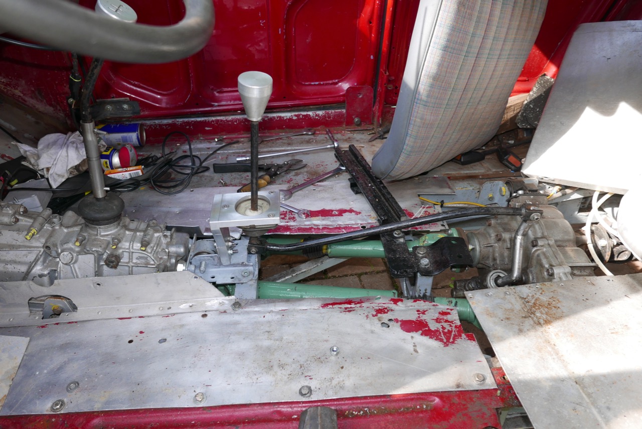

Transfer Box new knob
Revised pattern due to the linkage used,

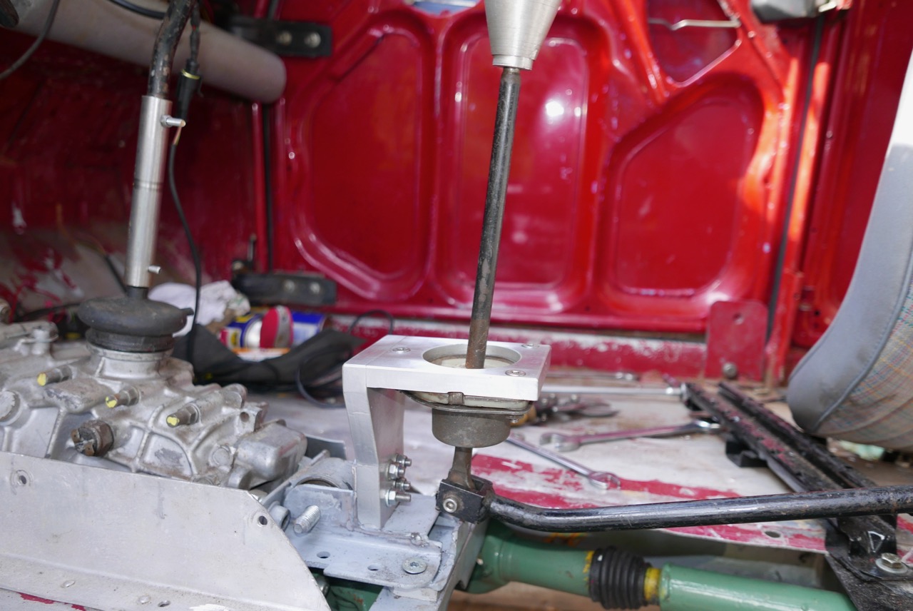

Final Mounting (famous last words)
Slot cut out to clear seat frame.

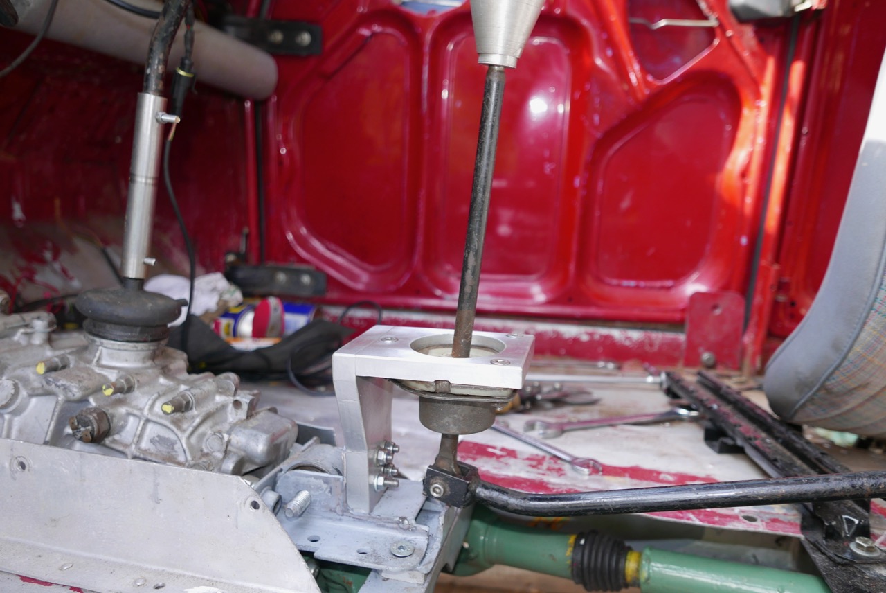

Tight fit for gear lever.

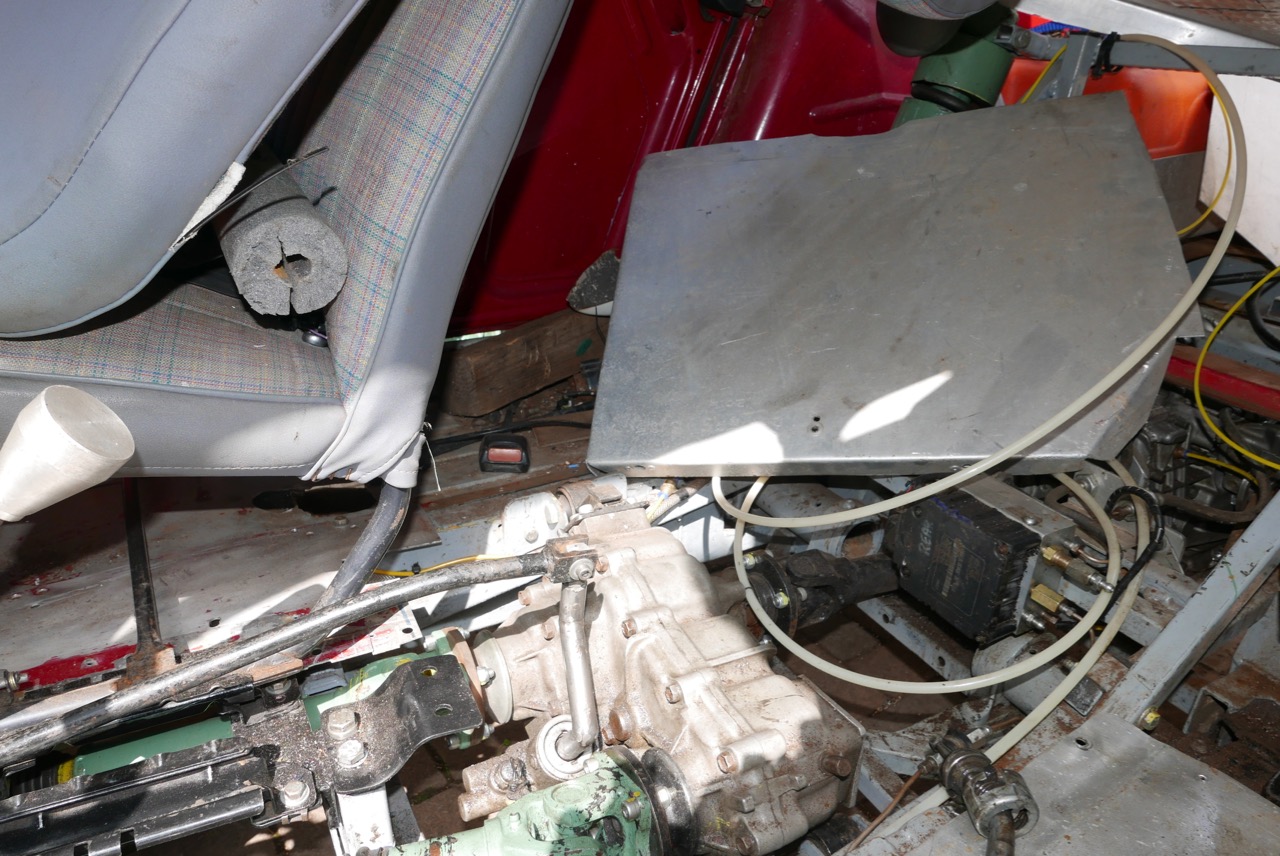

Support for LDS tank.
