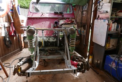

Steering Rack Adjusted and re-fitted.
Attempt at a Containment Guard.

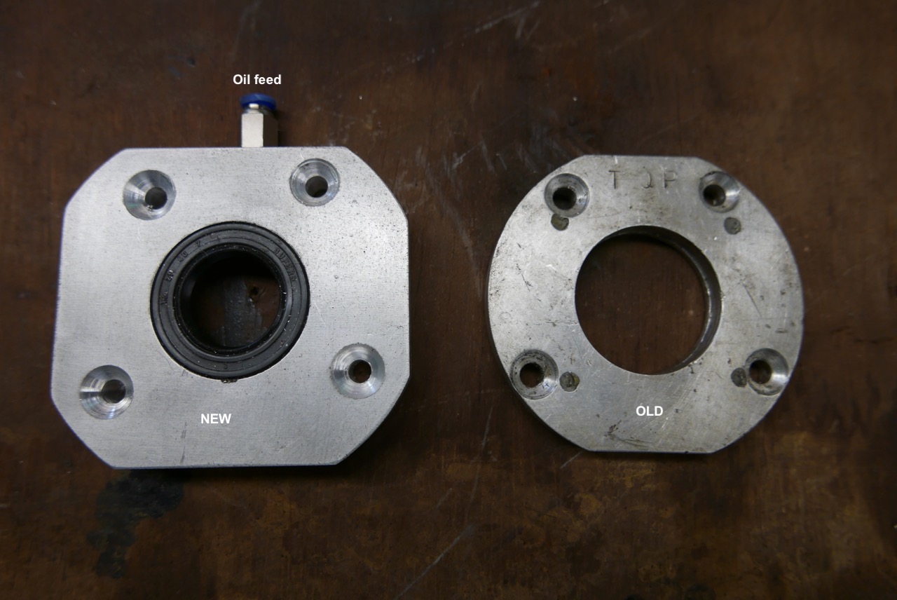

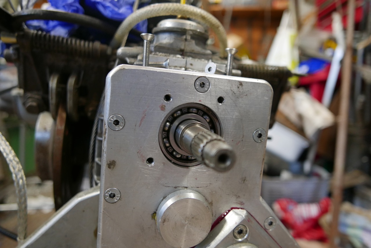

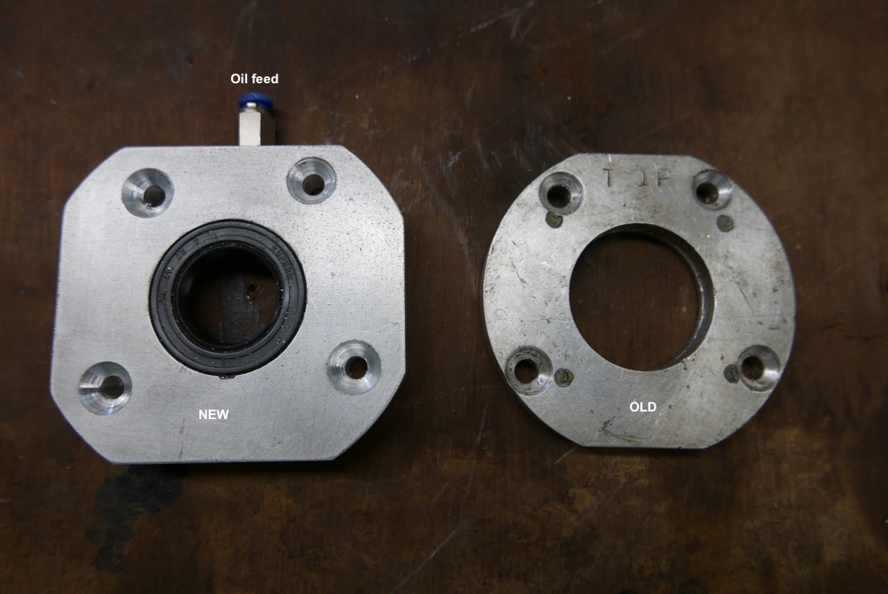

Re-Design aka cock-up.
This bearing only gets oil by splash, hopefully.
Added Oil Feed to rear cover (left hand pic)

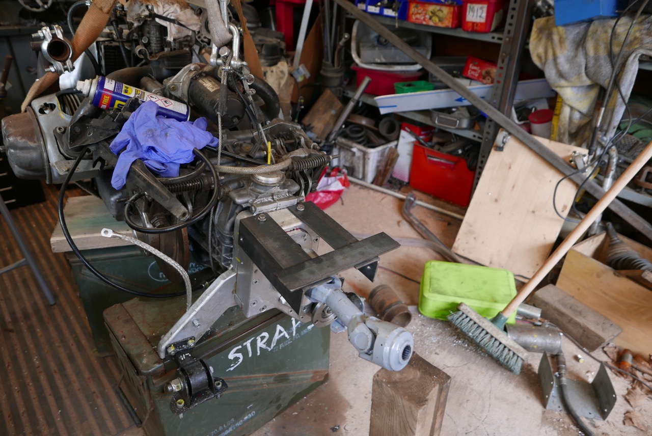

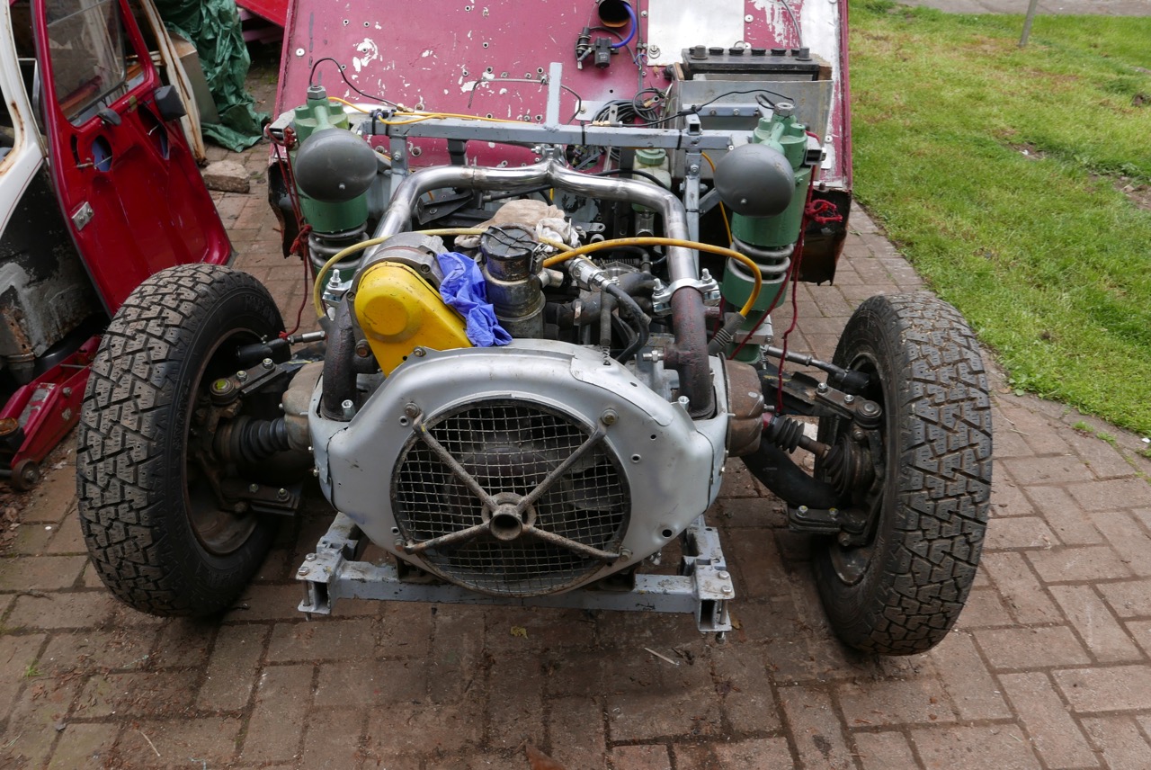

Engine and Gearbox Re-fitted :D :D
Now need to find the Ignition Coil :o

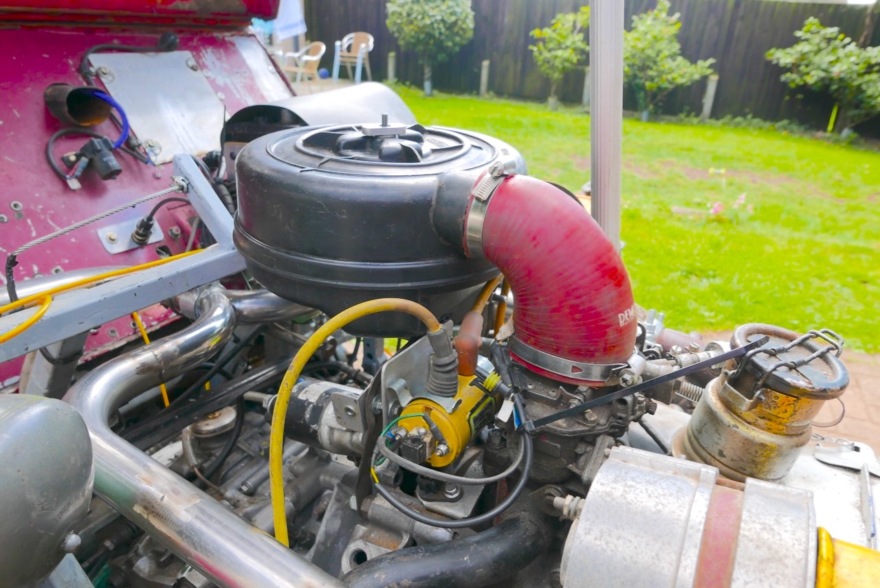

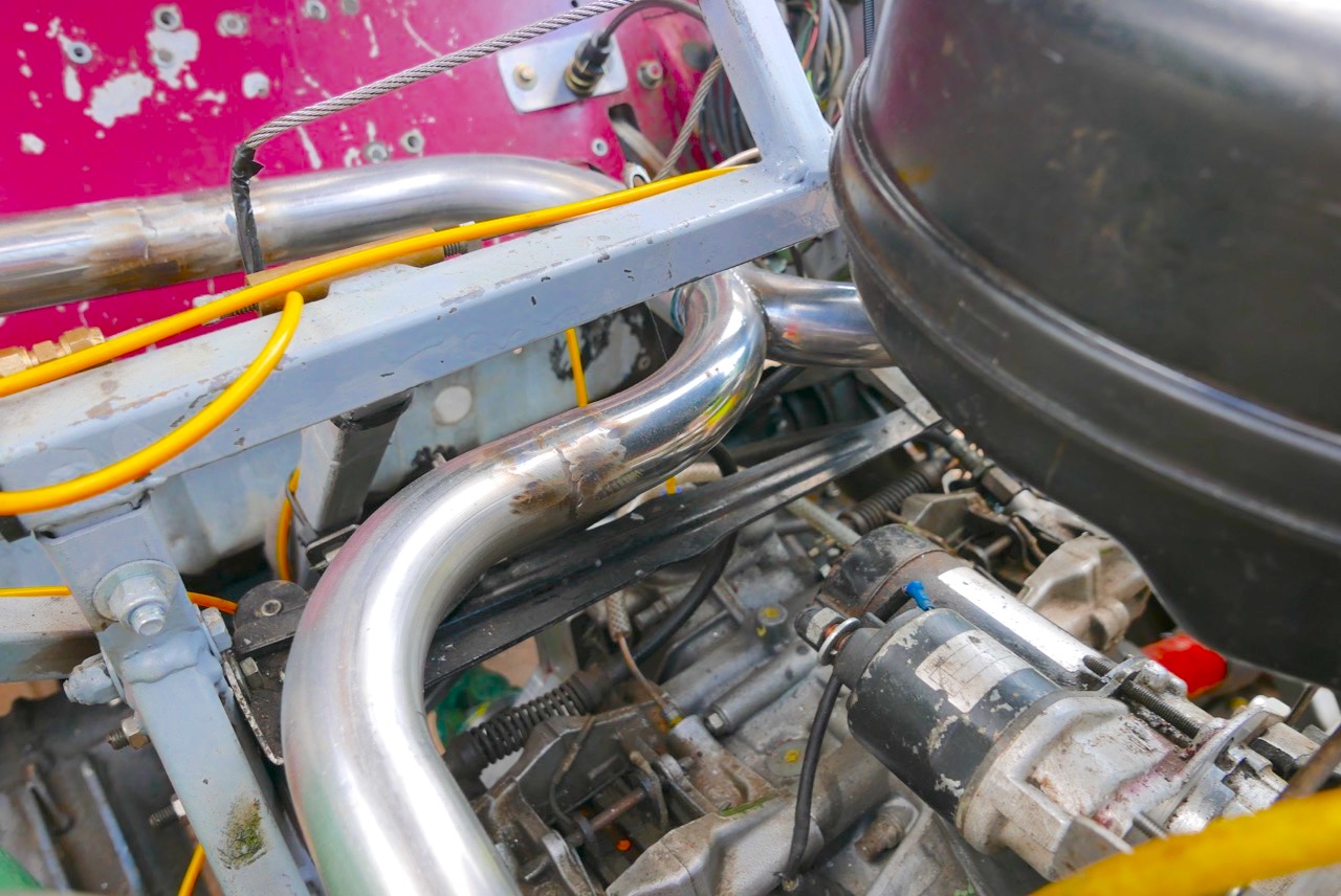

Found the Ignition Coil :D .
Previously mounted the coil on the gearbox, but thats a bit limited for space and possible heat from the exhaust.
Now mounted beneath the standard Air Filter.

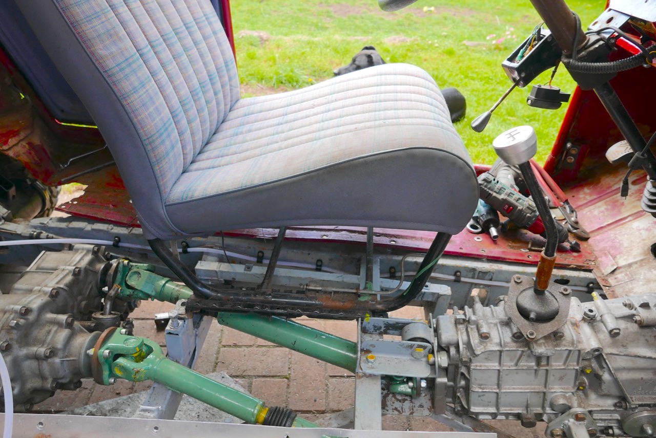

Using Standard 2CV front seats. (Thanks Roger)
Bit of a squeeze to fit the inner runner...

Please take care with the coil right on top of the Rpm sensor of 1-2-Spark. The magnetic field from the coil can interfare with the sensor giving bad rpm reading.. Just be warned..
July 4th, 2019, 7:19 pm
Posts: 2257
Feedback is welcome.
