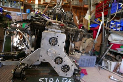

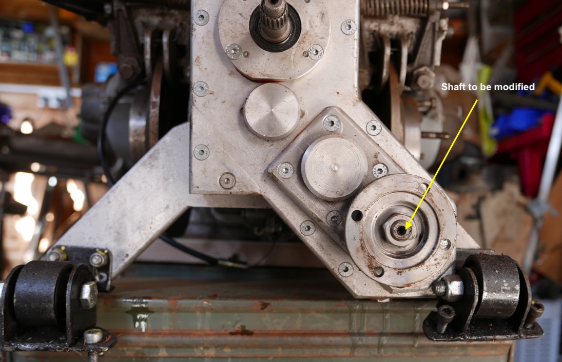

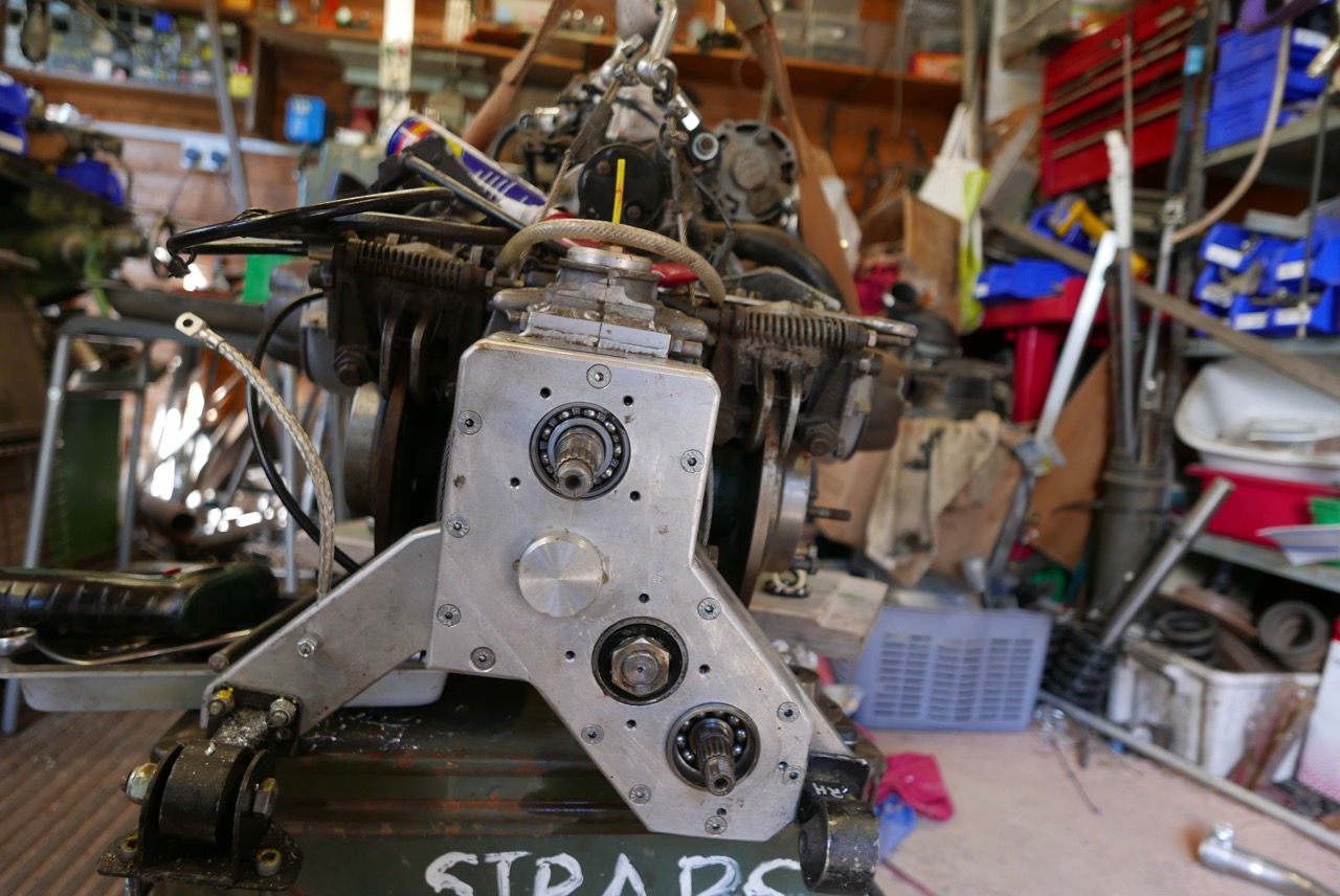

Posts: 2257
Engine together with diff (gearbox) out of the car.
May 14th, 2019, 10:47 am

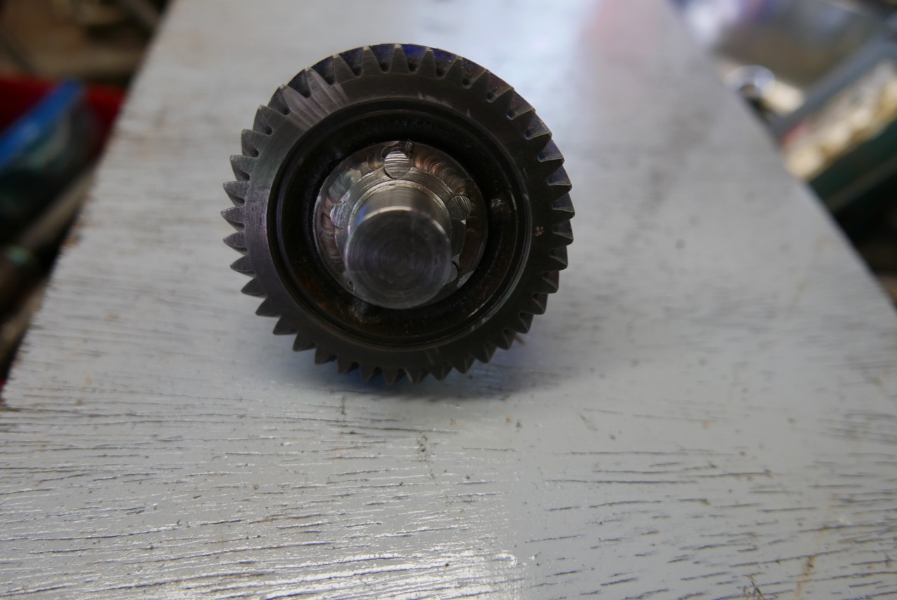

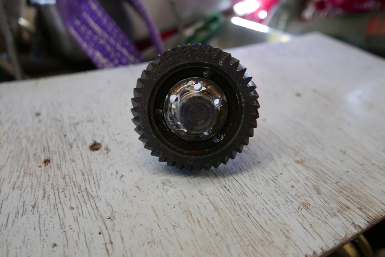

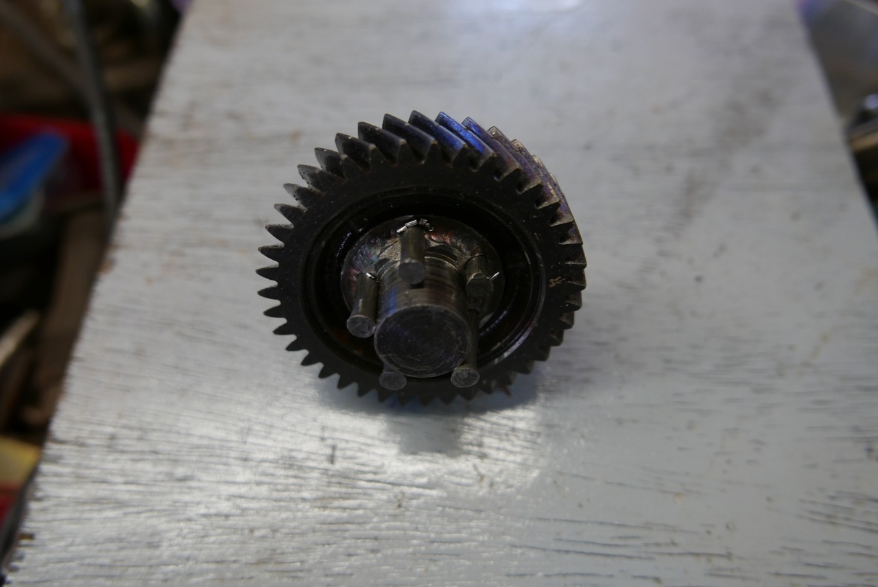

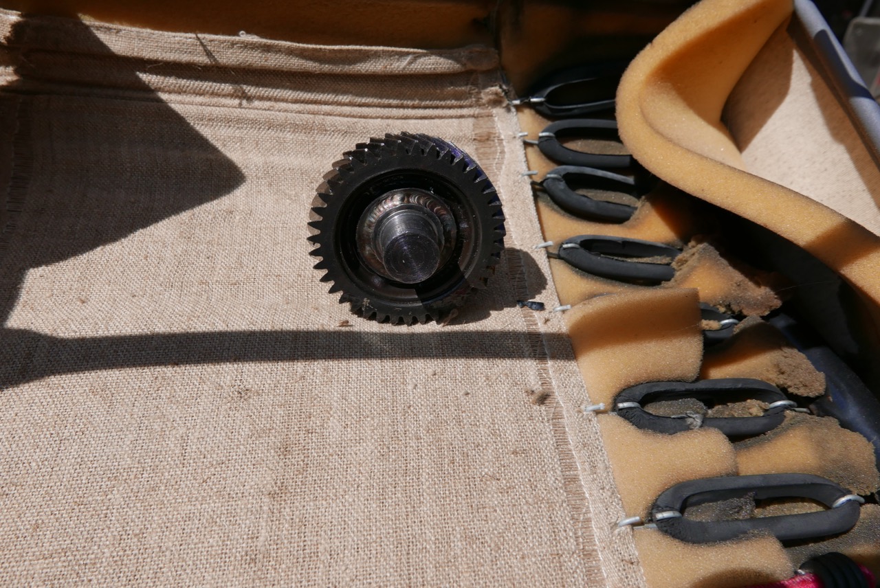

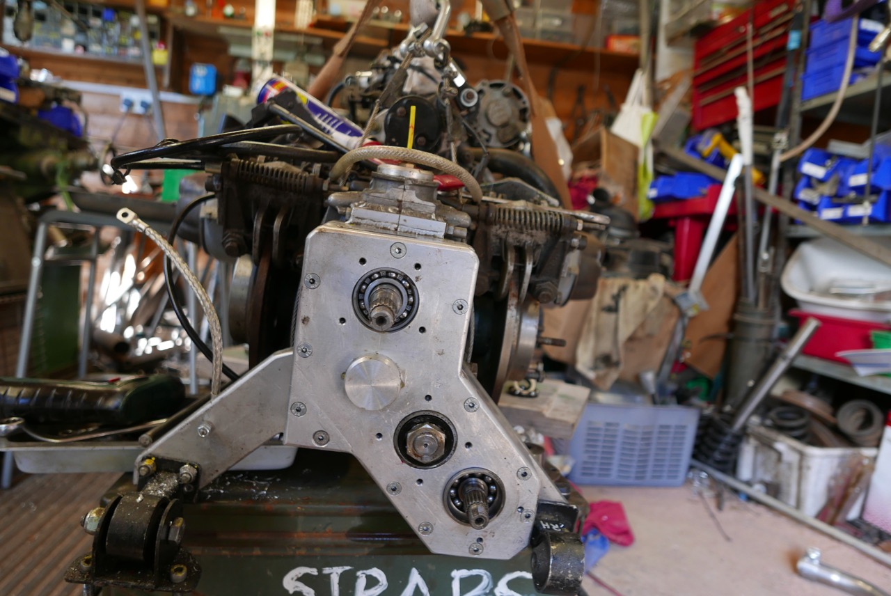

Posts: 2257
Before, During and After.
May 14th, 2019, 4:53 pm

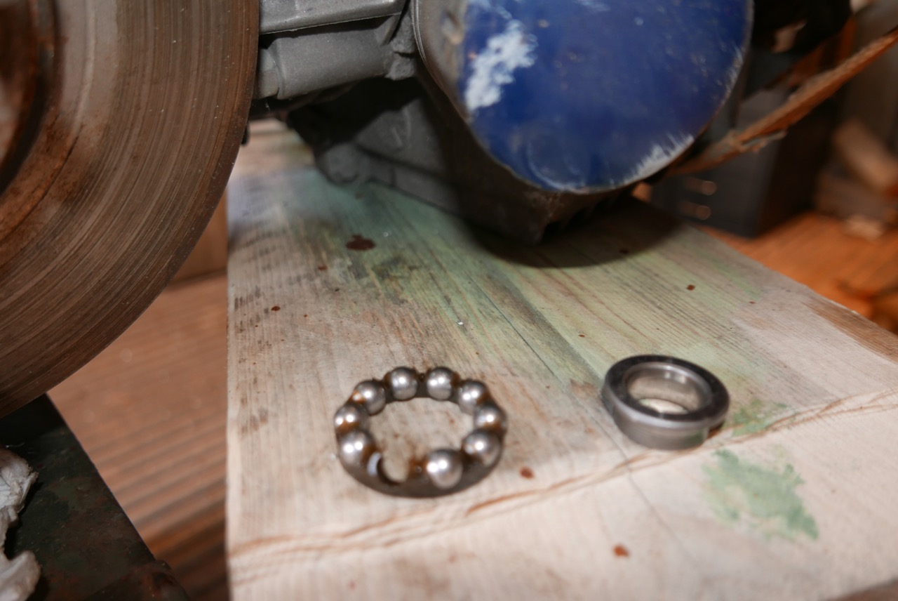

Posts: 2257
Re-assembled the rear cover with Loctite gasket and then saw the bearing, missing one ball bearing!!!
Dismantled it all to check, all the other bearings are OK :D
The last bearing fits from the outside and is held in place by the oil seal cover. :D
Balls up!

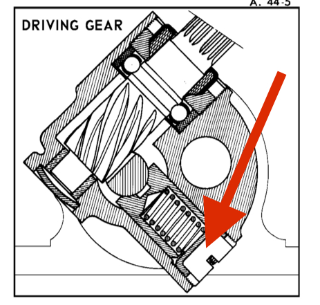

Posts: 2257
Had not tensioned the plunger correctly :(
