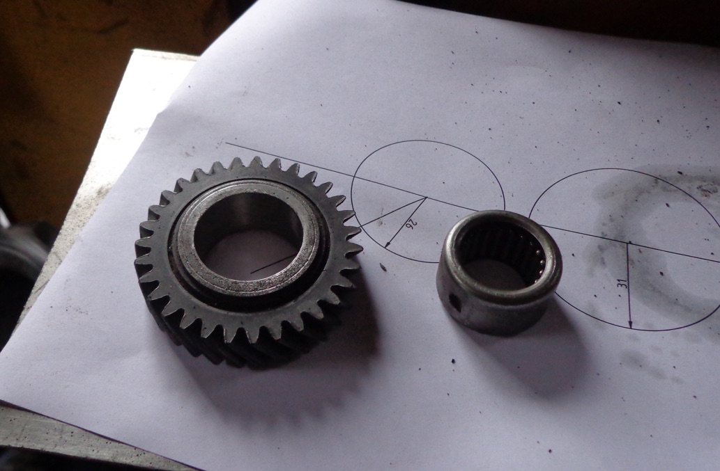

Perhaps a solution, for a compact idler gear.
Select required gear.
Bore out the centre Mill or Lathe (Case Hardened so some sparks at the start)

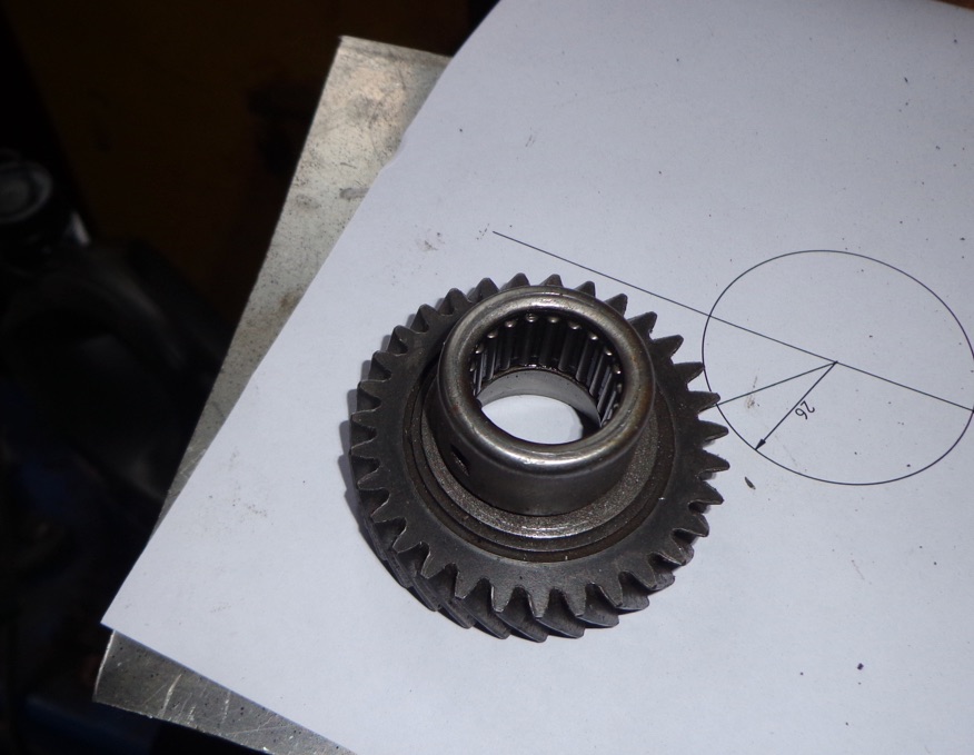

Put in Roller bearing from Layshaft
Make simple shaft to fit inside Bearing thin thrust Washer at both ends, centre bolt to hold shaft
No splines required
This is how Suzuki Jimny do it :D

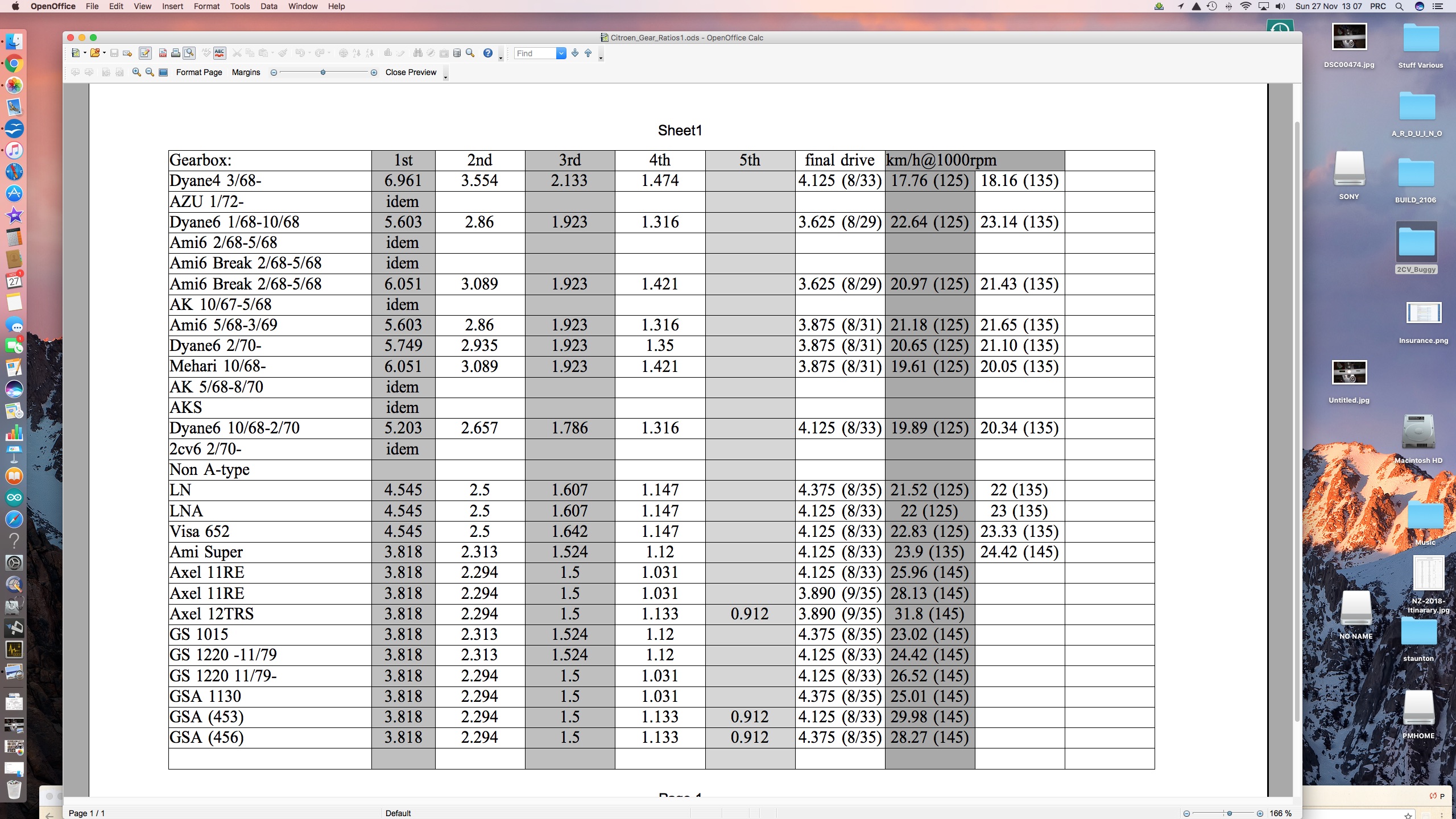

Ratios are MANY, not sure were charts came from???
http://cats-citroen.com/citroen_atypes/ ... arbox.html
Looks very familiar... :roll:
