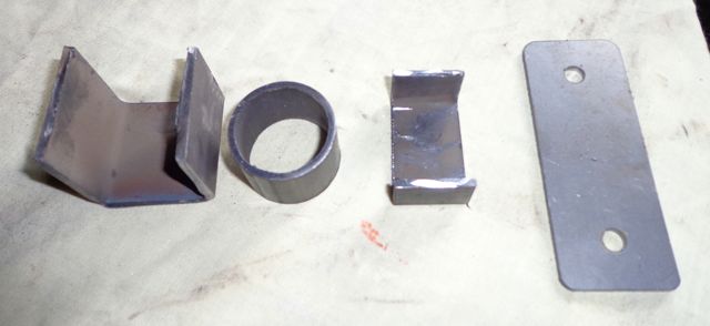

Bit of a Diversion from the 4x4.
Broke three engine mounts in France, they are not designed to take a lot of abuse.

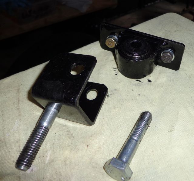

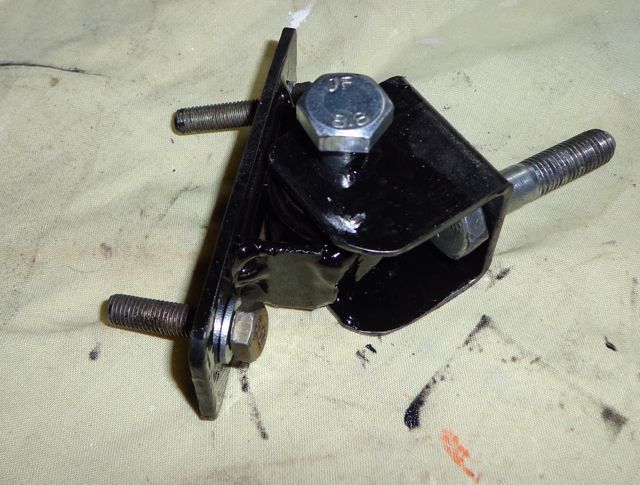

Fabricated a Heavy Duty Version.
Bits, Bush is from Citroen/Peugeot (Thanks to LB)
Will fit in the same way as a standard Mount, but if the bush fails the engine wont move to far.

That looks excellent.
Thoughts of mass producing them or doing a small run?

Hi Mark,
May do.
Havent tried on the road yet, suspect there will be more engine noise/vibration.
The standard mounts provide good isolation/cushioning.

That looks good and strong Pete, out of interest do you know exactly where the bush is from and what size it is? I'm just wondering how it compares with the transit shock bushes I've been using which are for a 12mm bolt and 45mm OD.
