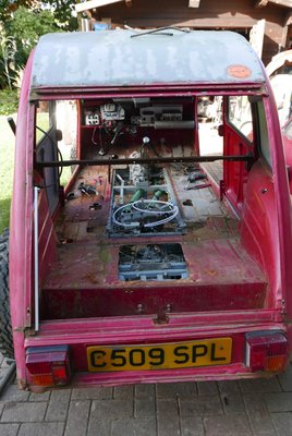

Looking more like a 2CV
However after many precision measurements, the 7mm bolts for the body floor are out by 10MM!!!!

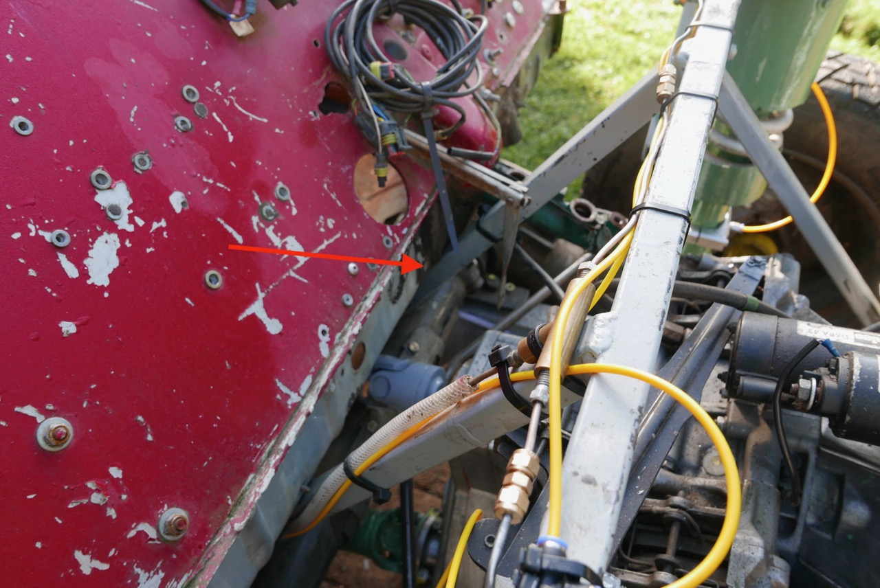

Reason is support strut is hard up against the bulk head.

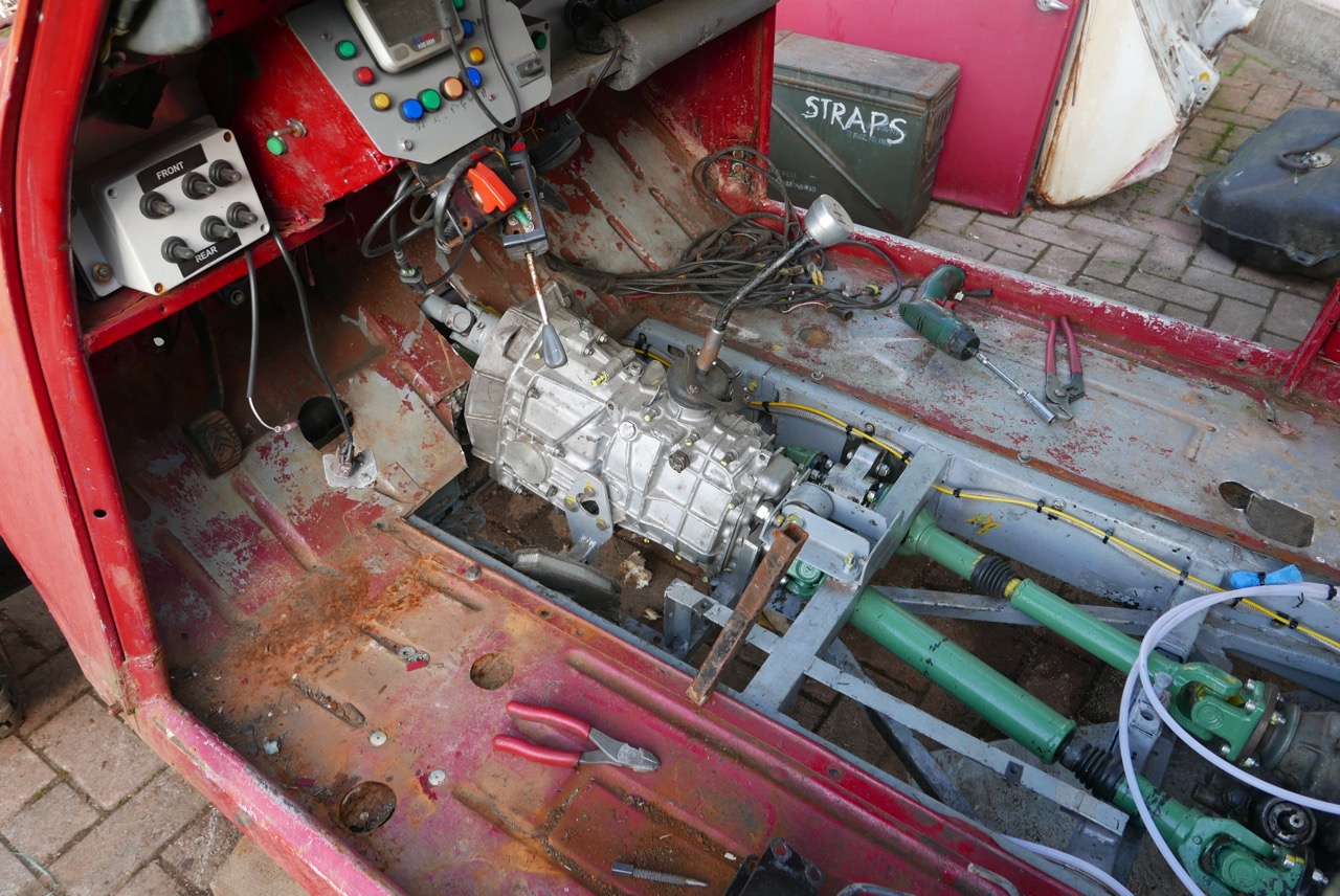

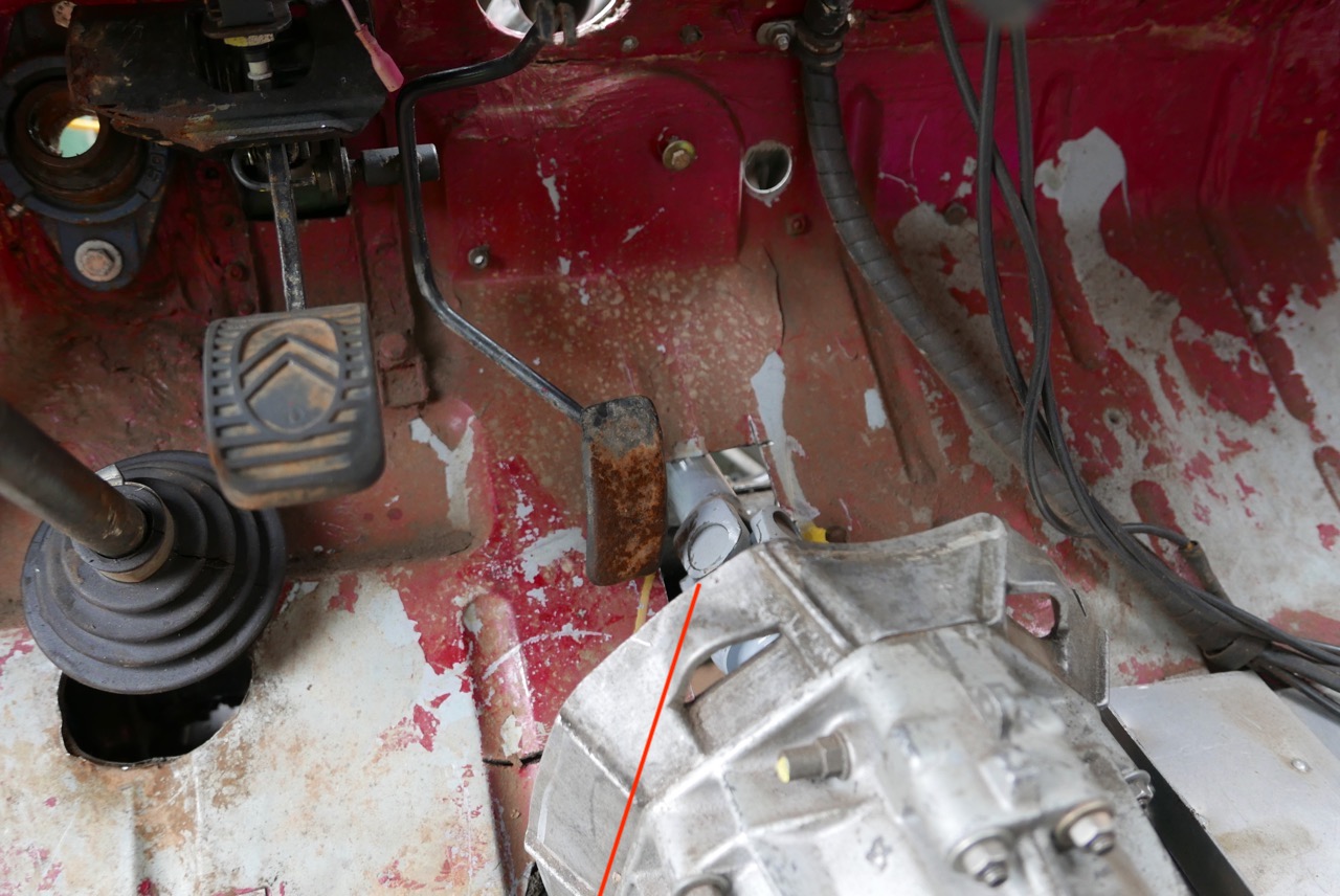

Bit of a problem re Accelerator Pedal (COCK-UP)
May be able to Crank them enough to the left???
October 2nd, 2018, 11:55 am
Make a RHD out of it.. It will solve your problem..
October 2nd, 2018, 12:19 pm
How about and accelerator on the steering wheel, or is that not advisable for off road?
October 2nd, 2018, 1:21 pm
Did have thoughts about that but my old brain would need to retrain.
The shell was RHD and I changed it!.
Bit of progress , welded/modded the brake pedal, offset is now 30mm.
The gas pedal I can maybe able to bend?
October 2nd, 2018, 2:13 pm
Posts: 508
Location: Korpilahti, Finland
Yes. Also brake pedal can be bent, as I did on my 4x4 Dyane, needed some cleaeance to my foot, so it was possible to use accelerator without hitting brakes simultaneously...

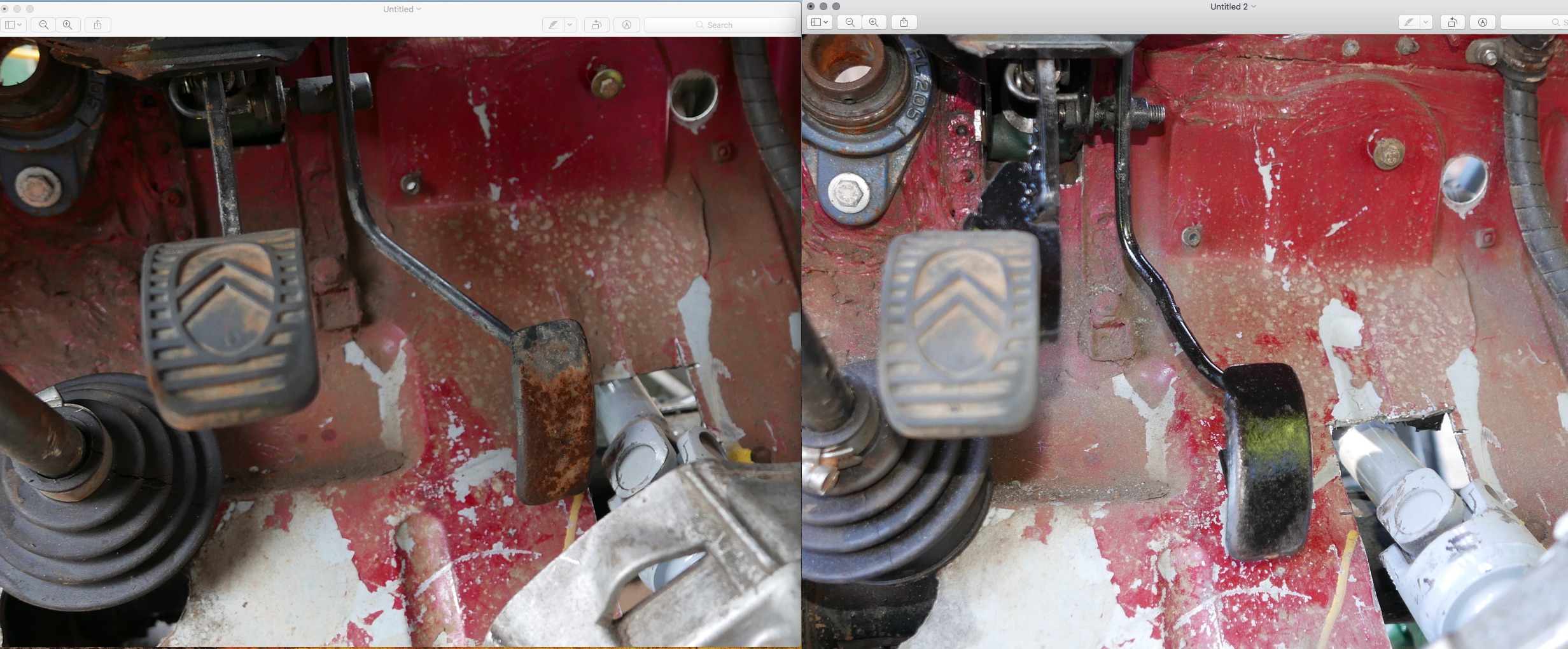

Before and After.
Need to make a Tunnel for the prop-shaft, that will take up some space but it should work.
October 3rd, 2018, 4:46 pm
Posts: 816
subarupete wrote:
Before and After.
Don't worry about a propshaft tunnel, just keep your shoelaces tied up! Nothing wrong with having a car which might eat you alive, it just keeps you on your game, thats why we love 2cv's right!? 8-)
