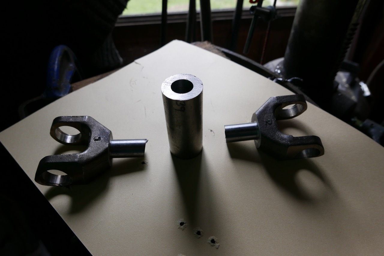

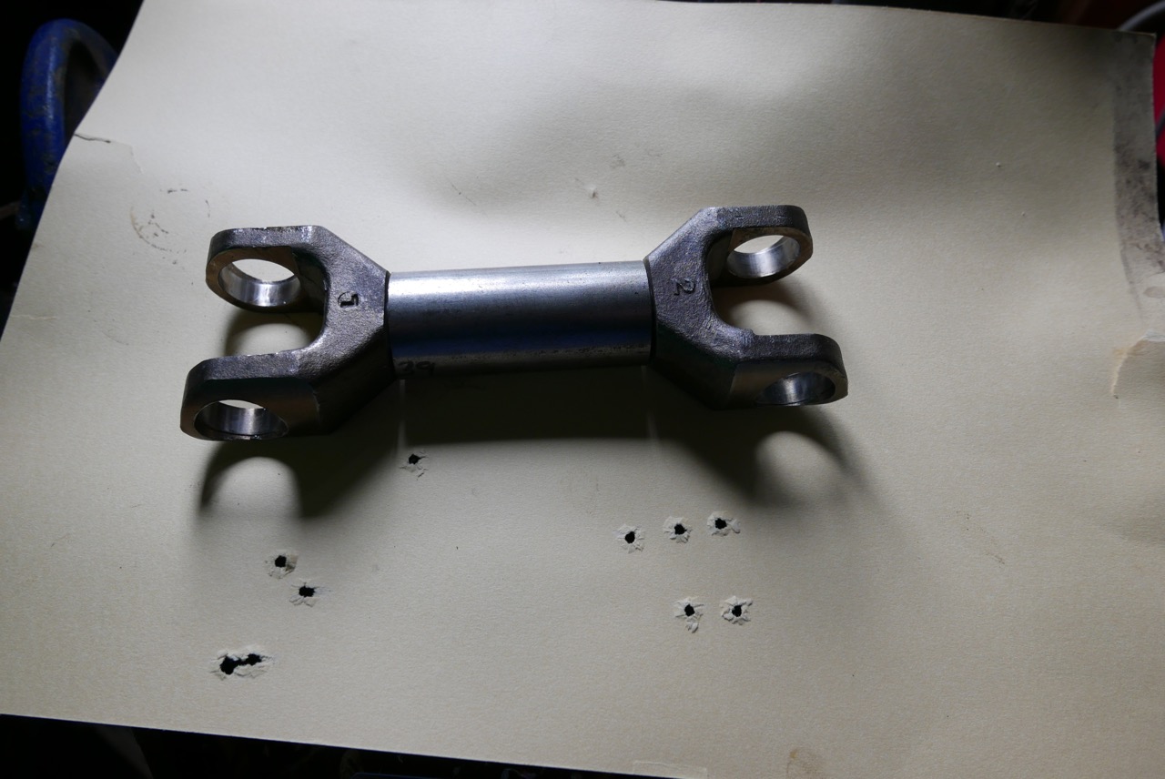

Small bit of turning done.
August 15th, 2018, 2:11 pm
Now comes the difficult part.. Welding it strait together..
So far looking good..

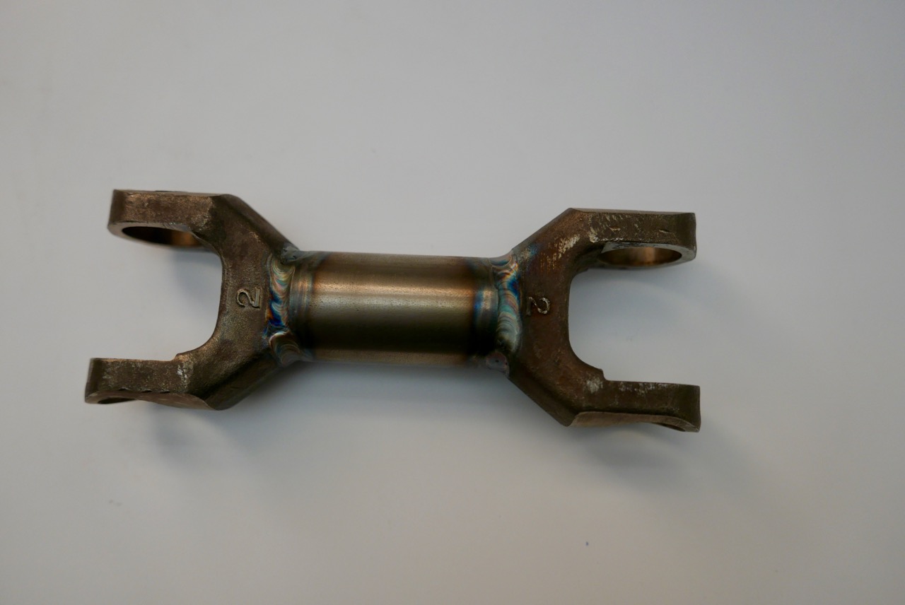

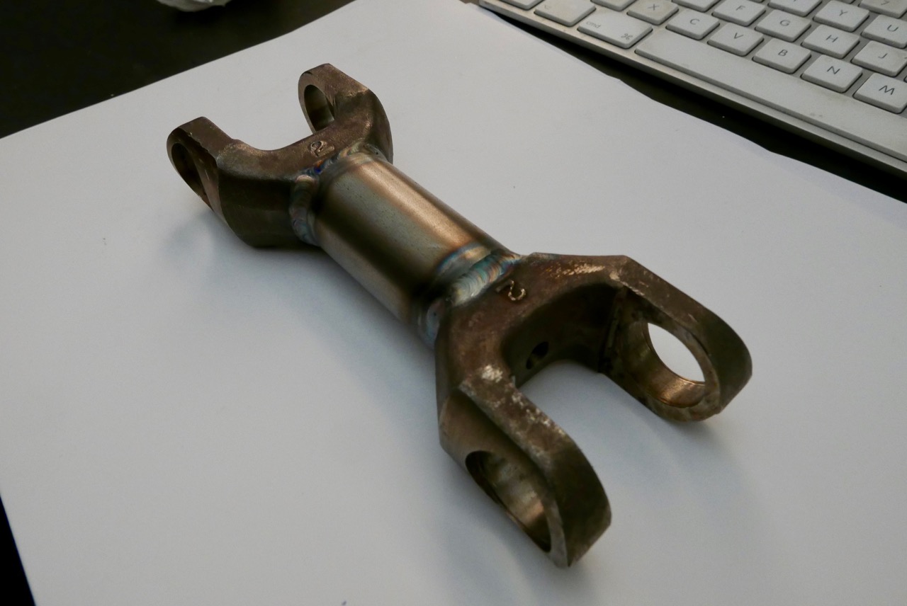

Tig Welded, very tidy and straight.
August 31st, 2018, 11:11 am
subarupete wrote:
Tig Welded and straight.
Rpm don,t forgive, only high rpm will tell if it is straight..

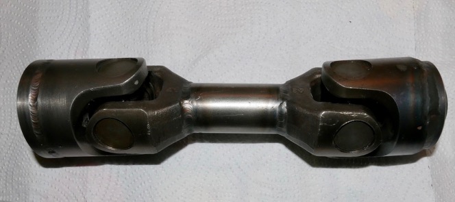

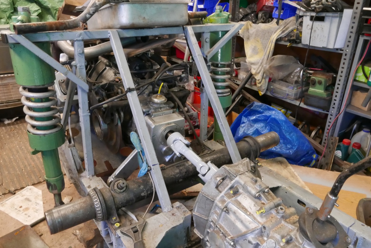

Now with the UJ's fitted.
September 1st, 2018, 12:51 pm
Online
Posts: 2257

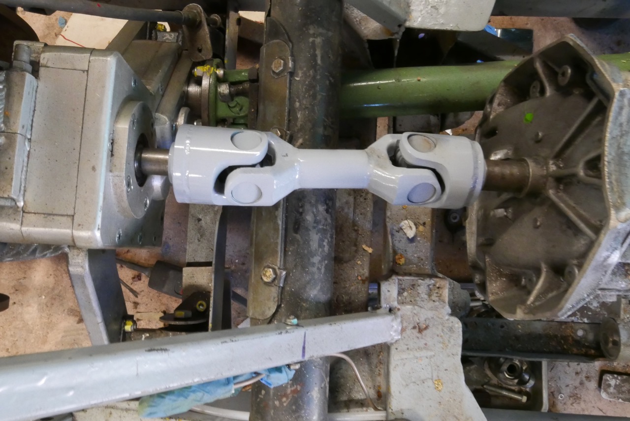

Painted and fitted in place.
Connects between Main/Clutch shaft and input shaft of the remote gearbox.
September 1st, 2018, 4:42 pm
Posts: 900
Location: Rhayader Mid Wales
That lump of metal that the adjustable spanner is sitting on, what's that for? :) .
September 1st, 2018, 6:47 pm
Online
Posts: 2257
An over-weight chassis?
September 1st, 2018, 6:57 pm
Posts: 900
:lol:
surely not ;) .
