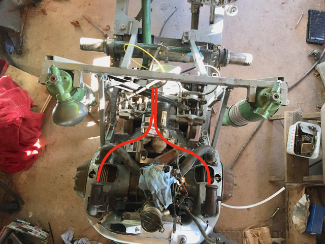

However it seems that the plan to use a standard exhaust with cross-box wont fit:(
Bigger calipers + the rear plate of the diff gets in the way.
Plan to fabricate an exhaust from mandrel bends...2 into 1 very sporty?
Red lines show the plan, but as we are all very aware "Red Lines" can change or even disappear!!!

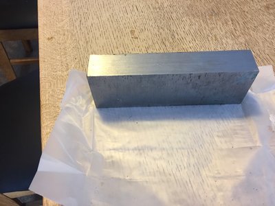

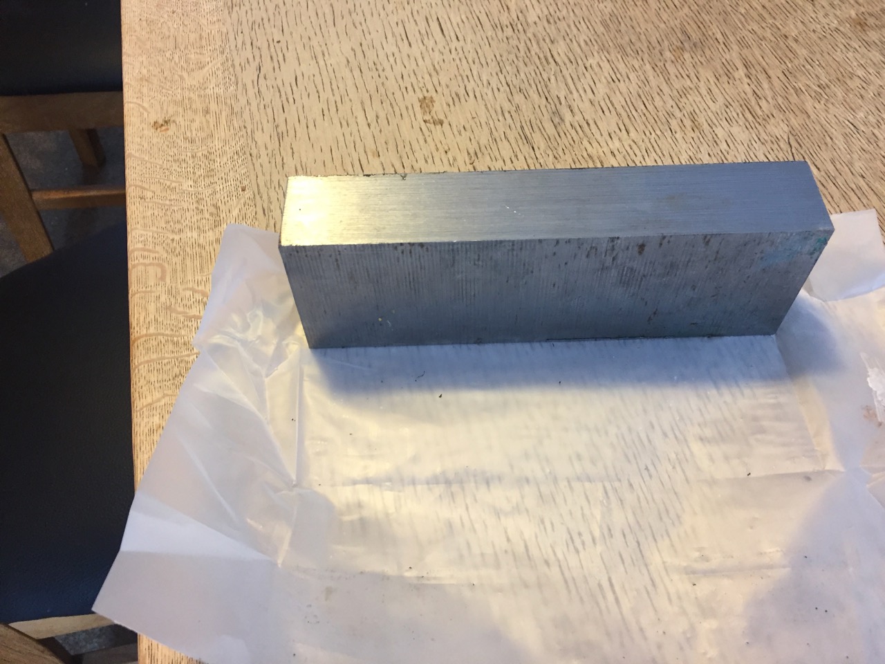

So have to machine one!!
Purchased a bit of steel..
Some difficult milling/turning/drilling and lot of Google.
Bit of a challenge but nothing ventured.....

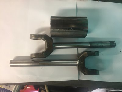

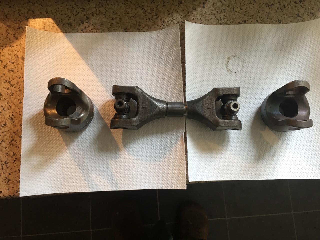

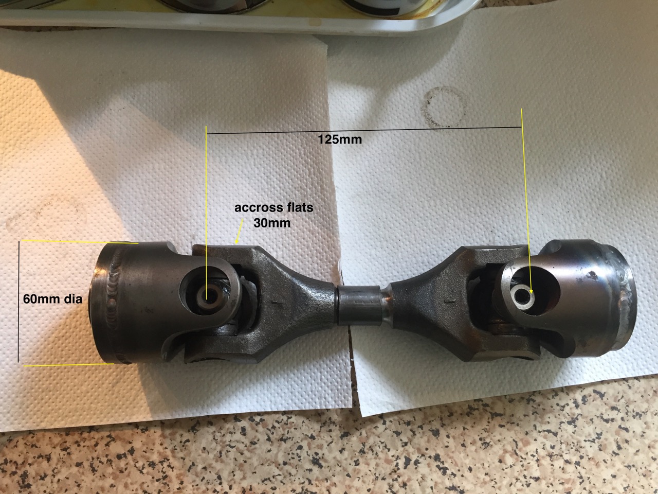

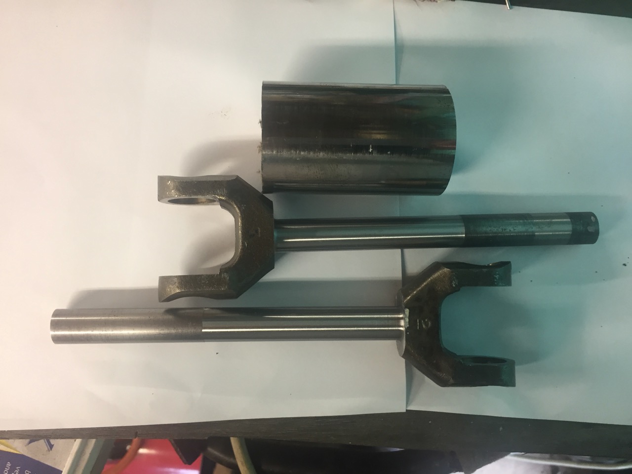

Hi all,
Back again after a long period of no work on the off-road car or the road car.
Turning & Milling required to join the two uj's to make the shaft between the clutch shaft and the remote gearbox.
