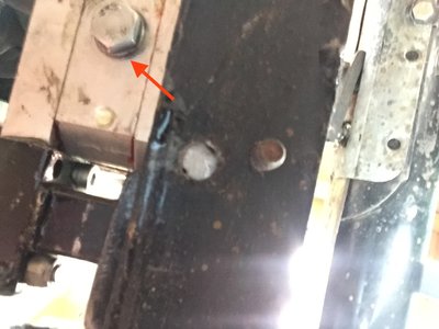

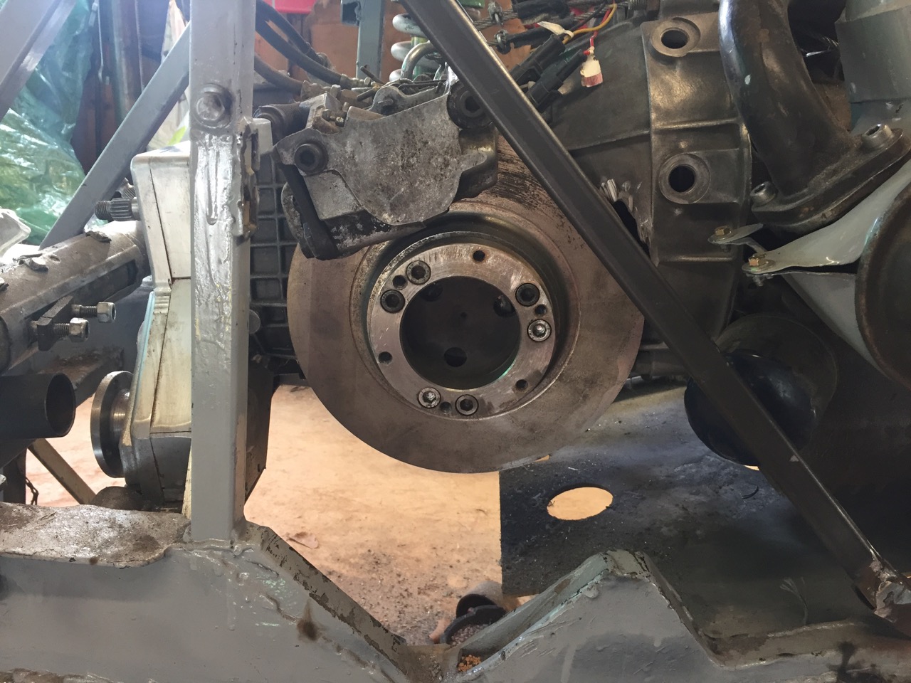

Discs now fitted and different brace (x2) allows drive shaft clearance.

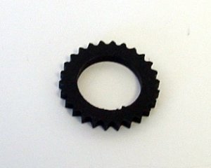

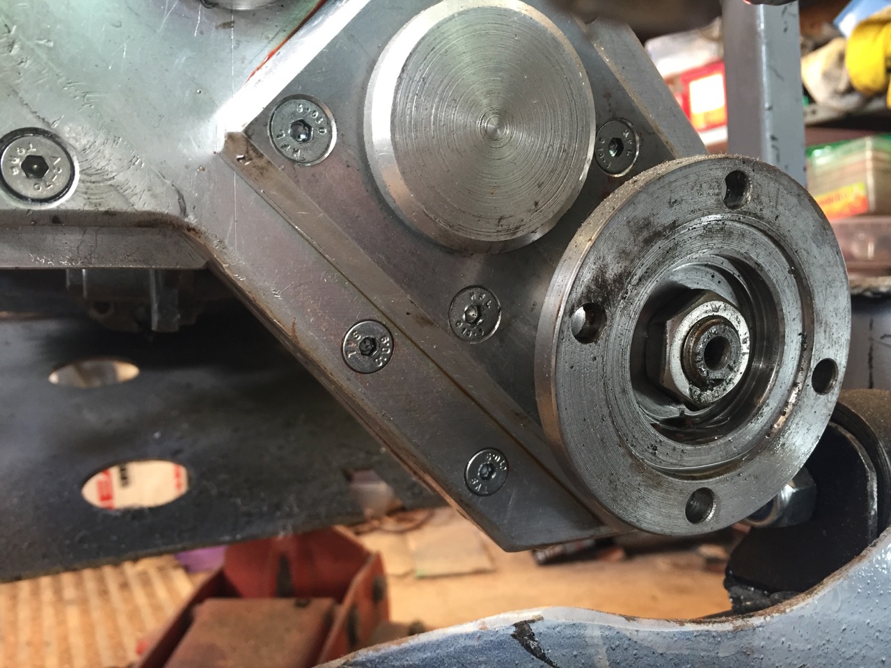

And a seal?? for the splined prop shaft flange??
On Land-Rover there is felt under the nut at flange. And many put also some sealing/glue to splines to avoid leaking...
Nicely done when there isn't any other leaks..!

Part no 5 on that picture...

Posts: 2257
Something like this...
Perhaps make it from felt or soft rubber?

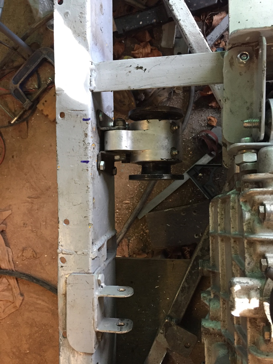

Posts: 2257
Fitted the centre bearing for the front prop shafts.

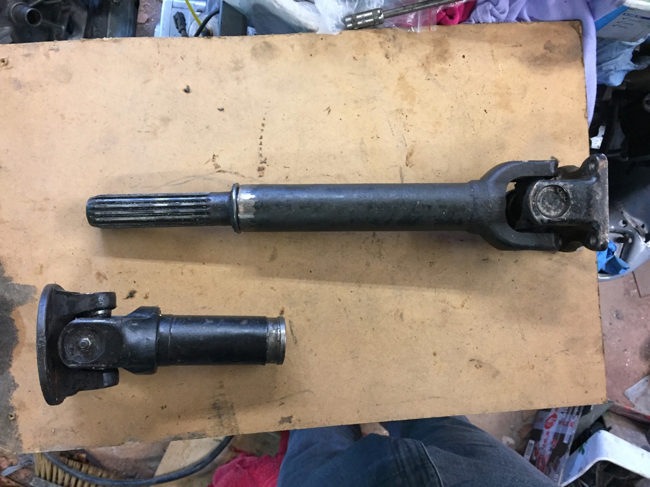

Shortened the first of two prop shafts, combination of suzuki/truimph-herald bits.

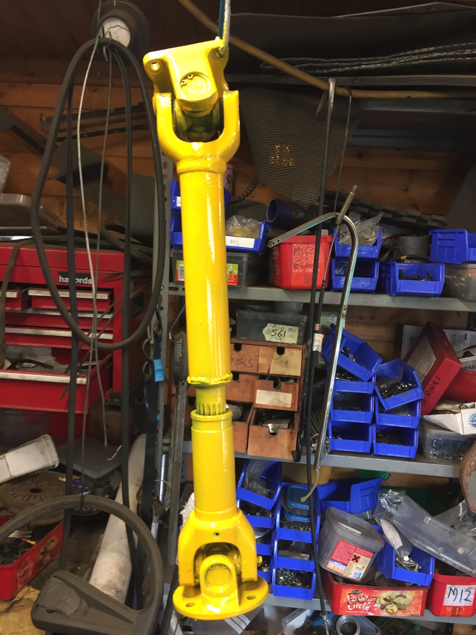

The first on and even painted it...

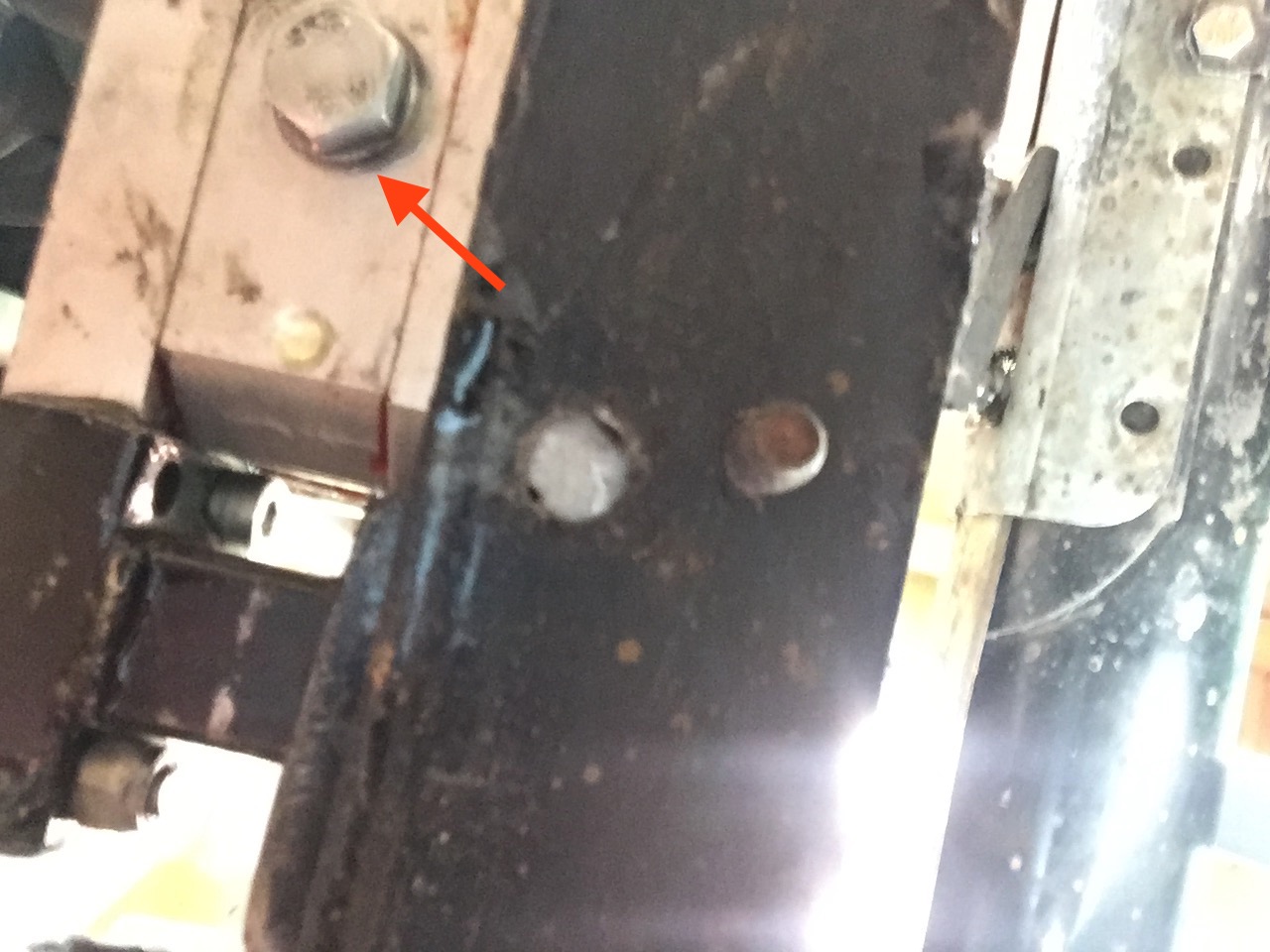

Ooh clean floor!.
Fitted the front diff prop shafts, they fit but very tight near the gearbox about 10mm clearance.
