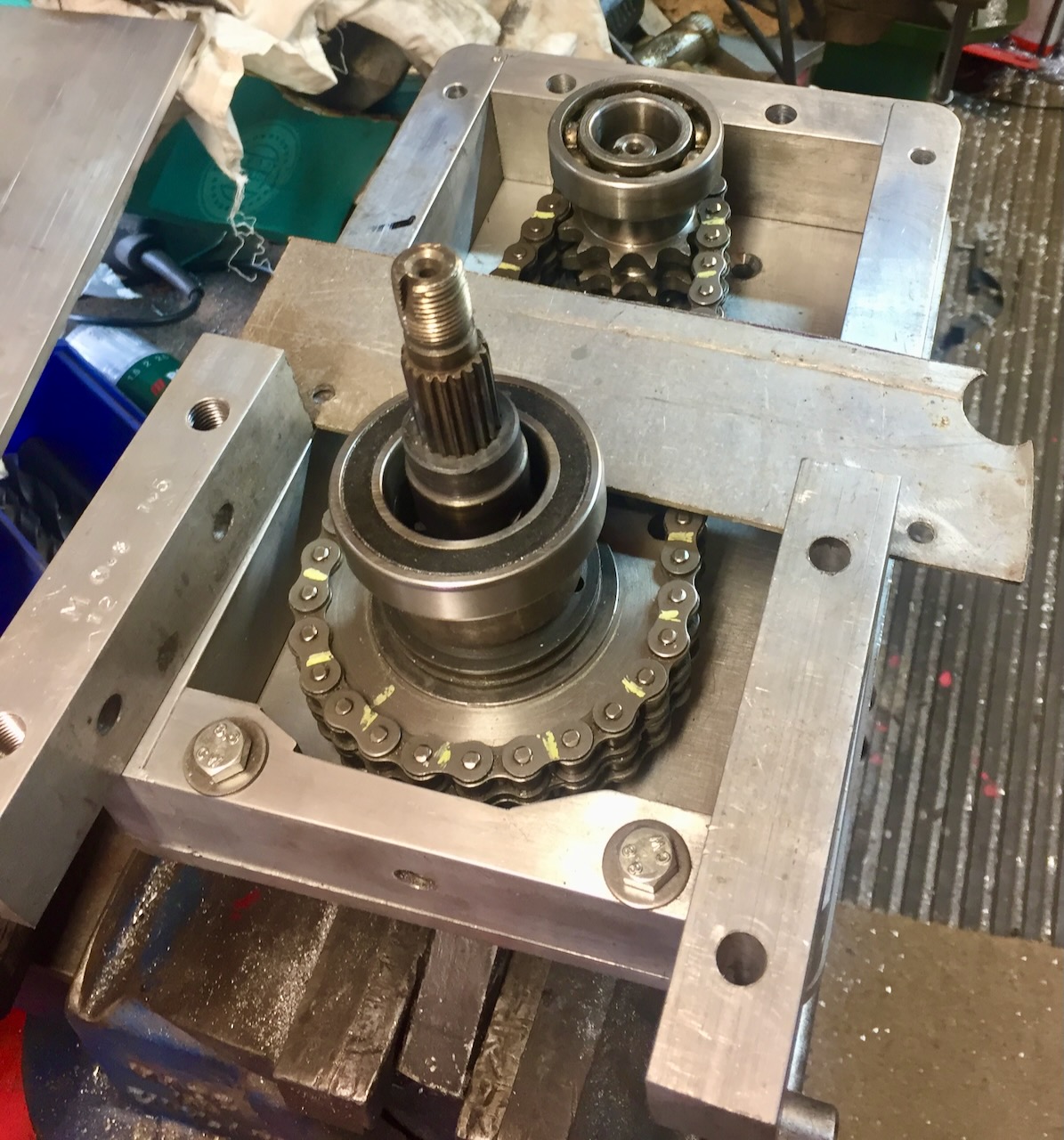

Duplex chain...

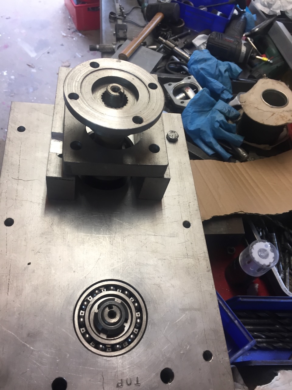

Mock up to see how to make the rear cover (many parts!!)
The thin plate bit in the middle is for of the clearance axle/steering tube.

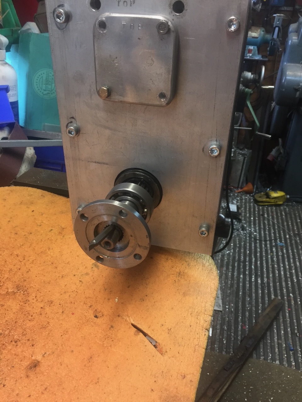

June 8th, 2024, 11:52 am

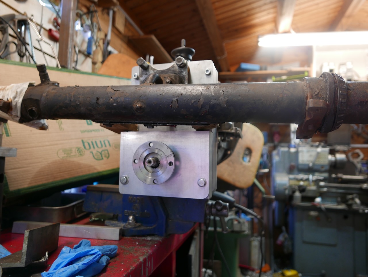

Back cover coming together, mild panic and curse it didnt fit on first try, it was the wrong way up:)

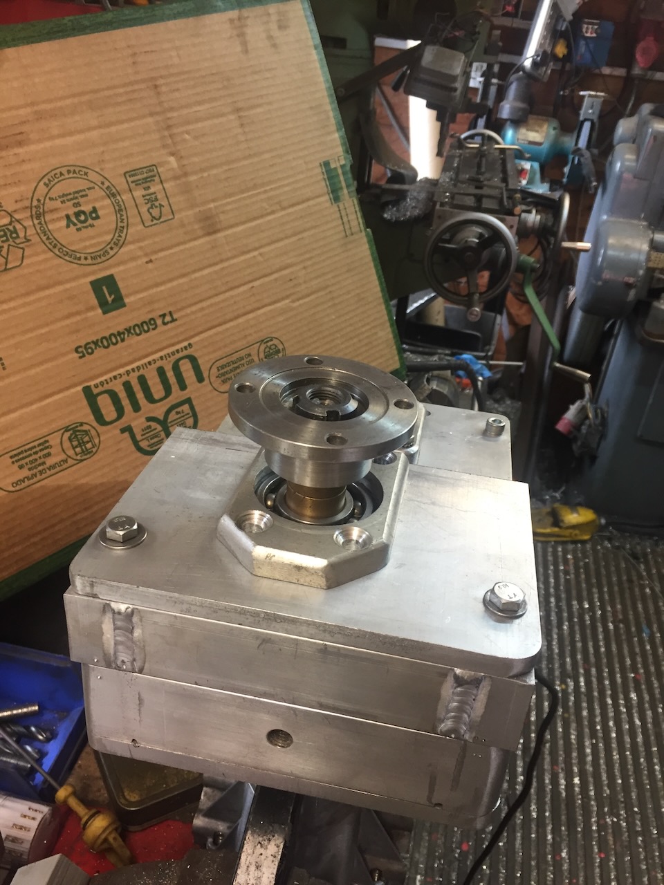

June 11th, 2024, 4:05 pm

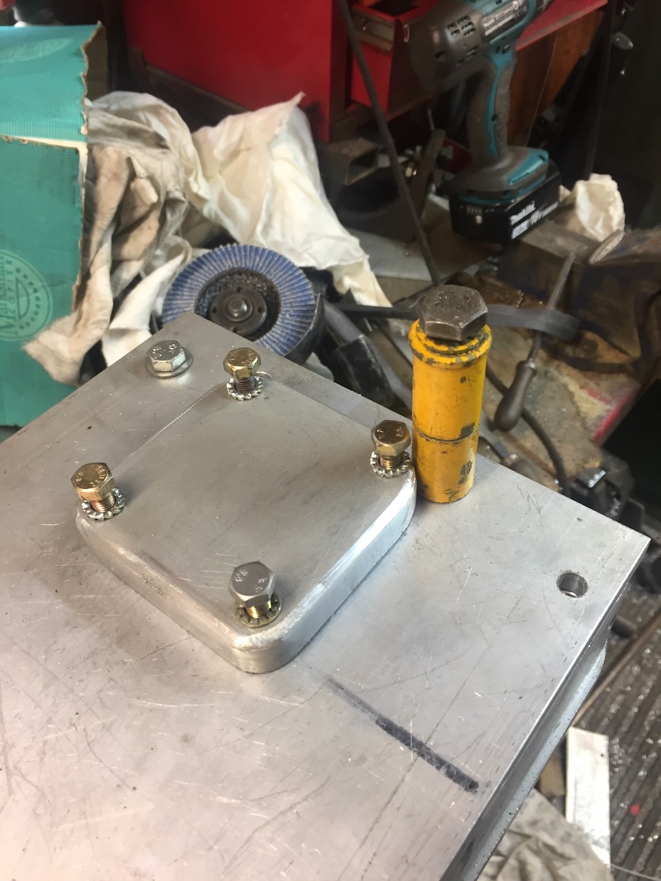

Getting there --------- top shaft/bearing end plate

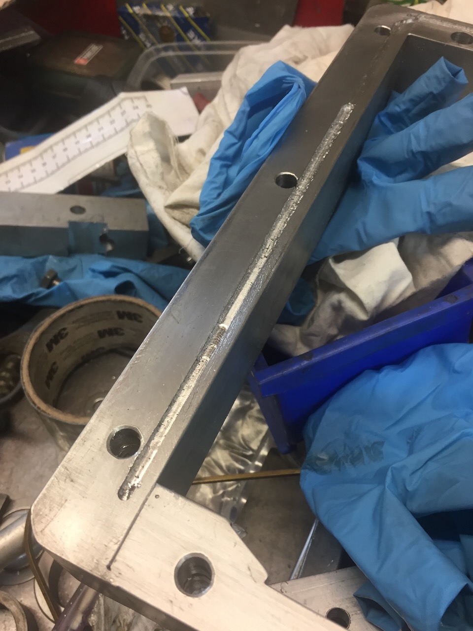

June 13th, 2024, 12:42 pm

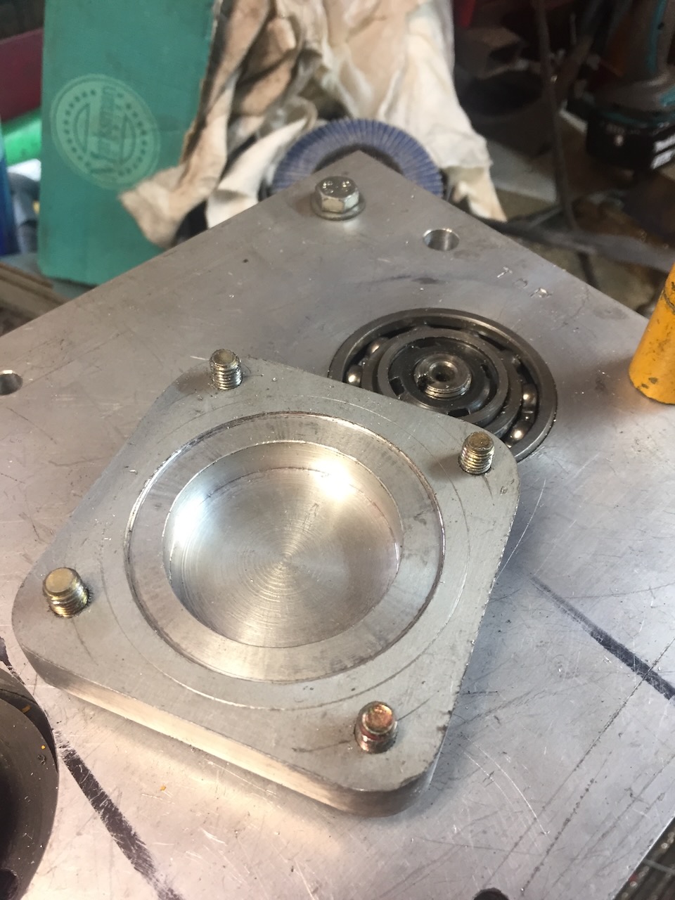

Bit of a disaster...
Had planned to use "o" ring material a seal. Two broken 3.5mm end mills and the result is a mess. :(
Will now use old fashioned gaskets. :)

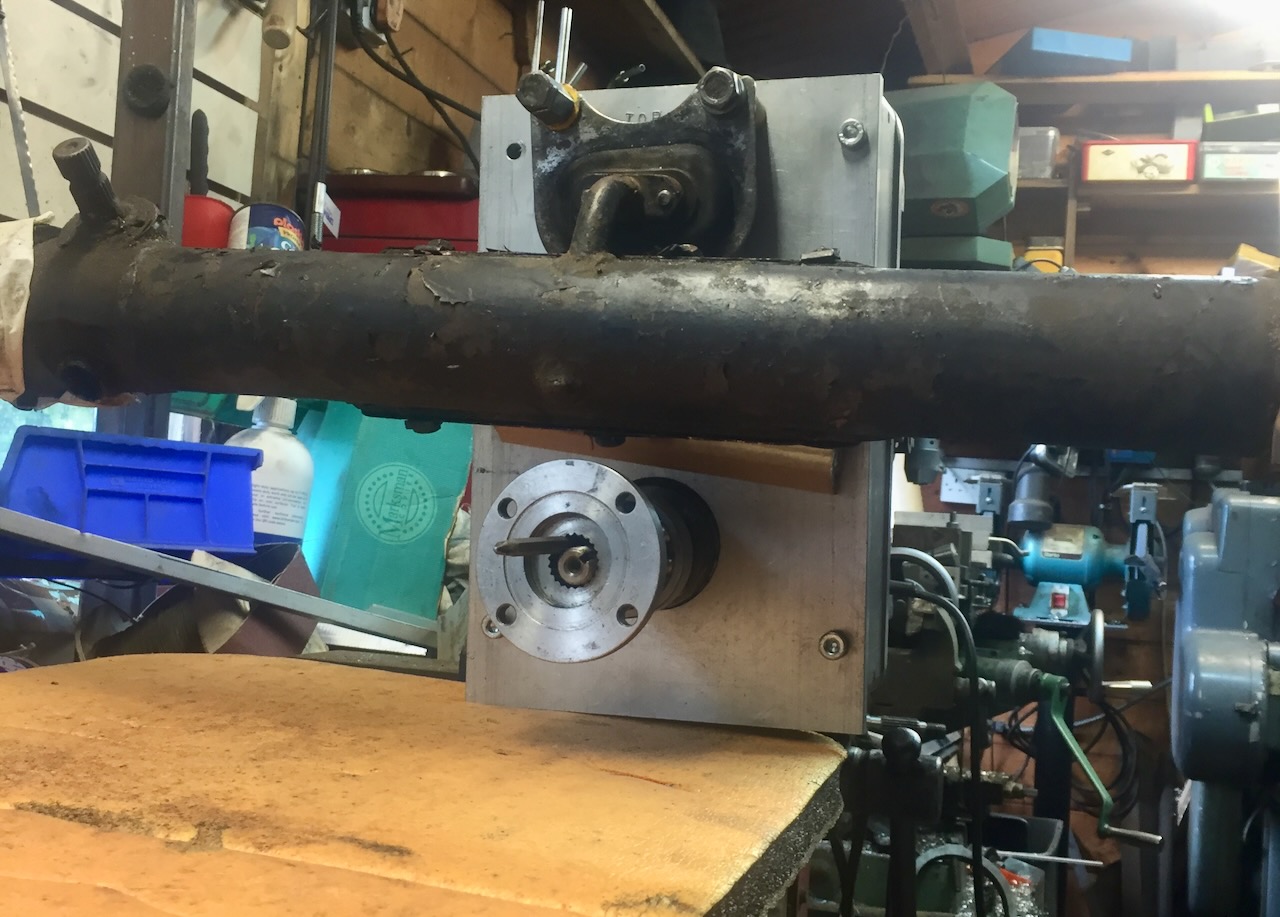

Will it fit???? :shock:
June 15th, 2024, 11:55 am

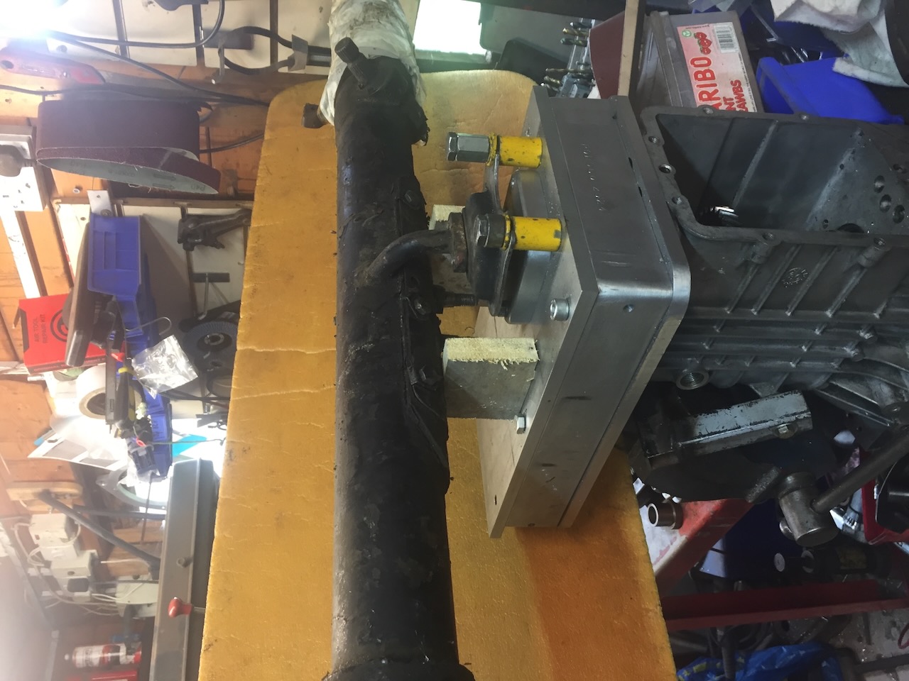

Couple of photos............

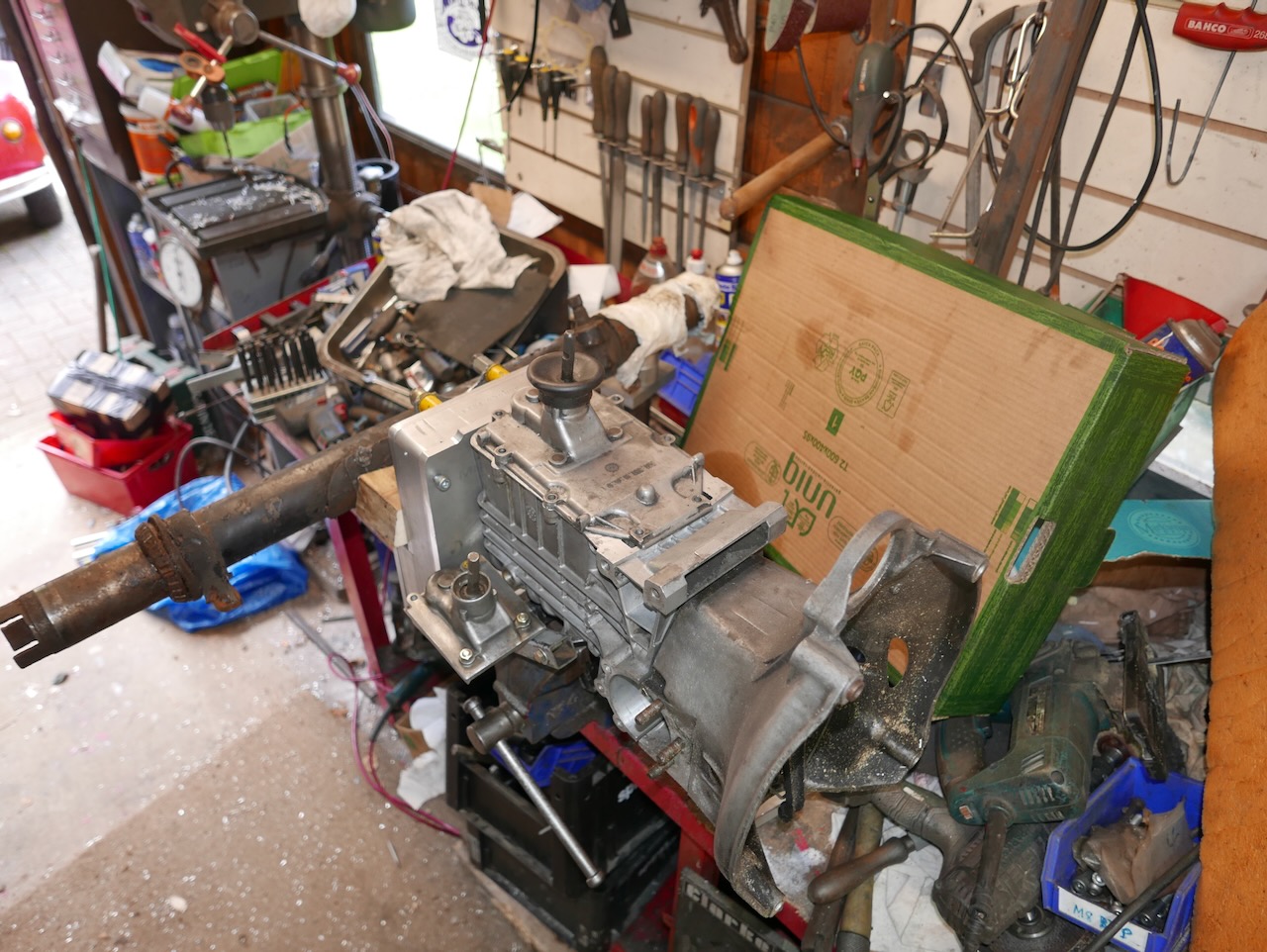

June 15th, 2024, 5:14 pm

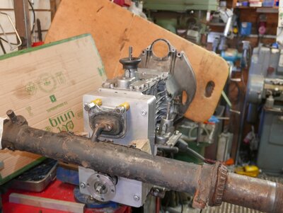

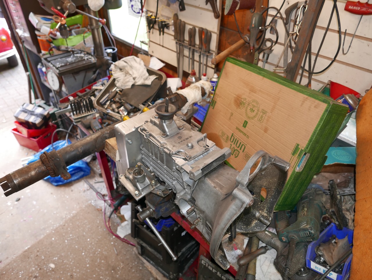

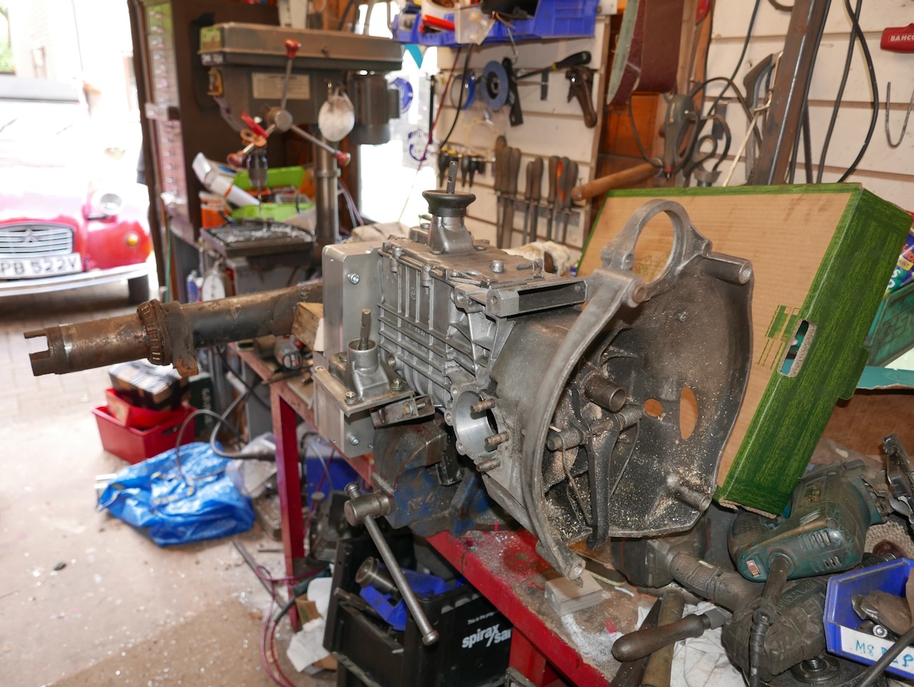

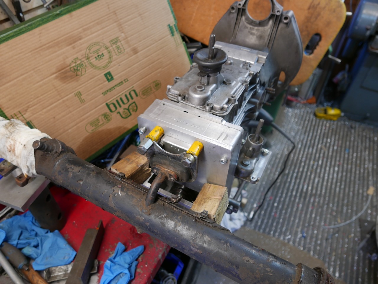

Last major part of the housing added.
Some views..... its quite large, possibly over engineered, unlike Colin Chapman, said only add "lightness" :)
June 18th, 2024, 4:45 pm
Posts: 2288
Well made...so the driveshaft goes inside the chassis?
June 18th, 2024, 10:47 pm
Yes, like a 4x4 Mehari ;)
