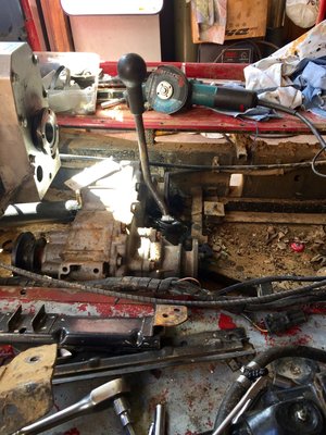

Current position for Transfer Box.
New Position for Transfer Box turned thru 180deg.
(Note the gbox on the middle left wont be there.)

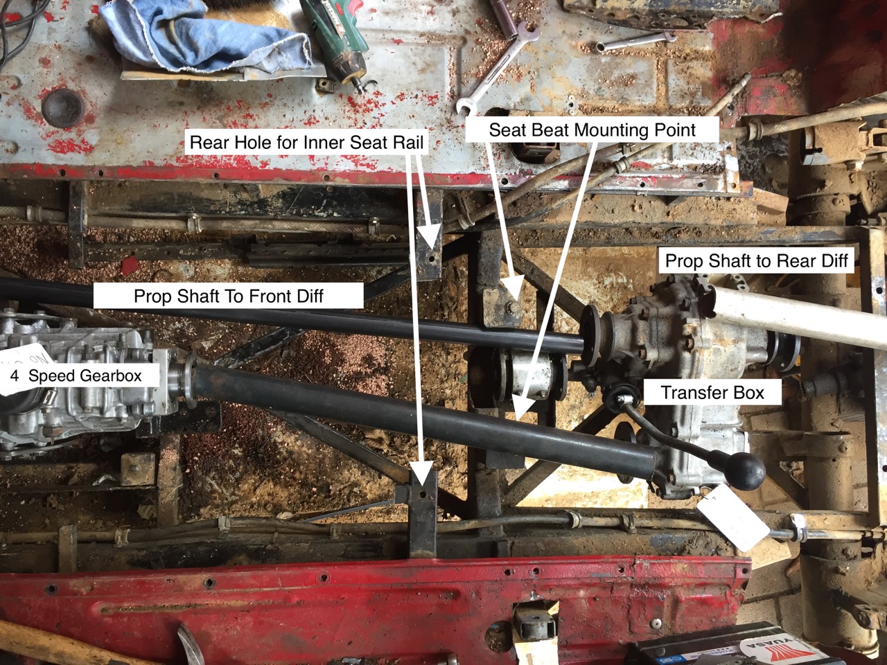

Another Revision :)
Plan view.

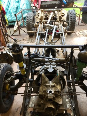

Took the body off to show the Neked Chassis.
Has 3+ years of mud to remove.
Seems that all the bits, will fit into the chassis, prop shaft angles not to severe.
Things like seat-belts mounts to be moved, new mounting points for the seats etc etc.

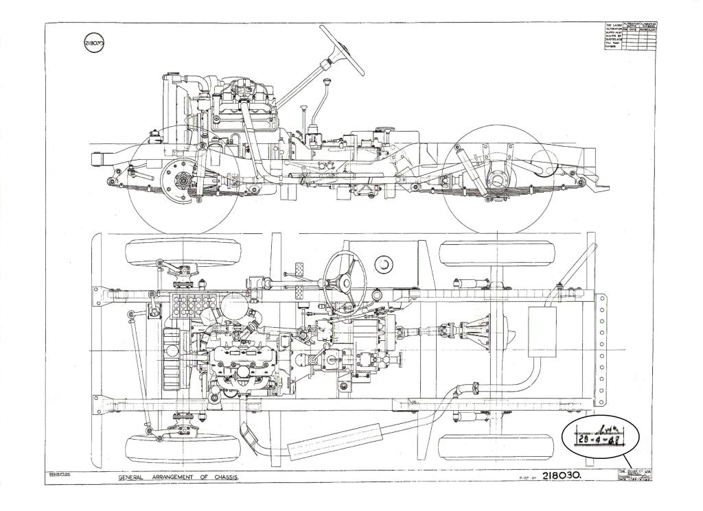

Your new layout is as per Land Rover - yes ?

@ChrisW
I've been rumbled :(
