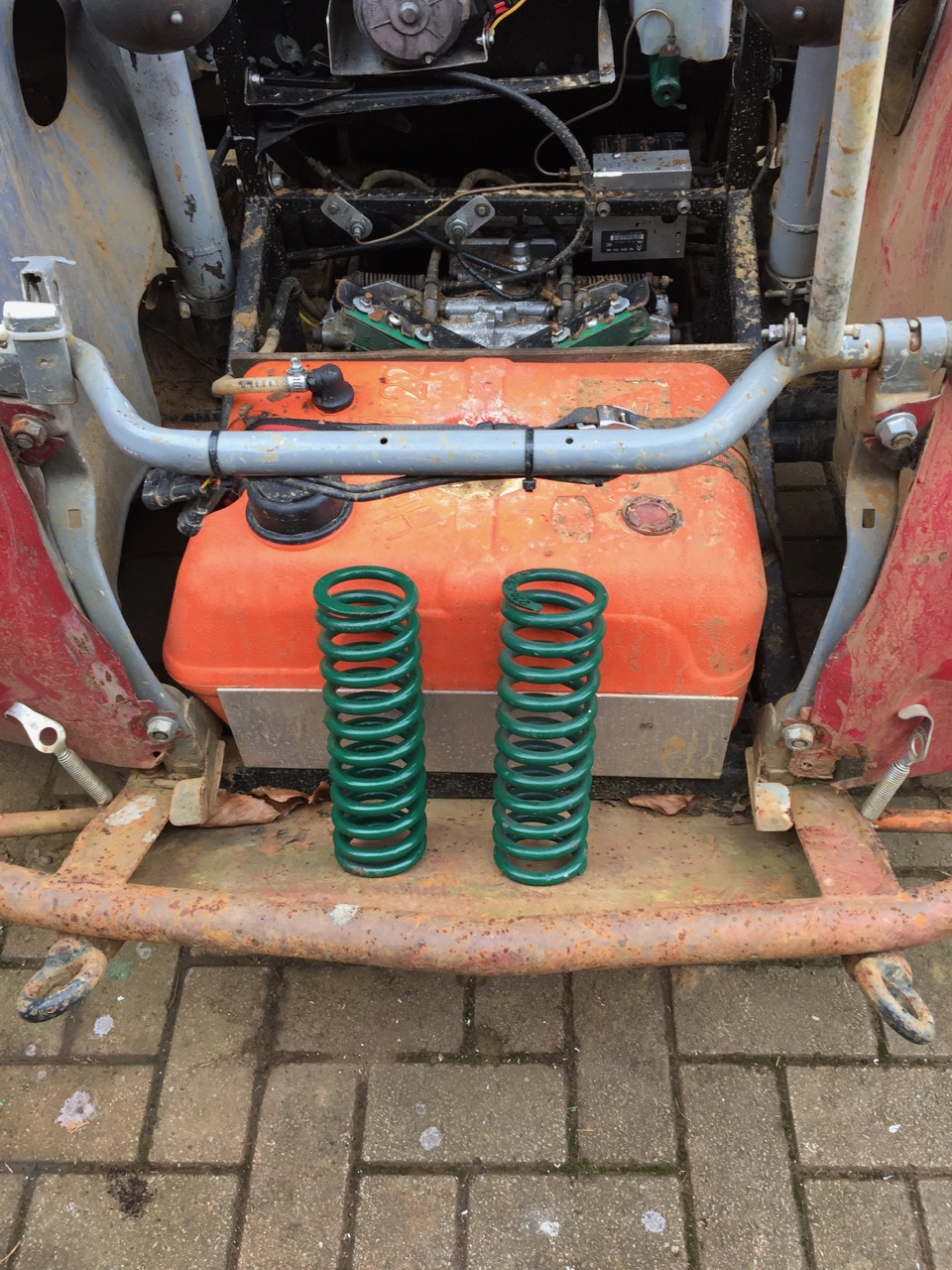

Acquired some Coil Over springs, will fit these over the front struts, to provide, the standard ride height.
The plan being to use the LDS struts only when needed, thus the need for auto leveling should not be needed :D
Newish Springs

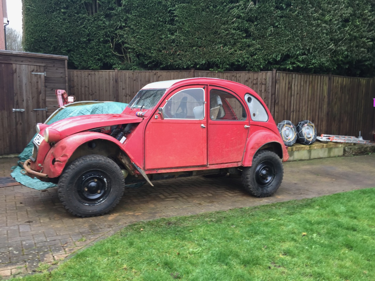

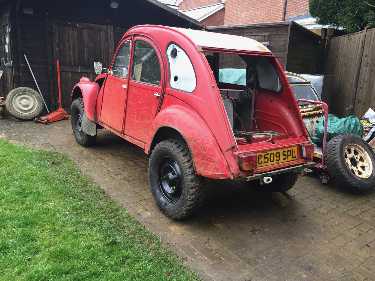

Got the loan:) of some Large tyres.
Well it now looks the part.

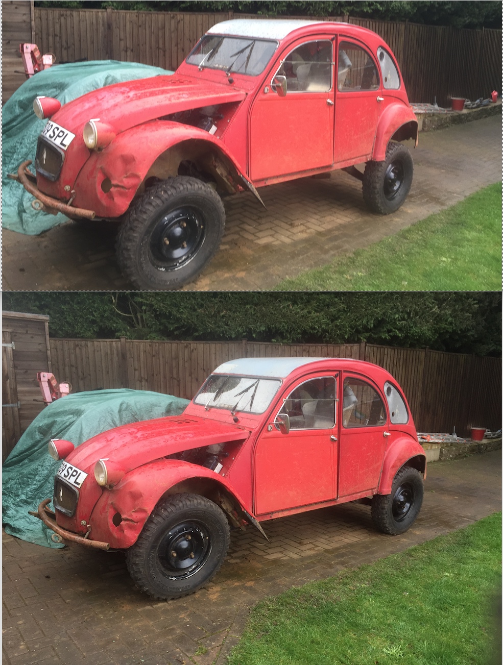

Maximum and Minimum
February 28th, 2017, 6:01 pm
Posts: 816
Needs lowering... :twisted: 8-) :mrgreen:
