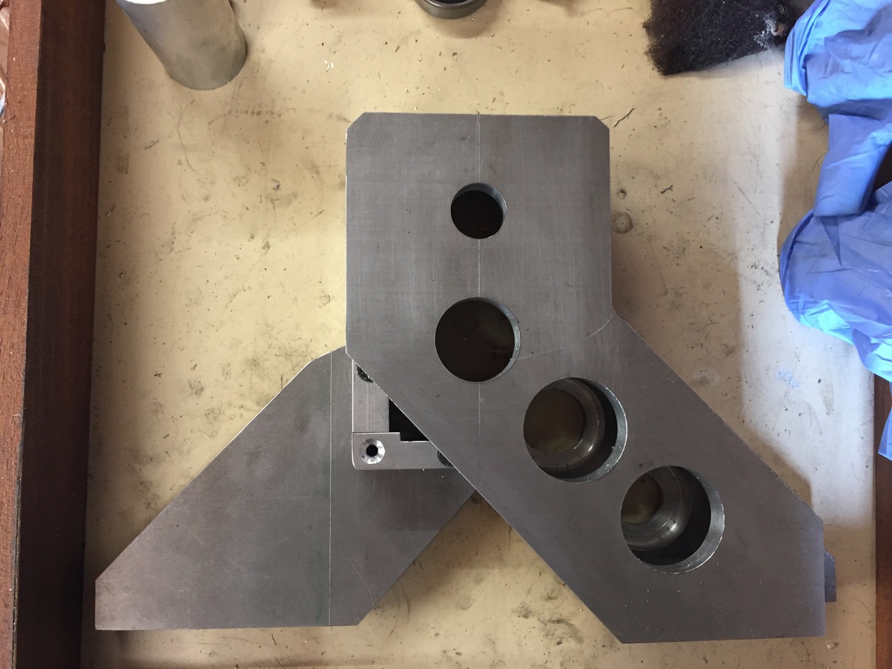

Looking better the less metal there is...

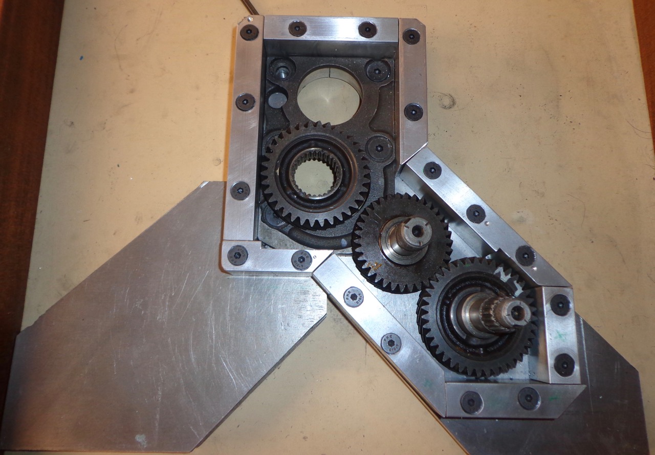

Completed the Top, Sides and Bottom of the rear cover.
Its sturdy as it has to support the bearings for the middle gear and the lower output shaft.
