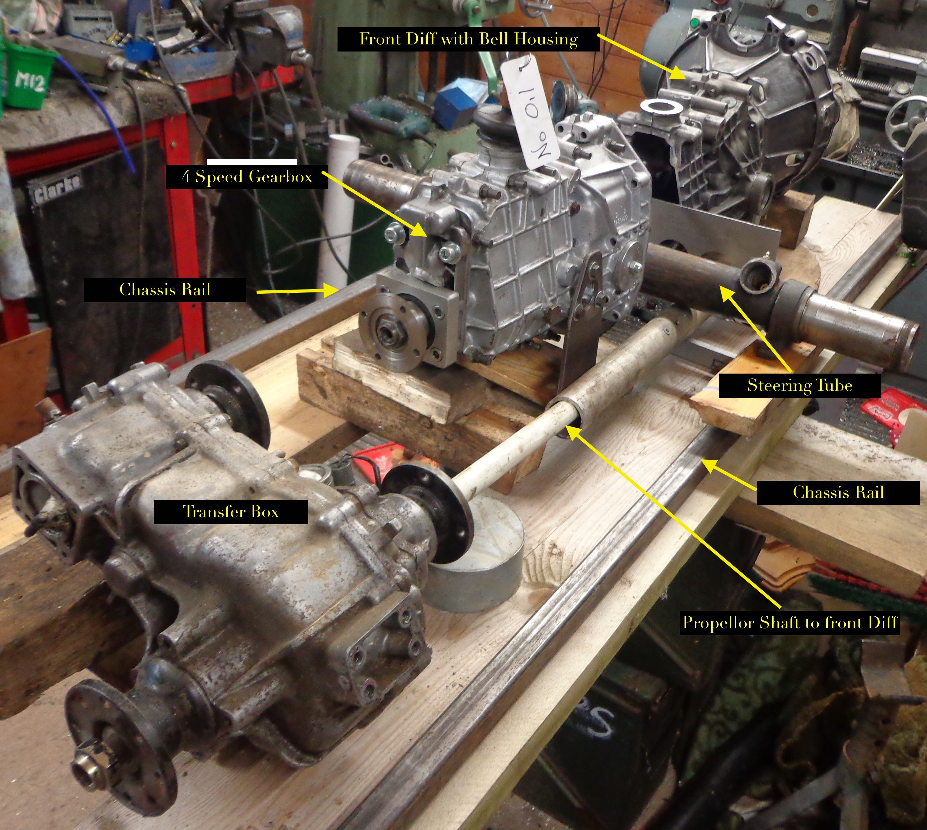

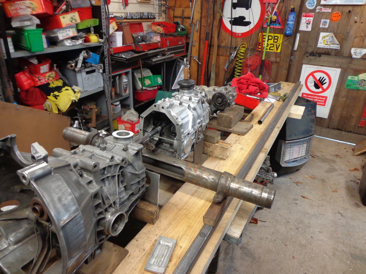

Tried out some bits today to see if the concept will fit together.
It will be very tight but I think doable.

@looks great but isn't it going to be very heavy?
The current mid engine set up is 870 Kgs, which is heavy.
Some of the protos in France with light weight chassis are are about 550 Kgs.
The future plan is to try and make a Tubular Space frame (combined body and chassis)
