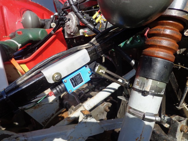

Like the Breadboard prototype, clever.
At the moment also using the Kiss system.
Waterproof micro switch with LED, raise the suspension until the LED goes out.

Oh, thats very reliable solution, and with an offroad car isn't really need for automatic height correction I think. My weird mind started to think what you gonna make next, and some steps forward, and I saw "the only way you going to go" is to use hydraulic valves, just like when Citroen started to make hydraulics...
Back to basics, and with those hydraulic systems, they hadn't nearly any problems until they invented the anti-sink -system, and after that jamming height correctors was the new issue with...

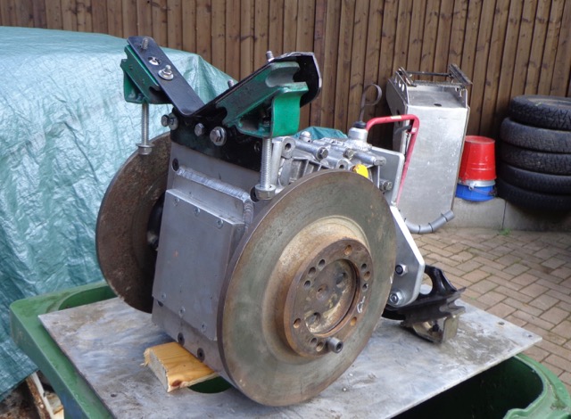

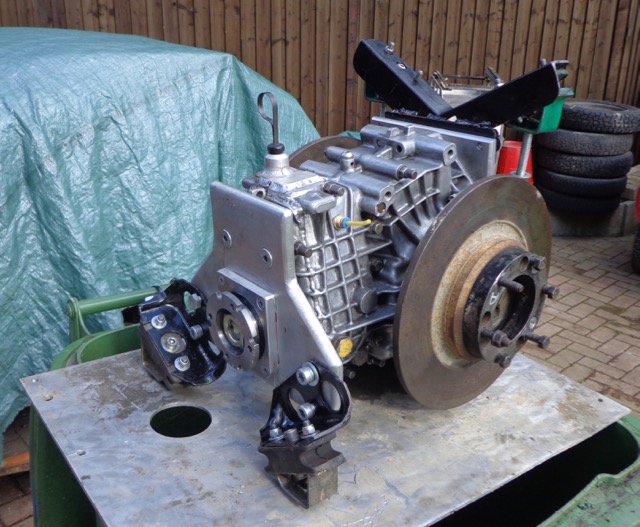

Front Diff ready to fit to car.
Many thanks to Rick (Gearbox Guru) for his expertise in the setting-up the Pinion Gear/Crown Wheel.

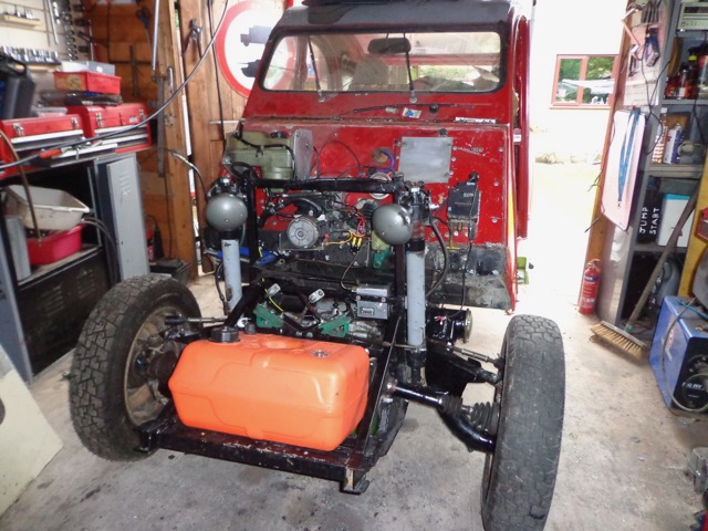

Almost finished...well its back on 4 wheels.
