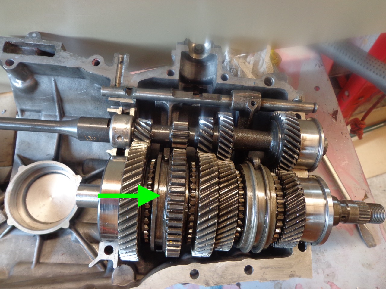

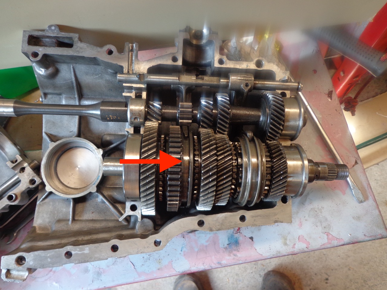

Re-assembling gearbox and try selecting gears on the bench.
Seems to be stuck in reverse.
The best way to to put things back, the way it was designed.
Gery-matter vs RTFM vs Pictures.
Bad

Good

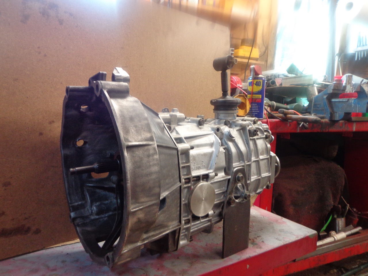

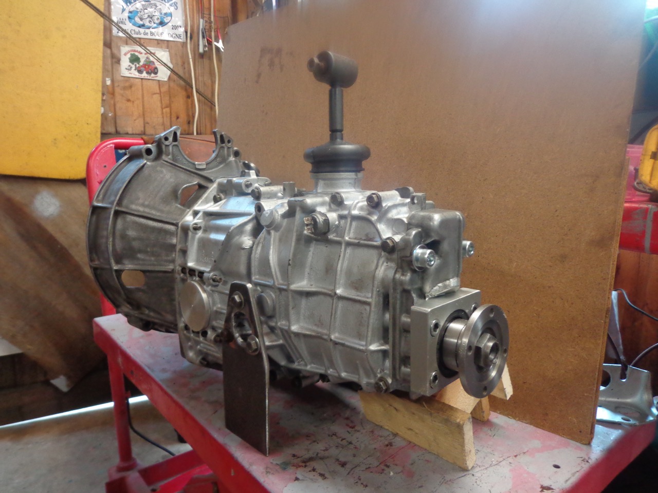

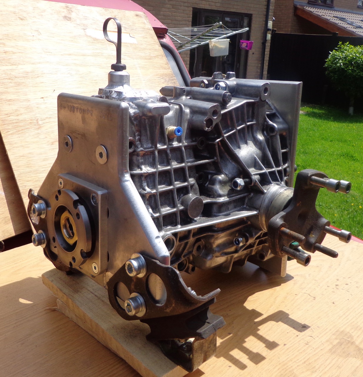

Gearbox now with LN ratios (lower than GS).
Not far from completion.

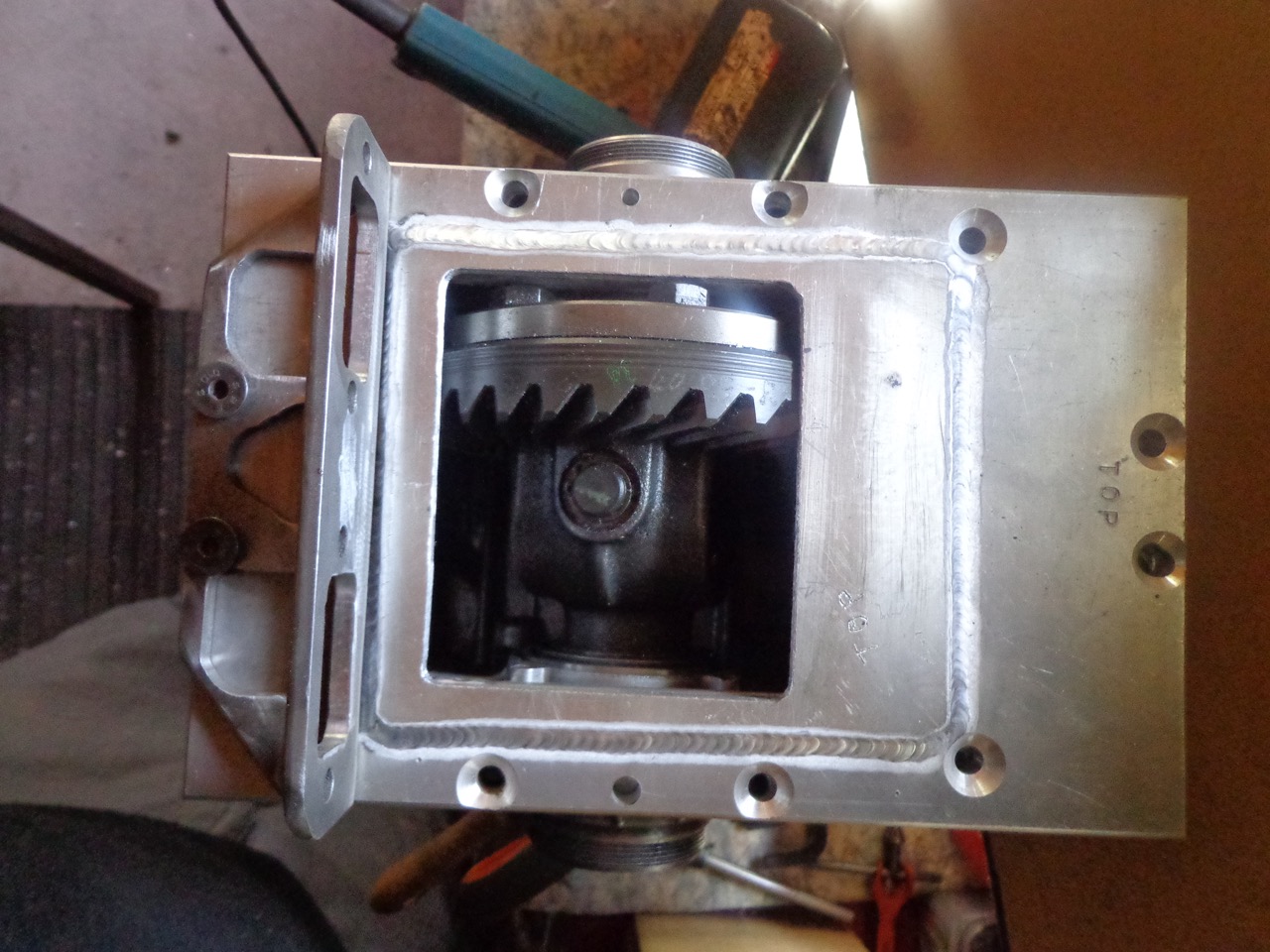

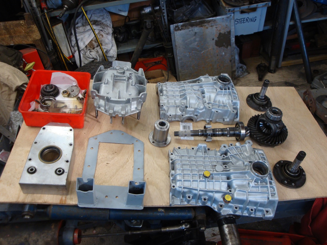

Diff Cover.
Still go to fabricate a cover for the Crown Wheel and then get it welded.

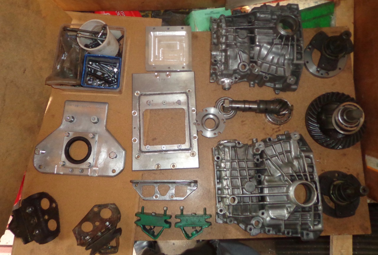

Done all the cutting, grinding, welding, milling, drilling, tapping and general fettling...
Now to assemble all the parts and "Align" the crown wheel and pinion.
Current working differential. Mark I diff.
New Stumpy Version. Mark II diff.

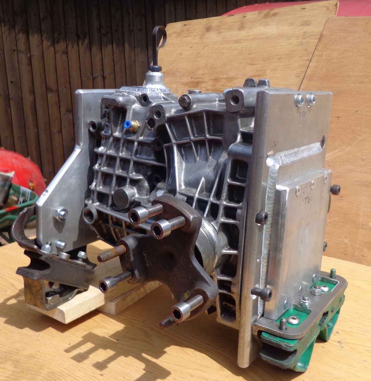

Assembled Diff.
Rear View.
Front View

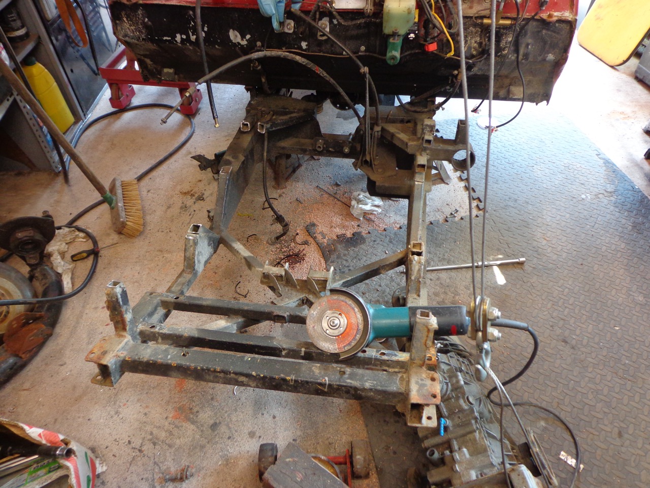

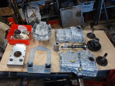

Plan is to put back standard front arms and standard steering with C5 struts.
The short differential should then fit in, then squeeze a narrow prop shaft under the cross tube????.
Cut most of the front end off.
