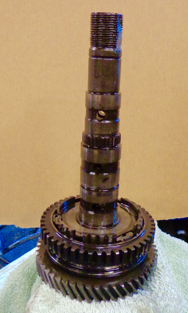

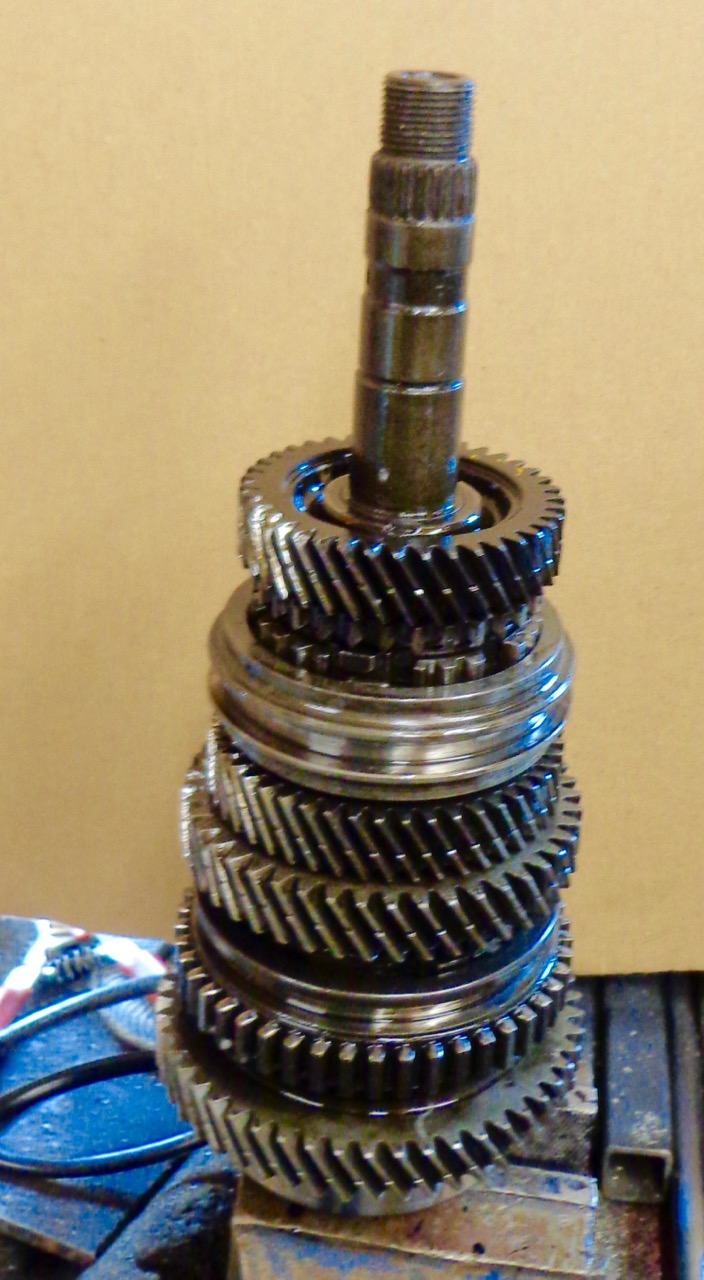

Got Bored doing the seat in the cold.
So swapped the gear ratios.
LNA 4 speed gears on to a 5 speed main shaft.
GS____1st - 3.818 2nd -2.294 3rd - 1.500 4th - 1.133
LNA___1st - 4.545 2nd -2.500 3rd - 1.607 4th - 1.147
ps Circlips/Snap Rings without holes were designed by the devil!
ps Where has the the Jerome Cats -2CV site, gone?
LNA Shaft.

GS (longer with spline)

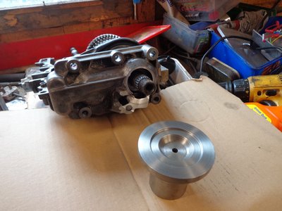

Rear output shaft of my new gearbox, together with the part machined (by me) output flange.

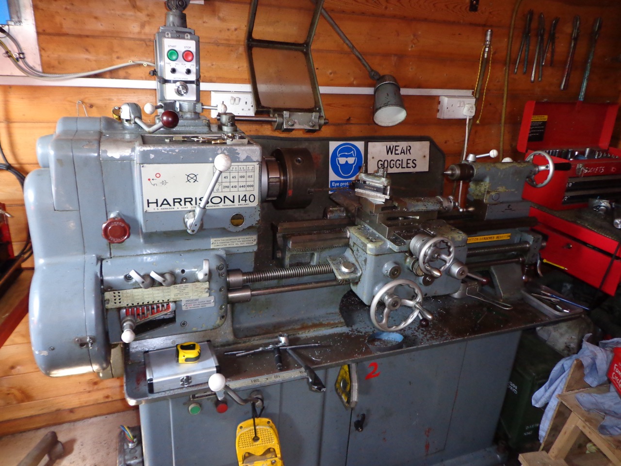

where is the gearbox comming from..... Which lathe do You have

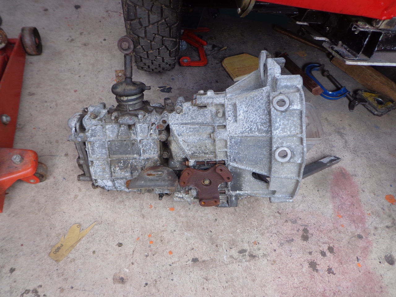

Citroen LN from 2cviking.
Harrison 140 (with Inverter/speed controller)

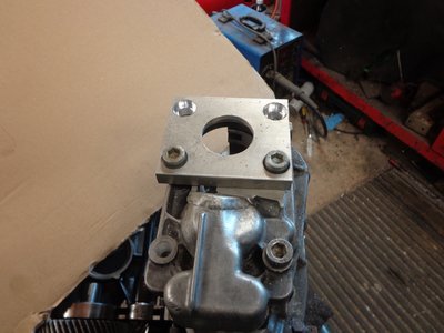

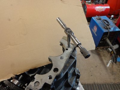

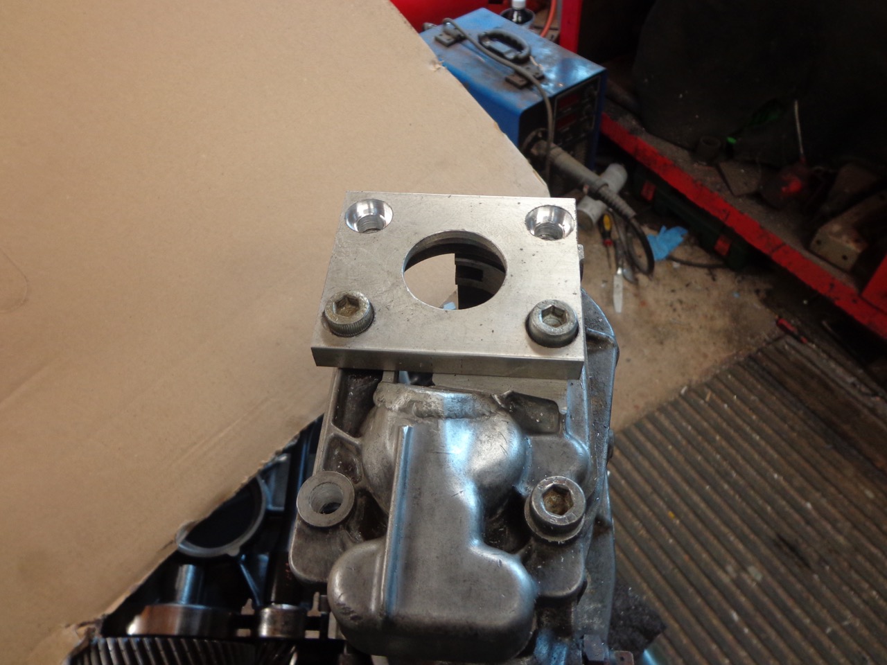

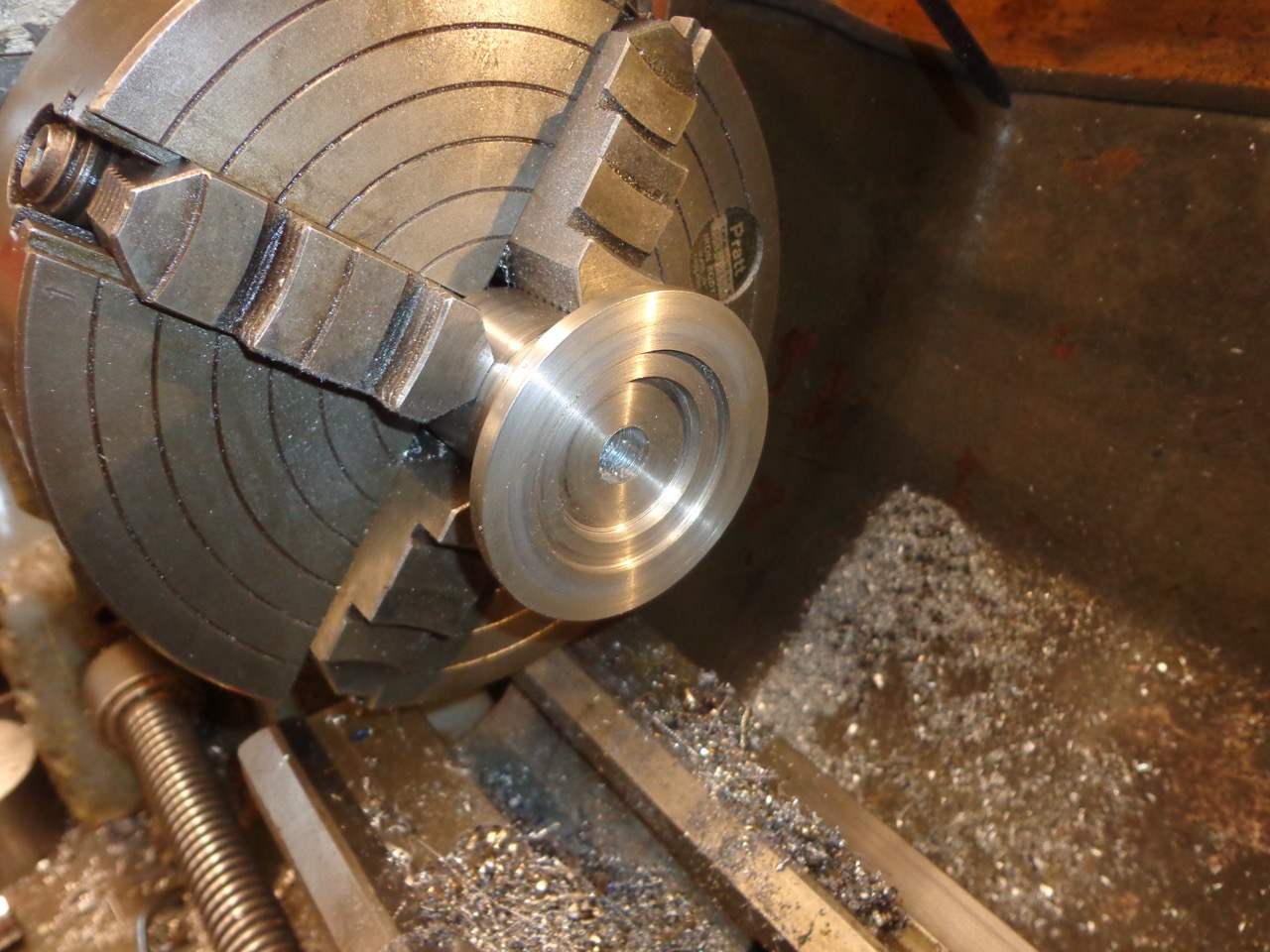

Made a carrier for the new rear lip seal.
As M9 are difficult to source, drilled/tapped the casing for M10.

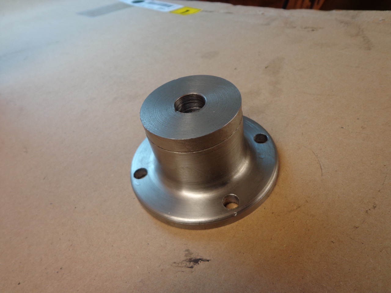

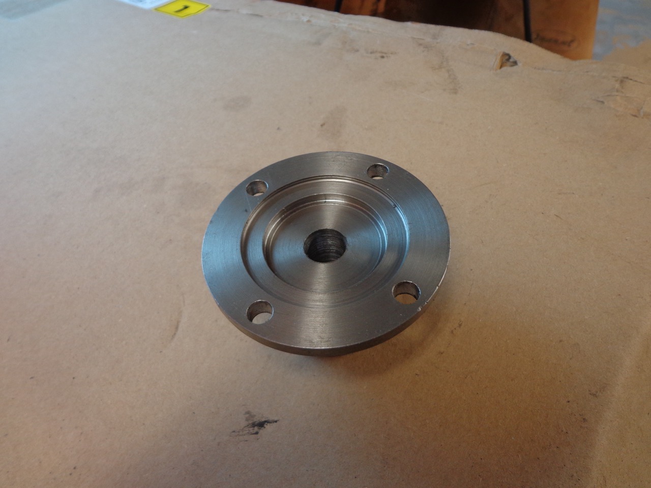

Gearbox output flange sans splines.
Doesn't look much, but a local machine shop would charge about £150+.
May try and get the splines "wire eroded", else its a weld to the the syncro flange, not that bad as its a weld similar in dimensions to skinny prop shafts.
WIP

Tidy End
