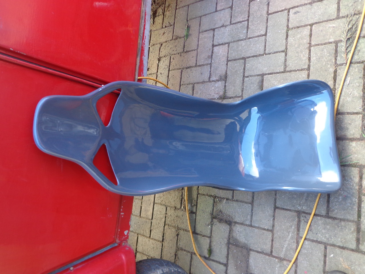

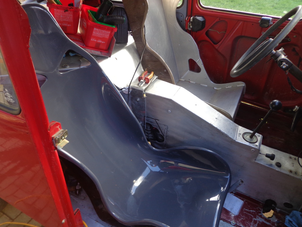

Purchased some GRPs seats.
Did a trial fit, will give just enough room for the seat belt stalk
Need to fabricate a new frame,still using the 2CV runners.
As they are Bum shaped, there will be a bit more comfort.
Shiny New Seat

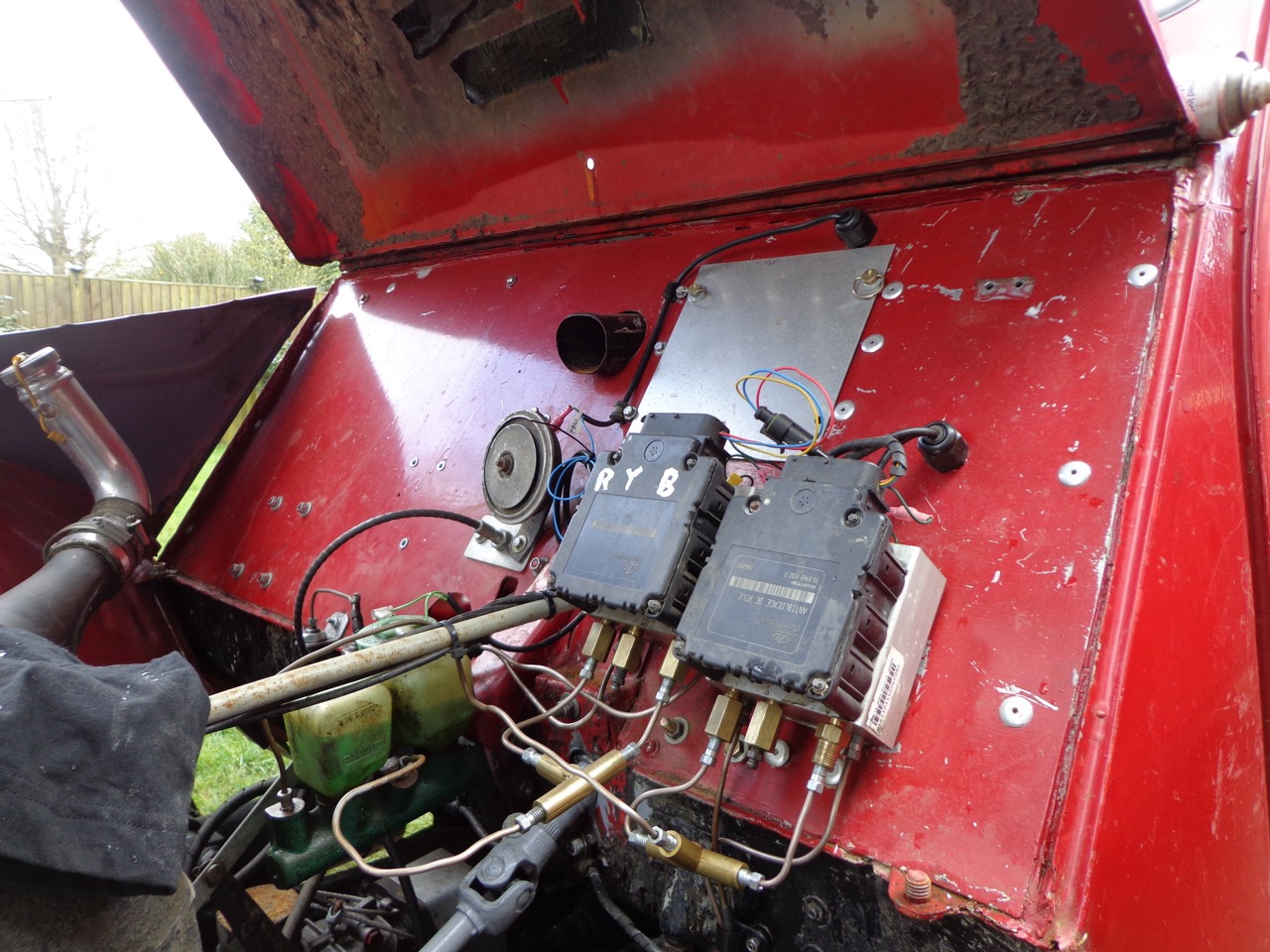

Start with - Love your work. Can I ask if you have diff locks or means to lock one wheel at a time or 2 etc to get power to go to the wheel where there is grip?
February 9th, 2016, 5:58 pm
@ChrisW
Thanks for the feedback.
I’m using Citroen GS boxes, front and rear, no diff-locks.
Have got line-locks on each wheel, which works on the drive way….
GS ABS blocks with direction reversed.
See https://www.youtube.com/watch?v=16ZdC7-HbCs
The future?
As the GS diff is a bit bigger, than the 2CV, it may be possible, to do a “plated” differential (Not ATB).
See http://www.davemacprops.co.uk/gripper.html.
Plan a visit with a diff and see if it can be done??? £££

@Geo,
Its just manual.
Push the brake pedal.
Switch the power to the appropriate valve/solenoid. (That locks the wheel.)
Release the brake pedal.
Then drive away... And switch the power off.

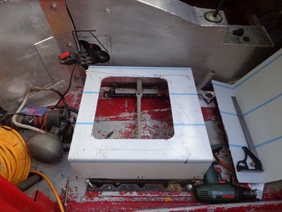

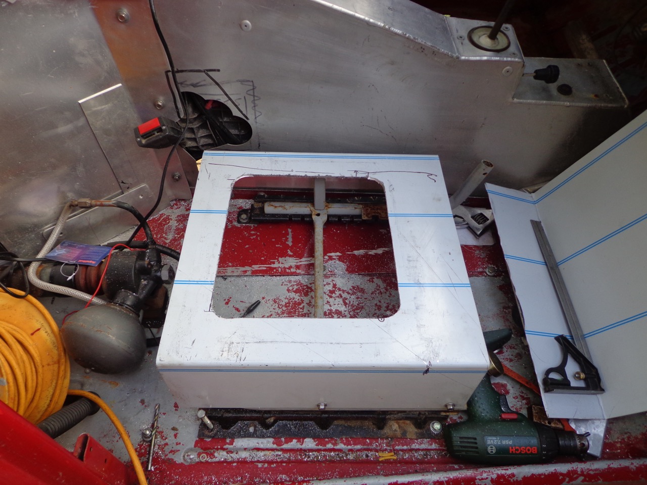

As the sun was out it was warm enough to make a bit of progress on the new seat mount.
3mm Aluminium bent up with a hole for the bottom of the GRP seat.
