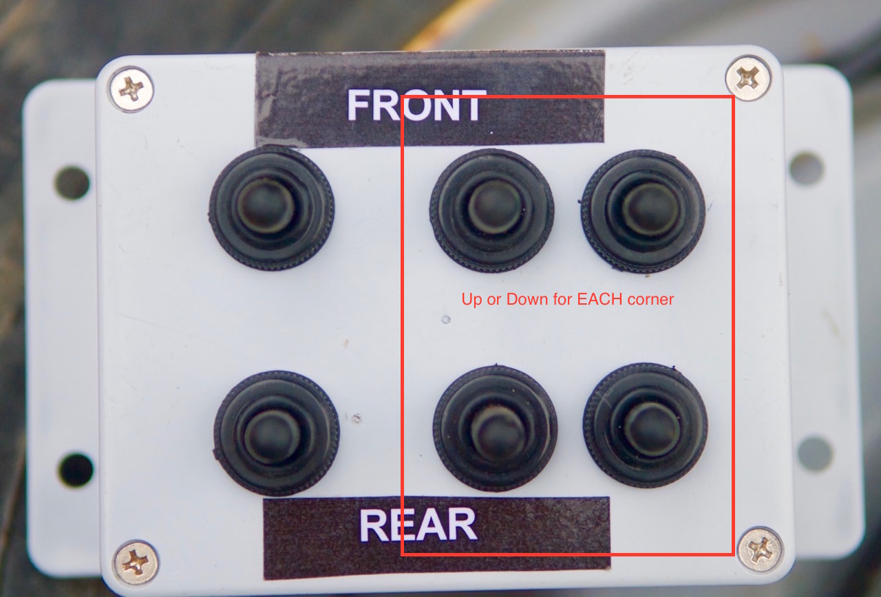

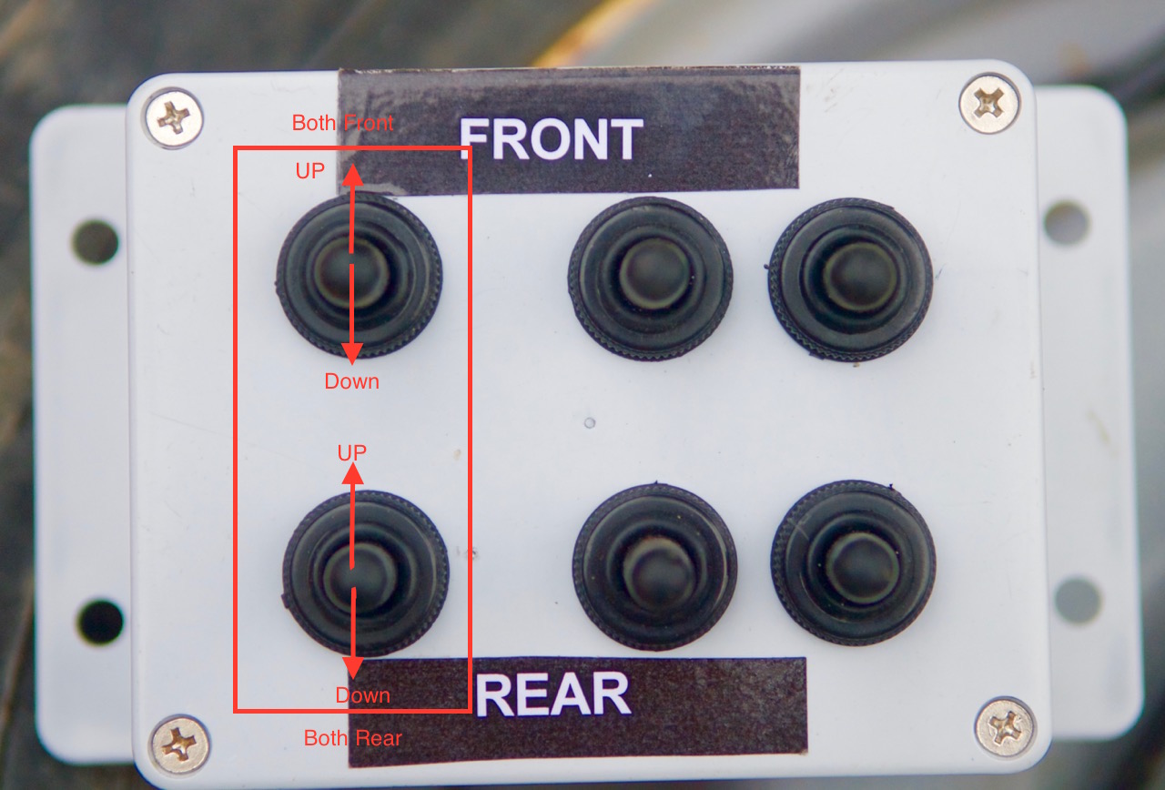

Put the control switches in a Box, to keep the water off them.
The 2 switches on the left control up/down of the front and the rear.
The 4 switches to the right control the up/down of each corner.

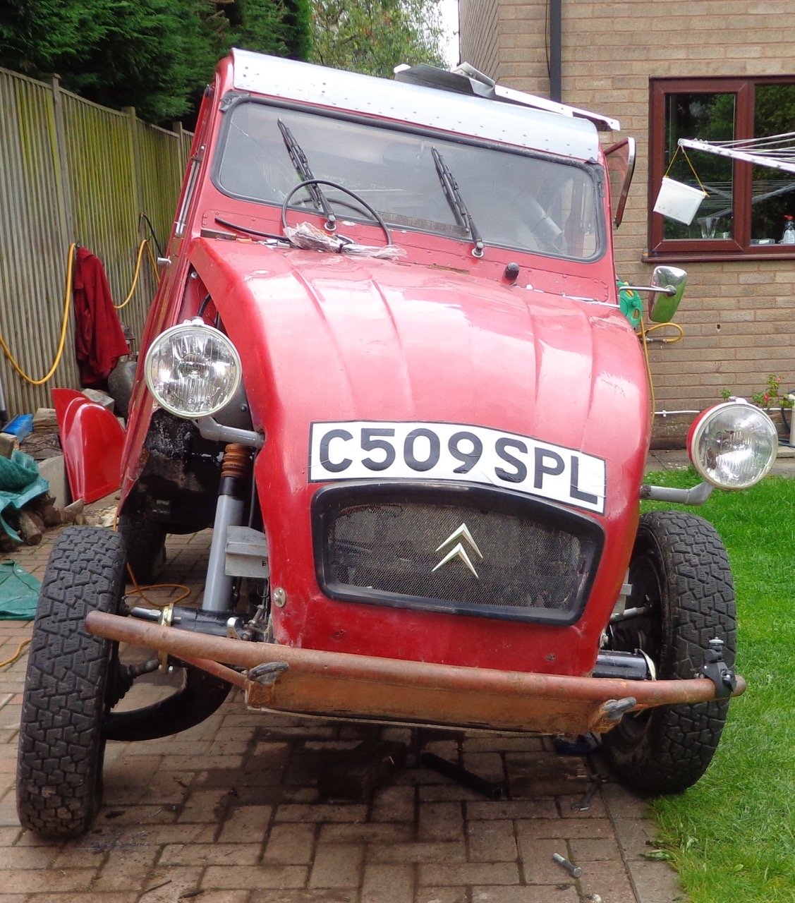

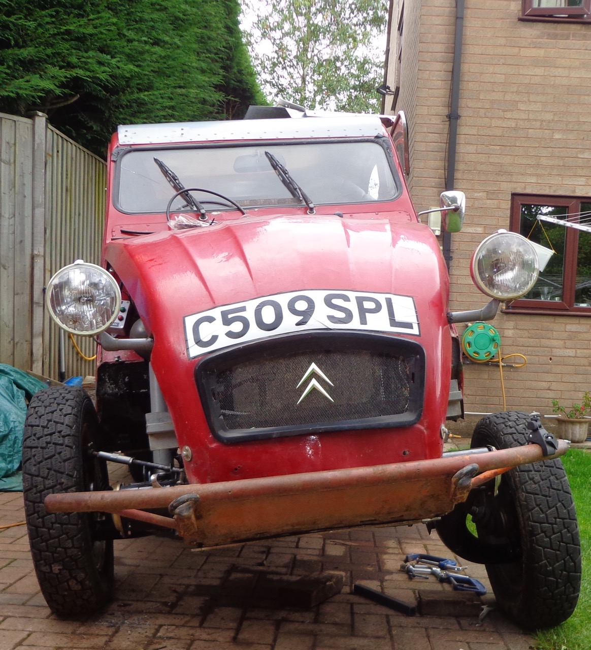

Due to the recent Gales..
