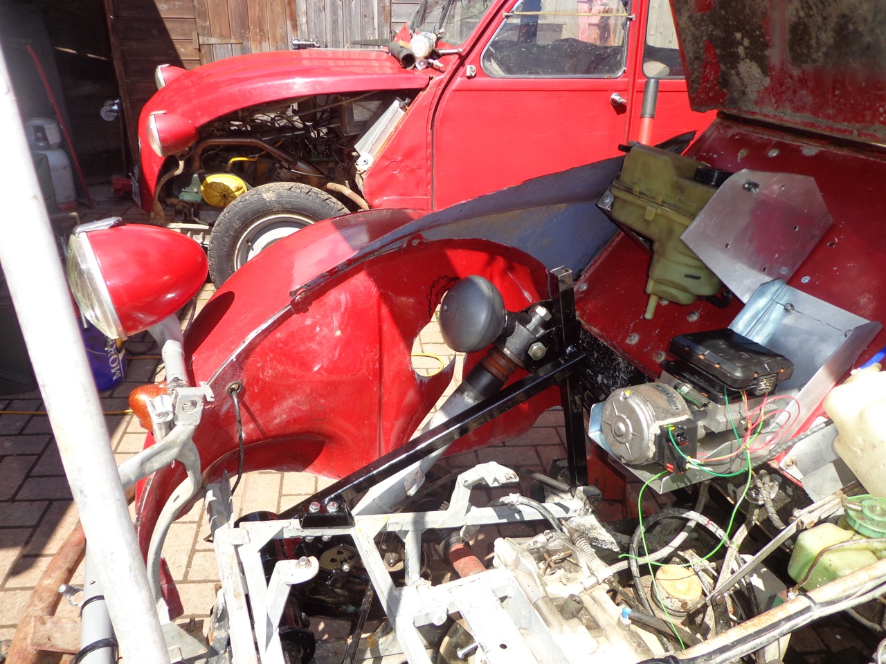

Front Wing Fits... Almost.

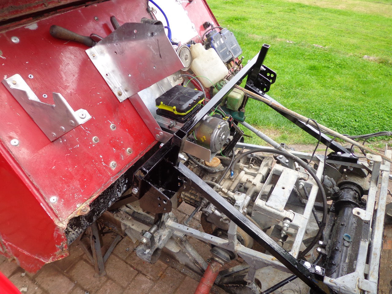

Top Brace Fabricated and Bolted in Place.

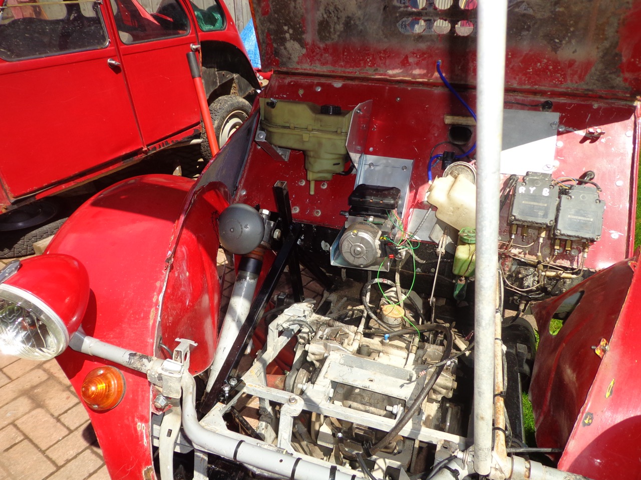

Strut Top Mount with Pivot Bolts and Locking bolts.
