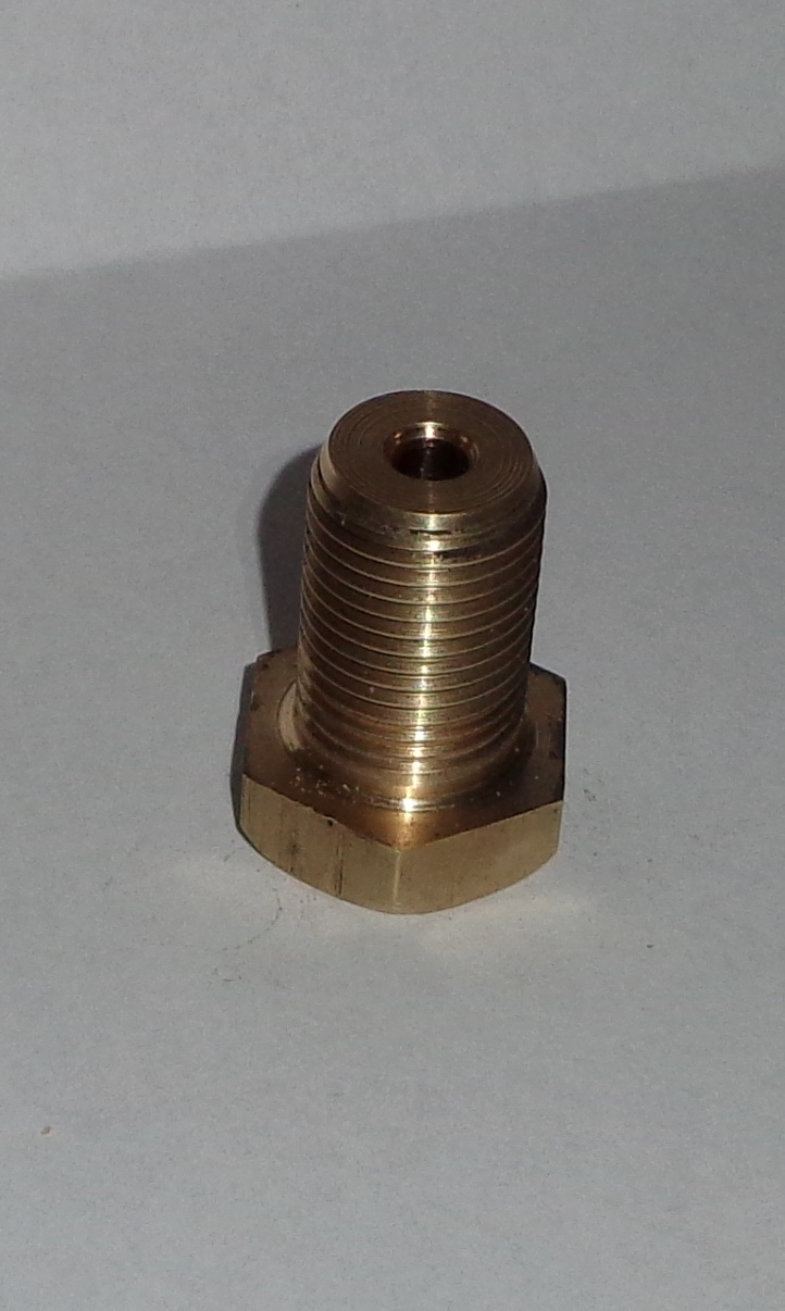

Version 1 in Brass... it leaked..

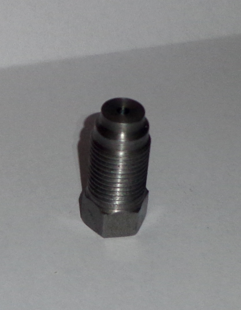

Version 2 in Steel... it wept...

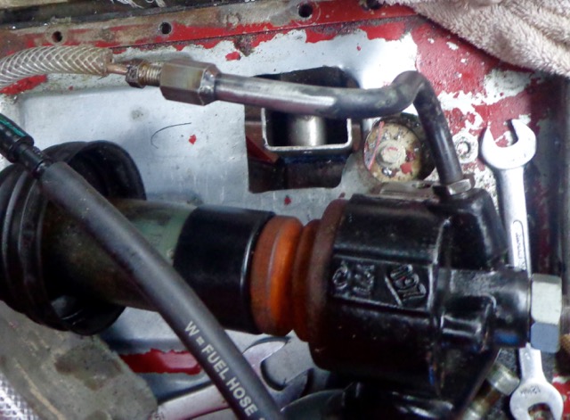

Version 3 Re-Use Original Citroen.

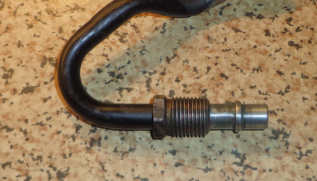

With 8mm Union on 3.5mm pipe adapter Tig welded on ... No Leaks...

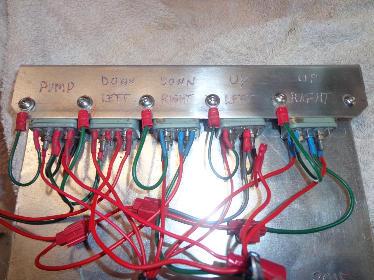

Motor and Valve Control.
Some relays an push button switches from the junk box.
Military Spec Hermetically sealed Relays
24 volt but work OK on 12 volt
Ebay @ £2.00 each

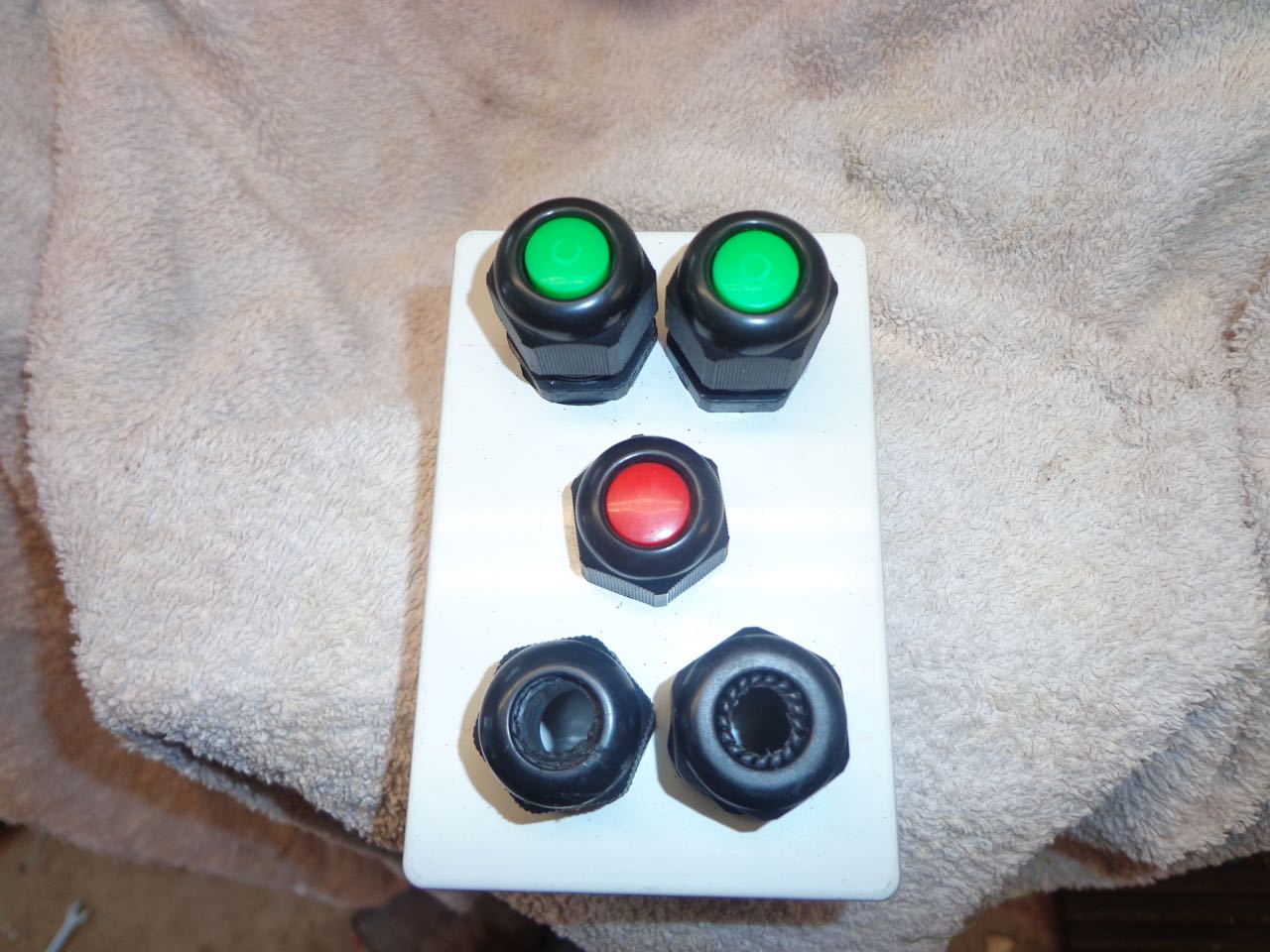

Push Buttons from Chinese Suppler
Ebay £10 for 5 but 5 week delivery time
June 13th, 2015, 4:28 pm
Posts: 212
mate you got more wires than an XM hydra!!
i'll stick to the mechanical solution
barking
June 14th, 2015, 7:52 pm
Make a 1 wire can-bus system...
June 14th, 2015, 10:29 pm
