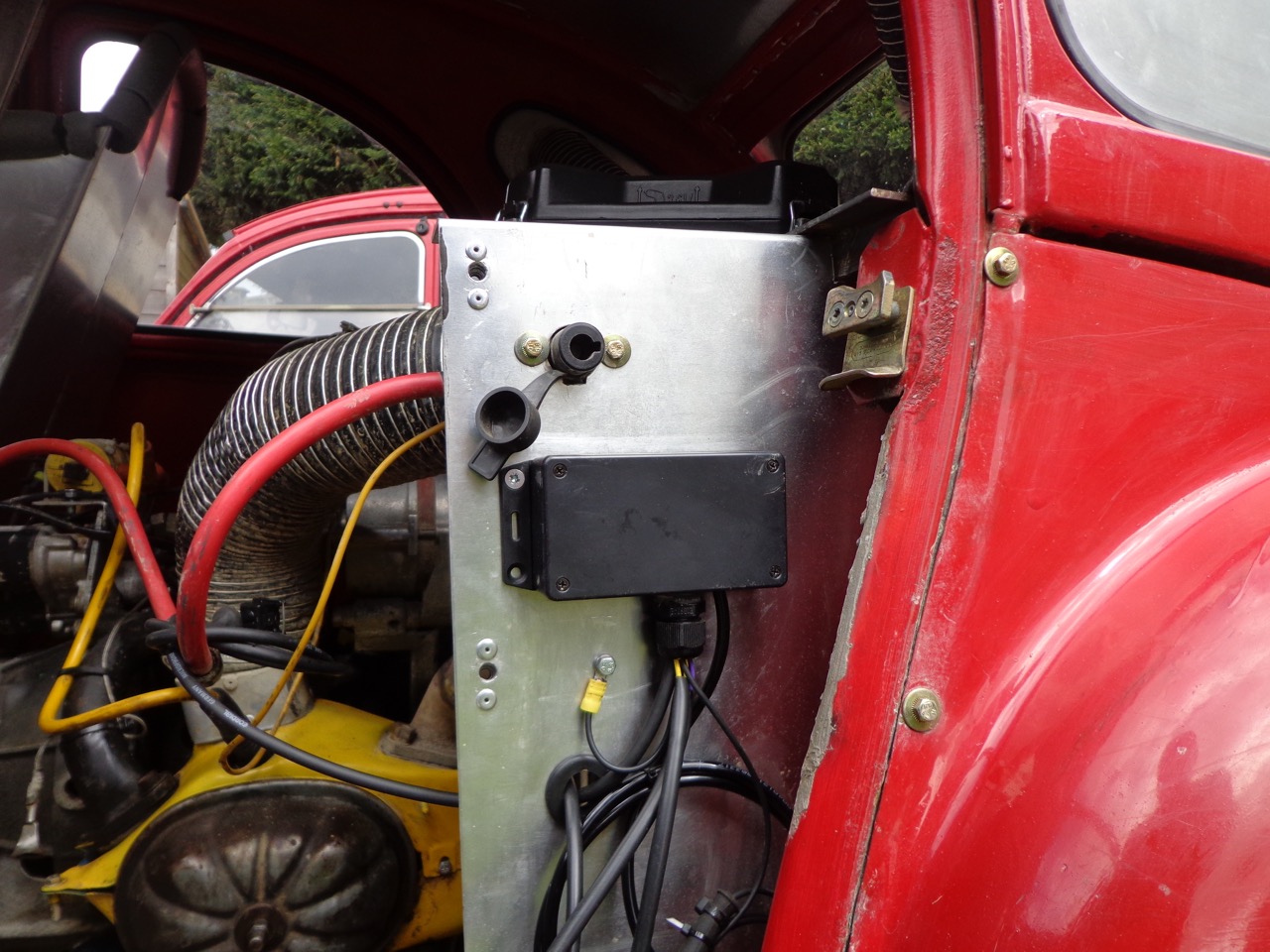

Upgraded to the Production Model.

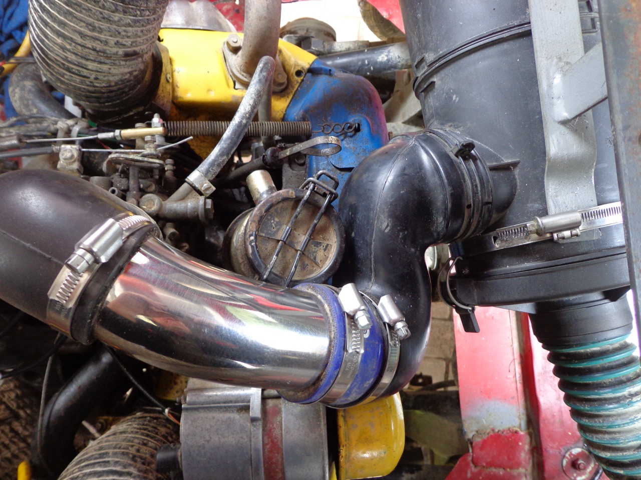

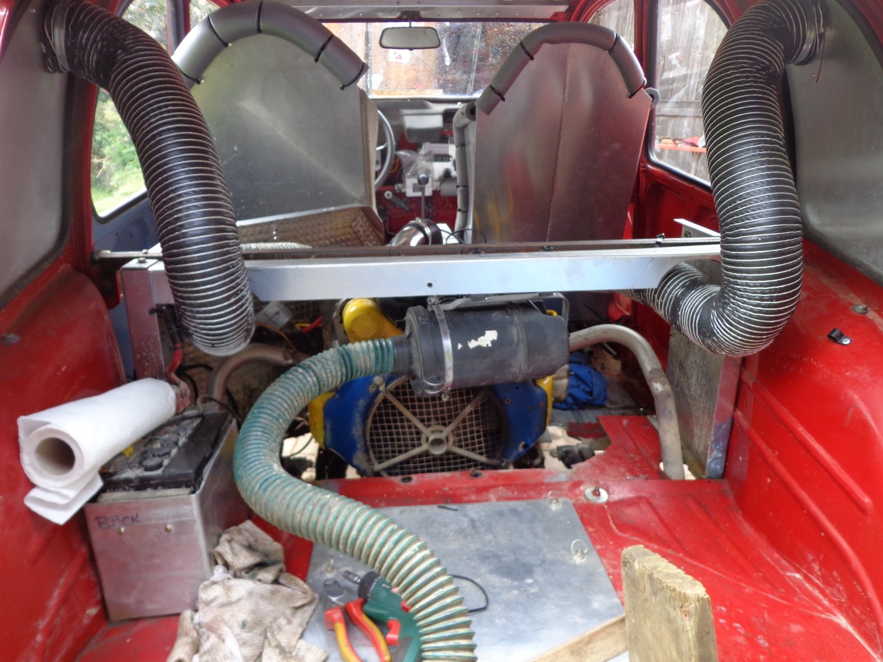

Obtained an AX air filter from the scrappy.
Has a larger Element than the 2CV, which always seems to be very dirty.
Fitted and can now more easily access the Dip Stick and the Oil Filler Cap

Eh Pete if i get it correctly you have a small dia inlet hose to the AX filter
i noticed off road that a long tube like this may restrict air flow
it may be good to up the tubing dia

'Restricts air flow'?
That's a polite way of saying that putting a vacuum cleaner hose in the intake plumbing plays havoc with the carburation... :roll:

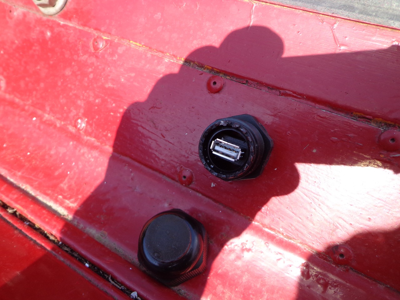

Waterproof USB Socket.
Bulkhead Gland (Size M25) £2.00
From Ebay £2.50 incl p&p
Rempve the rubber support

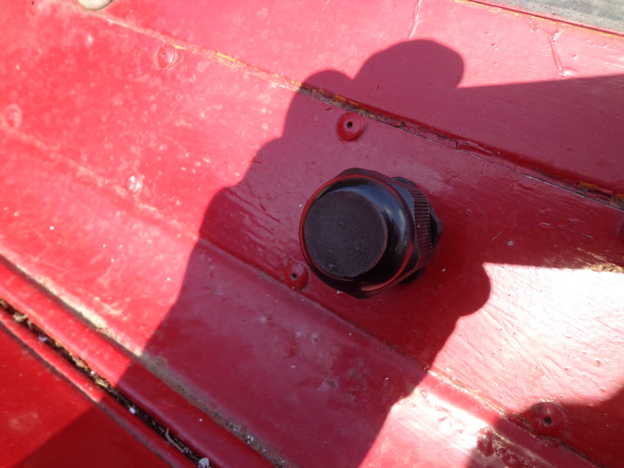

Blanking plug glued into the cap

at that price we are probably better of getting the beer in!
my pony doesn't have any cables
can you jump start it using that plug?
May 6th, 2015, 8:09 pm
If you wait 3 days to let it charge... :? :? :?
