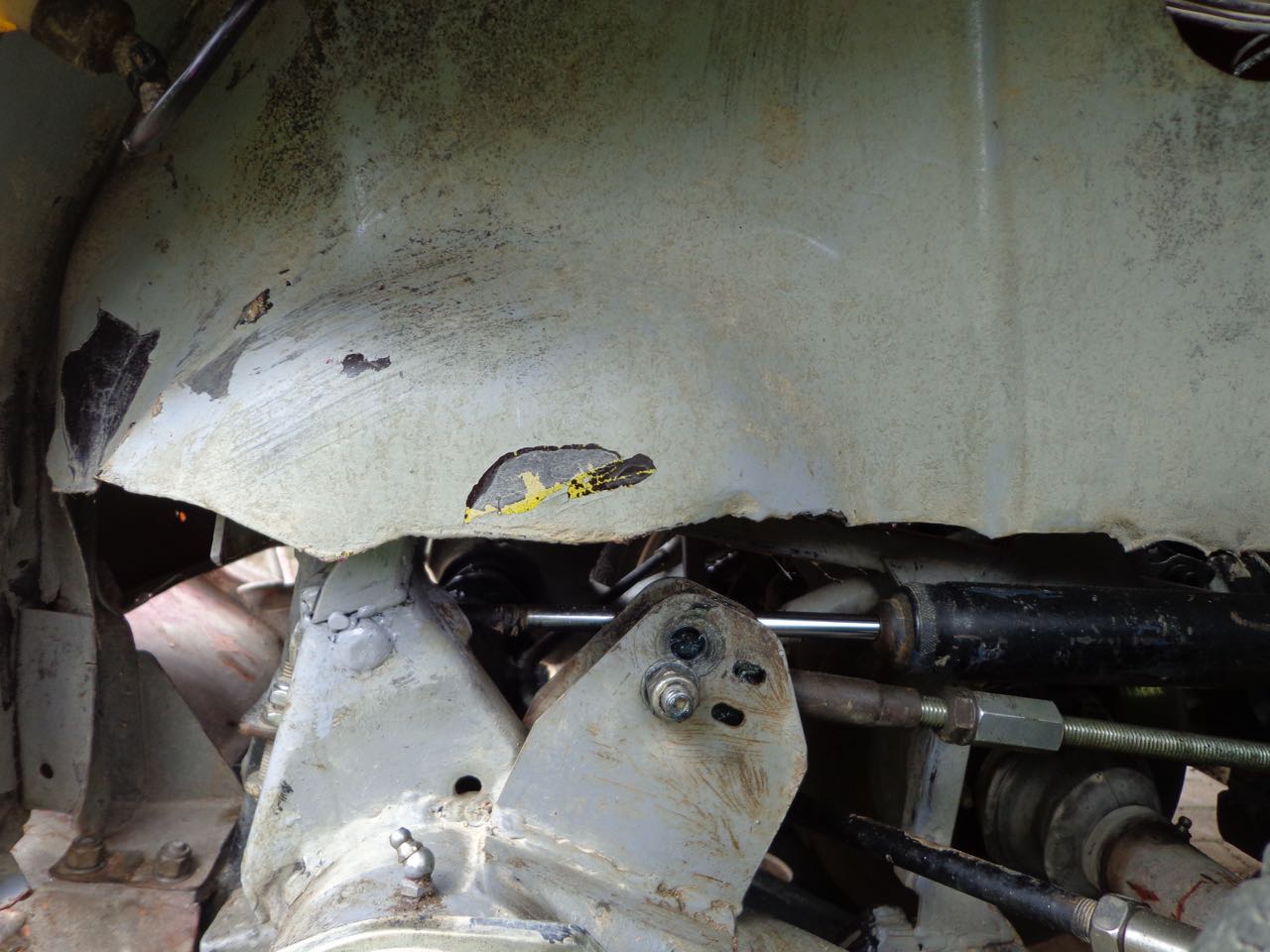

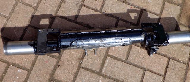

Four Bolts now hold the Steering Rack in place.
Welded a 6mm plate to each saddle

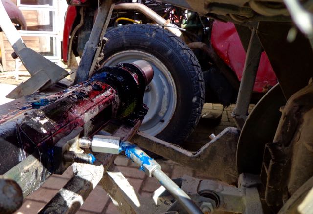

Grease via my Patented Grease method.
3mm hole thru the centre of the ball joint

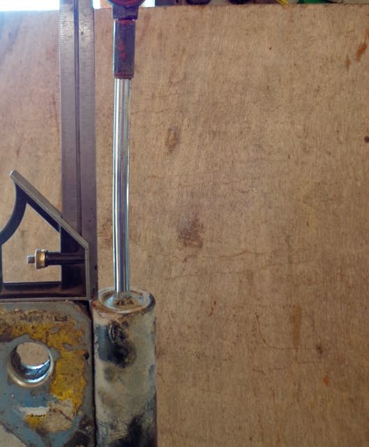

Result off unattached Axle Tube.
Bent Shock Absorber

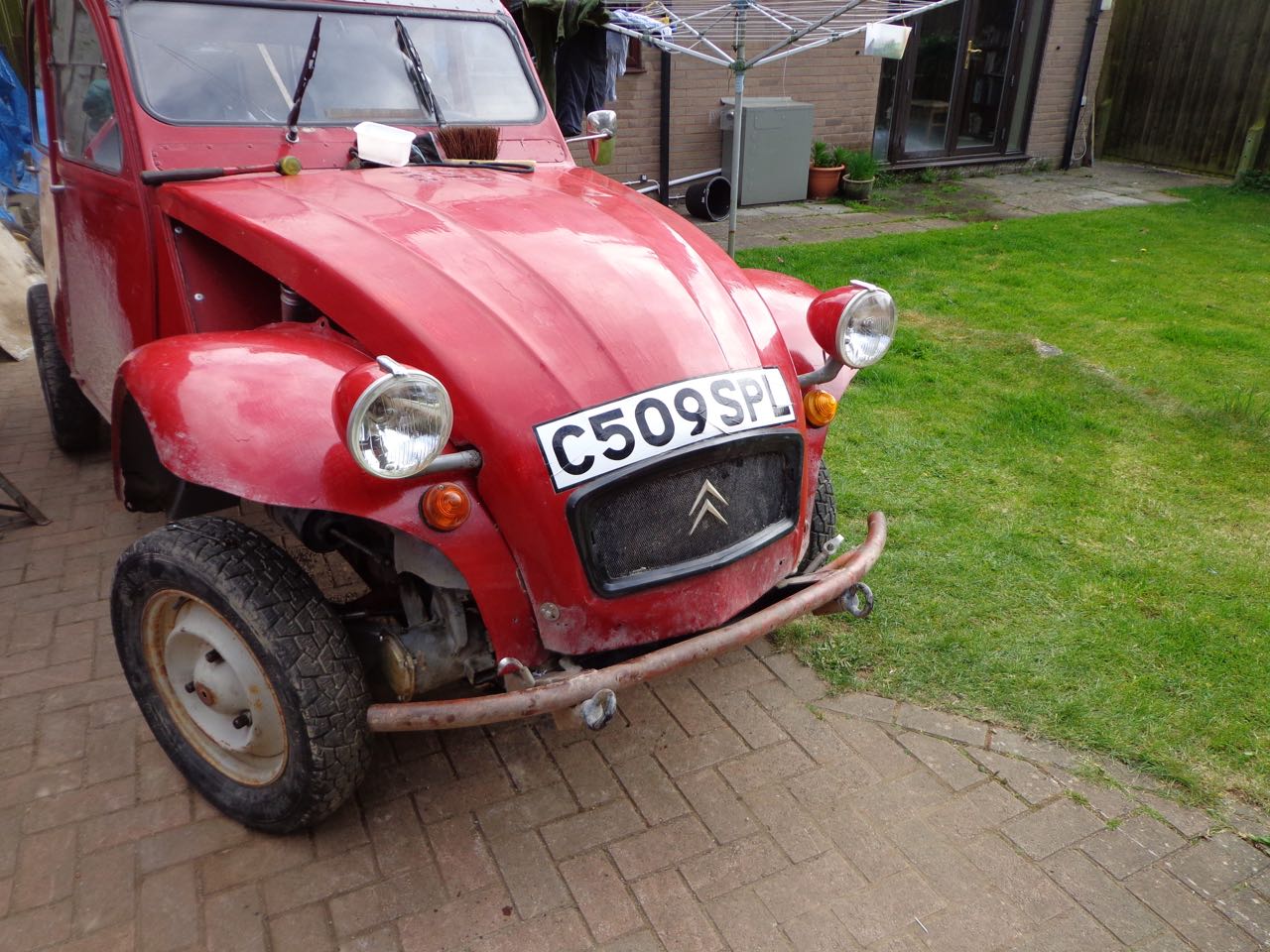

Cut away wings now have indicators.
New AK springs will have to wait for a budget.
Moved the tie rod pivot point inwards.

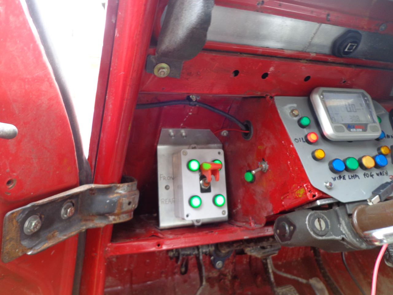

Line Lock (AKA Traction Control) now has some imported Switches with built in LED.
All 4 wheels locked

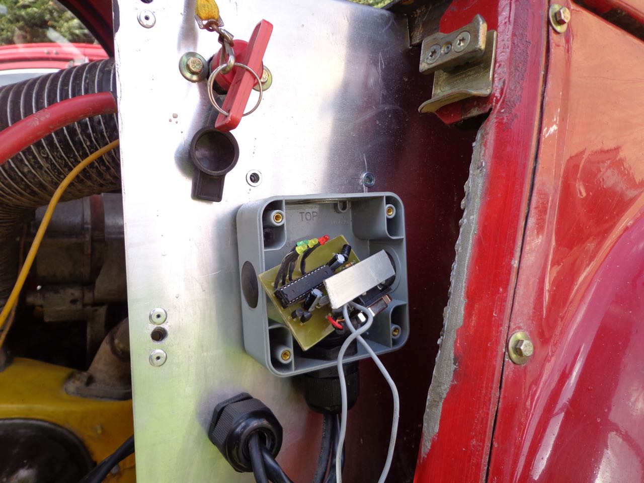

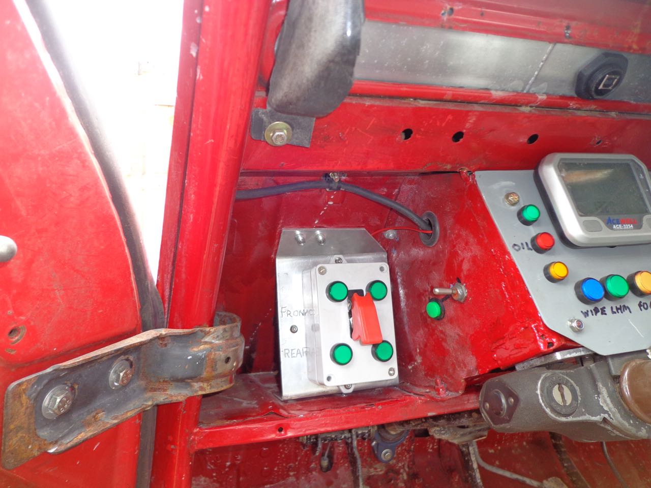

Today, as its still Sunny, started to fit 1-2 spark.
Re-housed in a waterproof/dust proof box, from the shed....
Will mount the LED's on the lid, along with the table switch.
