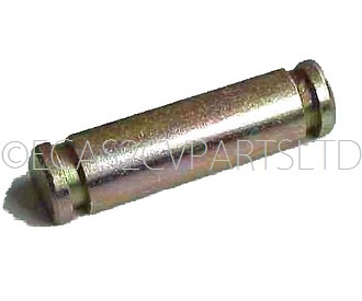

This Part
Knife Edge

March 28th, 2015, 8:21 pm
ignore... :oops:
March 28th, 2015, 8:23 pm
The tie rod eye snapped, but the one with a big nut welded on insted of a nice round one...
