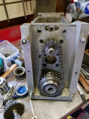

Re-make the plate to retain the bearing and hold the oil seal.

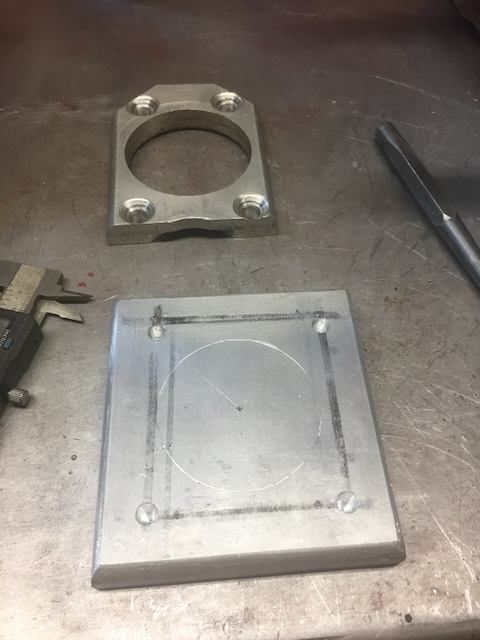

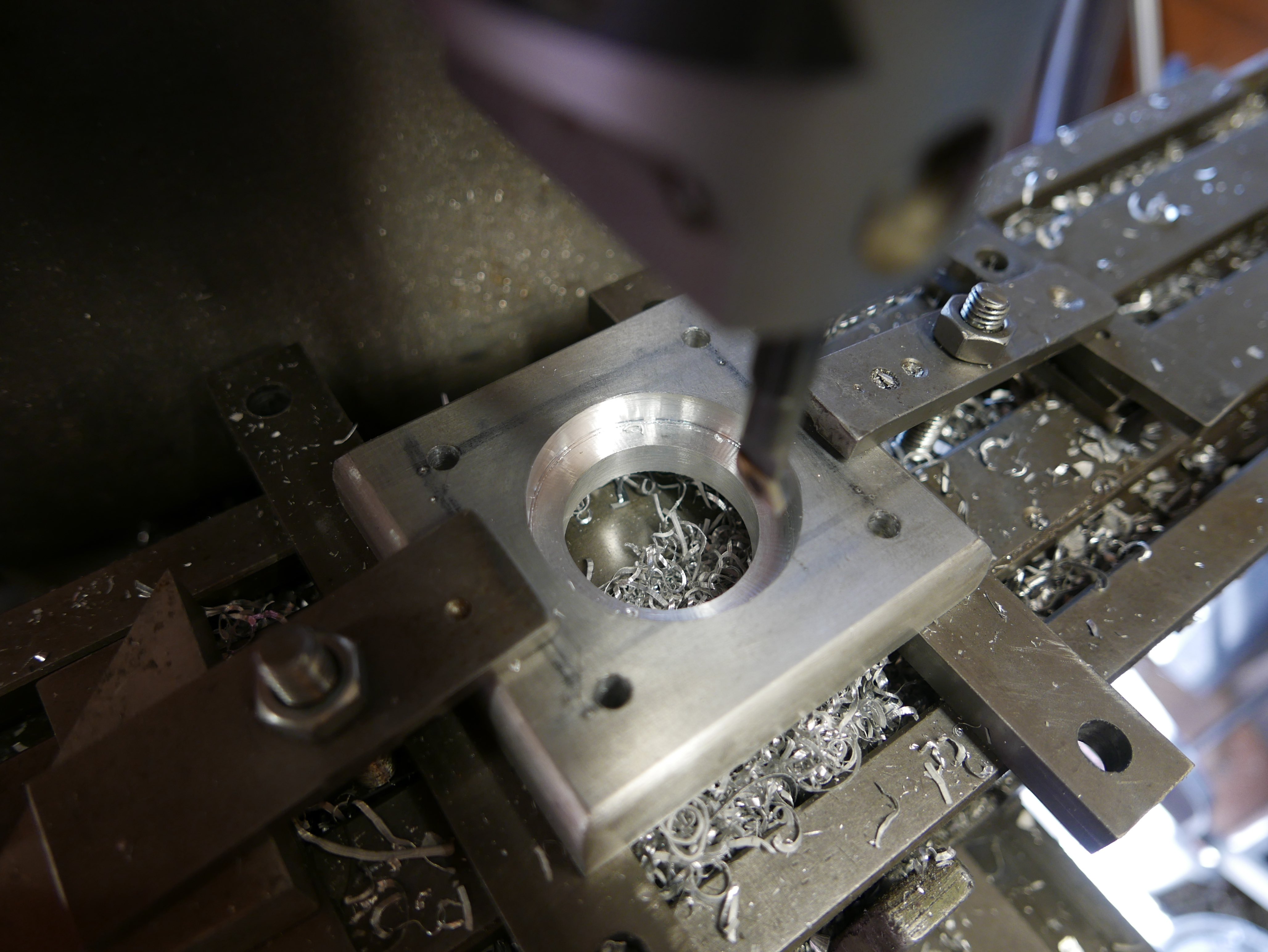

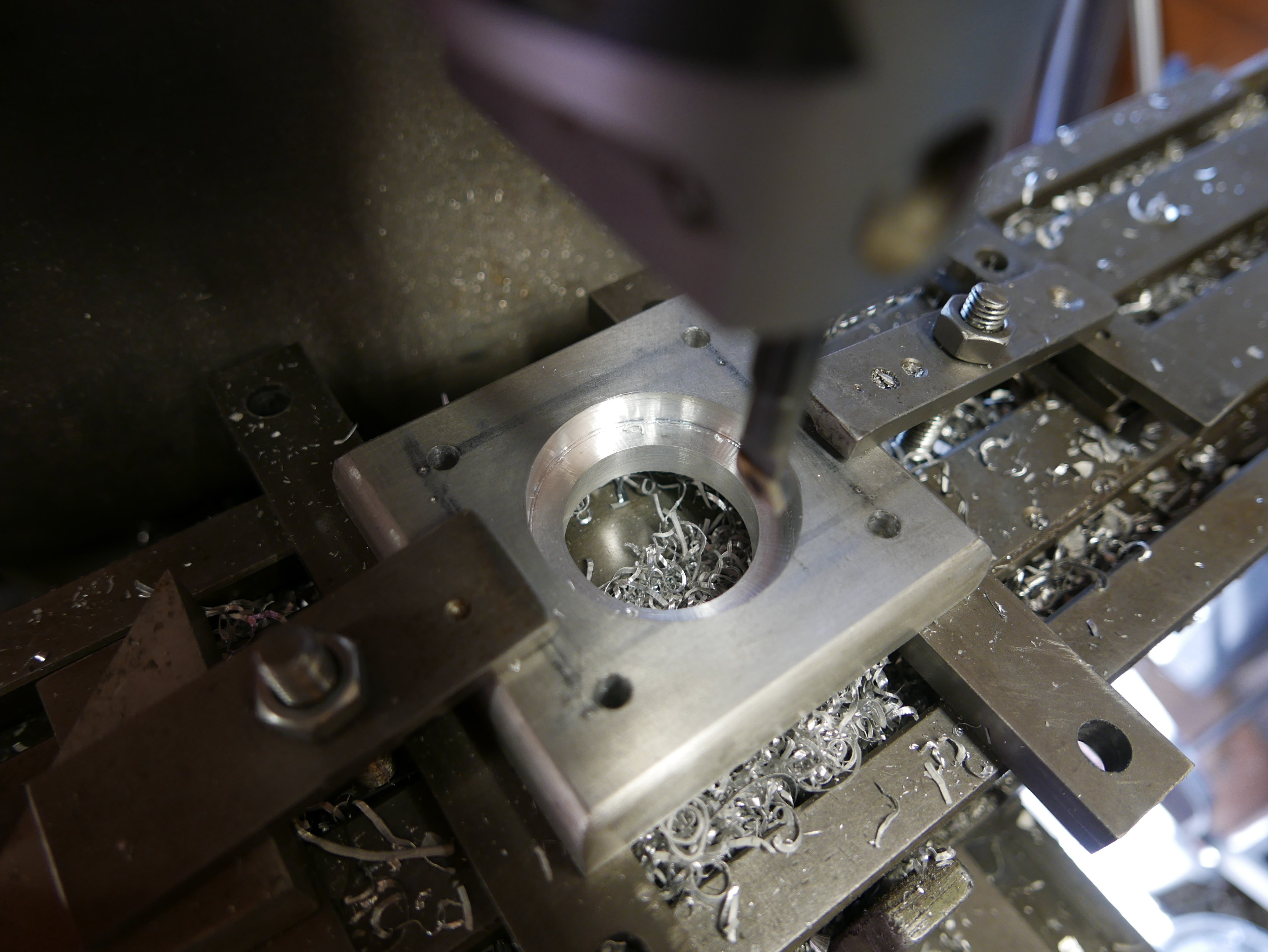

Half-way done..

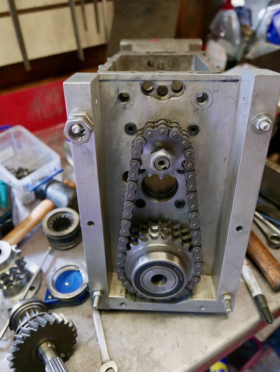

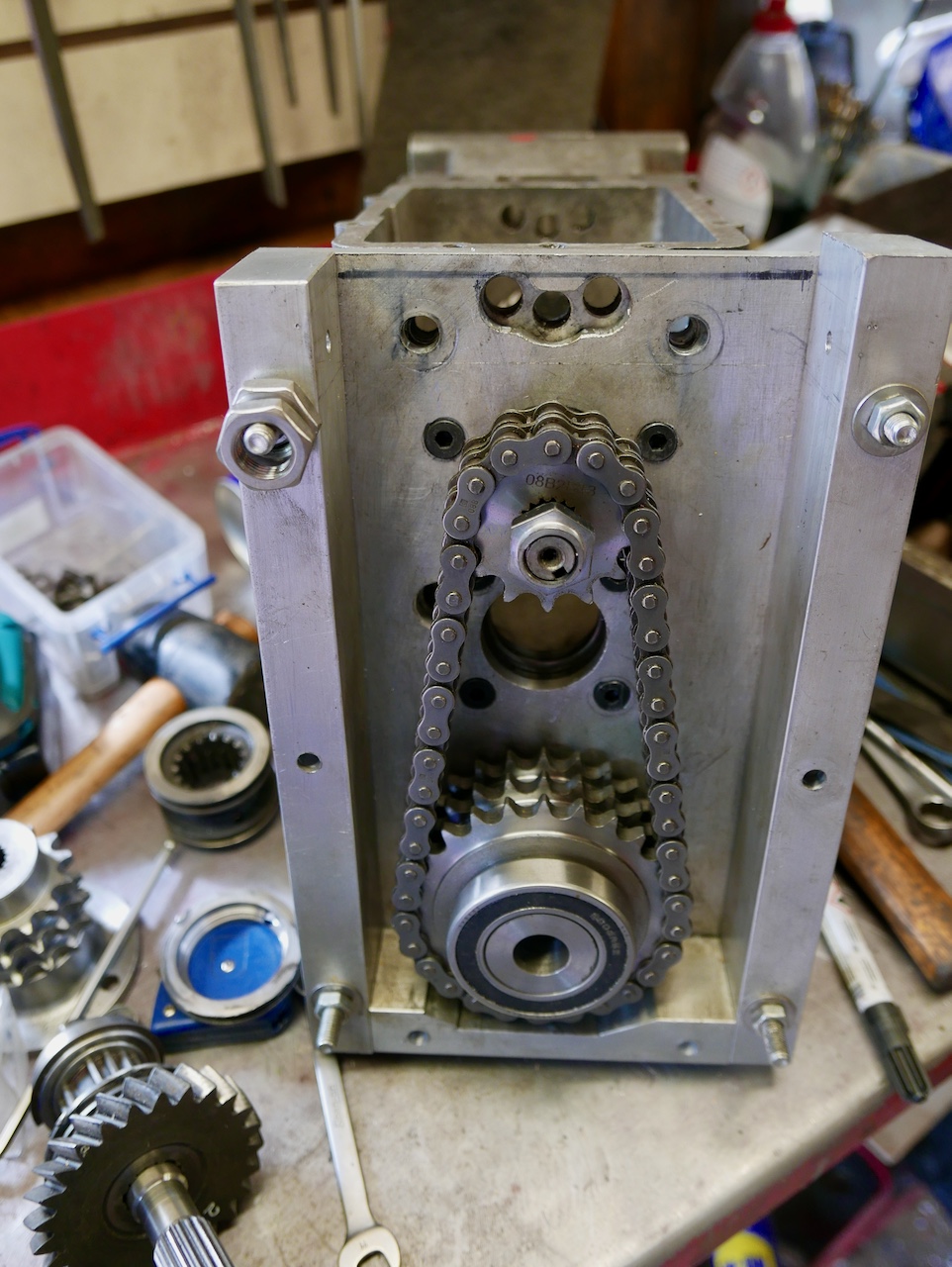

Back plate progress, now attached with M7 csk bolts (all the way fron China) needed to clear the chain.
Ordered the 10mm rear cover alu and a small bearing for the other end of the bottom shaft.
