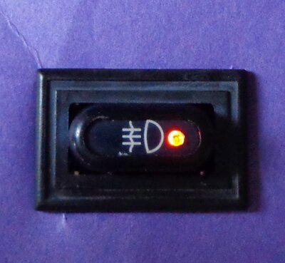

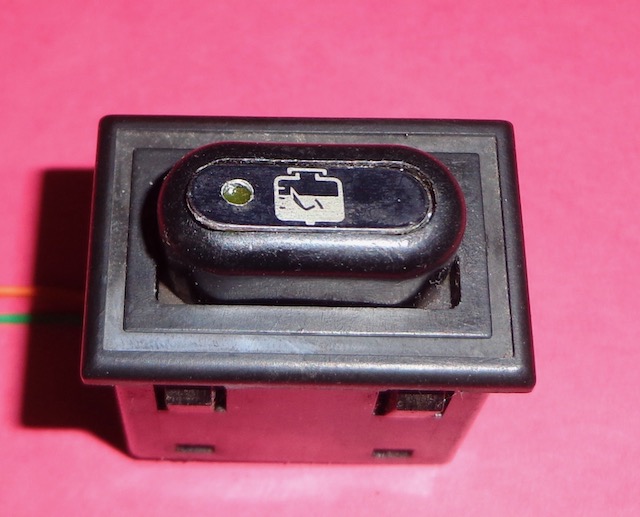

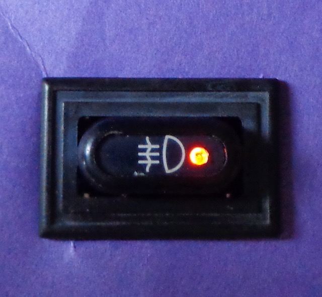

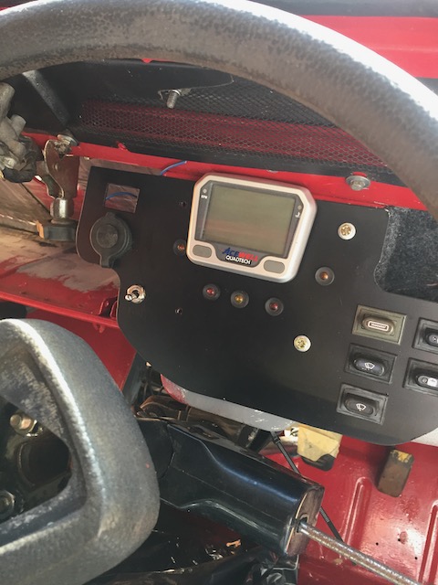

Some work on the Dash, used 2CV/GS switches, some with LED's to make the panel less cluttered and have used a Quad speedo extra functions and with wired speed sensor. no longer need a very long speedo cable from the rear diff!
Dash Board
Rear Fog + LED
LHM Level/Test + LED
Wash is now a momentory push

That's amazing. Love the lights on the switches, so clever.

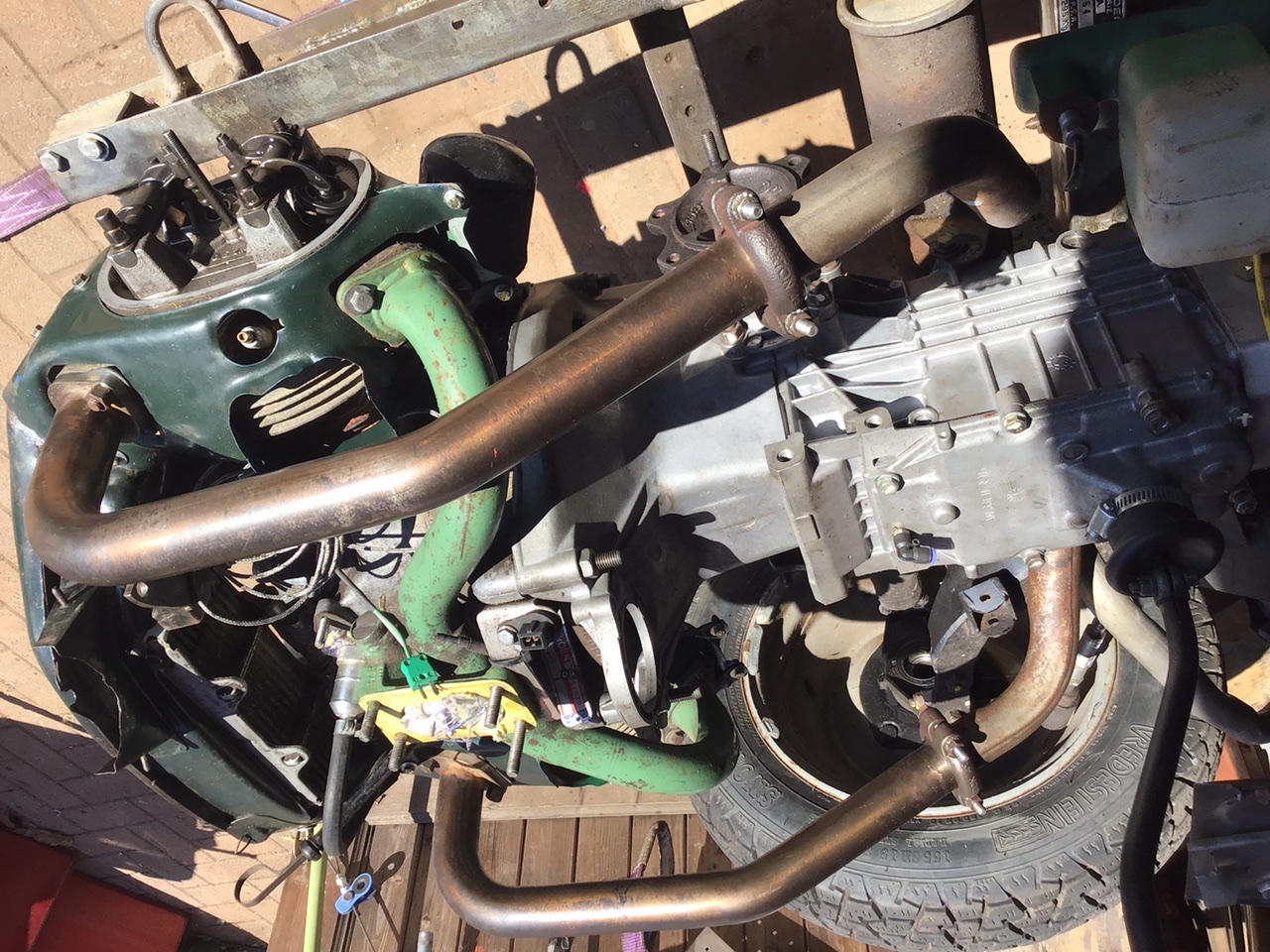

Engine and “clean” gearbox in place minus lots if bits, the hardest to fit is the clutch cable, which is in the post.

I thought you had fitted something like a lister stationary engine.... strange photo angle. ;-)

It does a bit, even funnier as my first job was at Lister’s.
Some times uploaded images are inverted :(

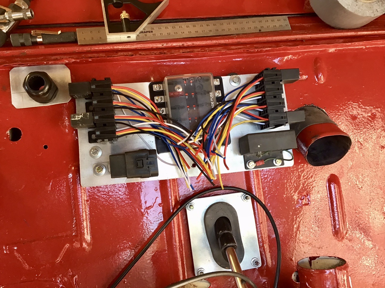

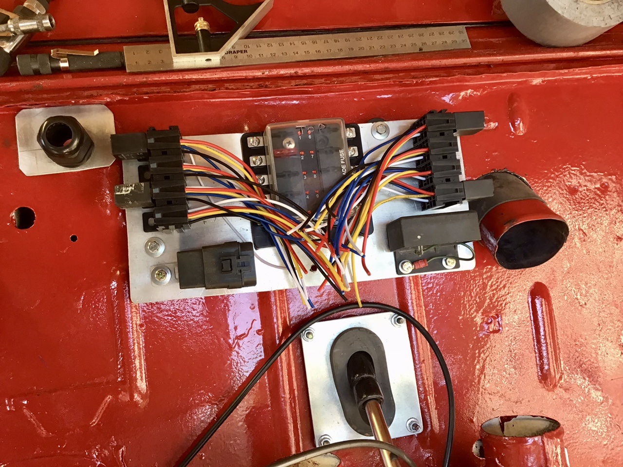

New wiring, fuses and relays.
Ps maybe over the top, but making things keeps me sane…

Nice :D

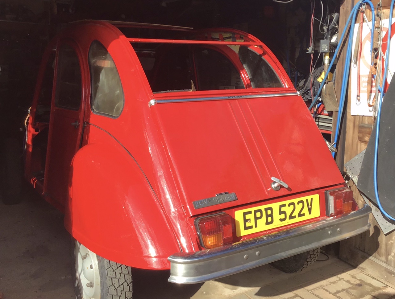

Rear end complete, waiting for a new hood, still a lot to do at the other end.

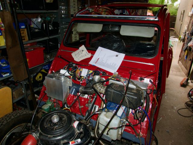

Engine Bay
Rewire as its now RHD relays and fuses to save the old citroen switches, also added the Diesel heater and tank as I feel the cold more now.
List to do on wiper....

Nice to deroute the MOT tester ;-)
