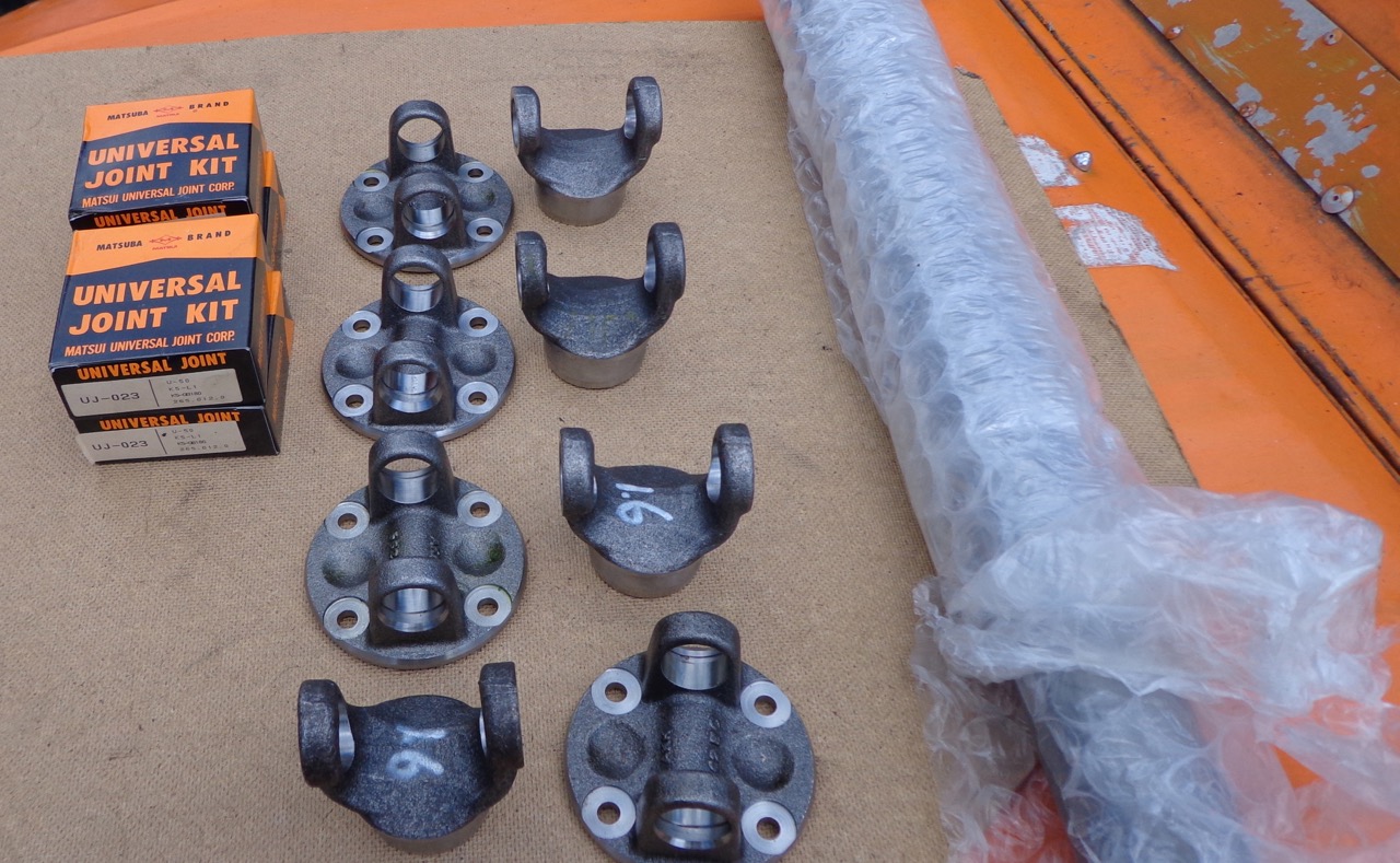

These can take the RPM and no gaiter ;)
Parts.

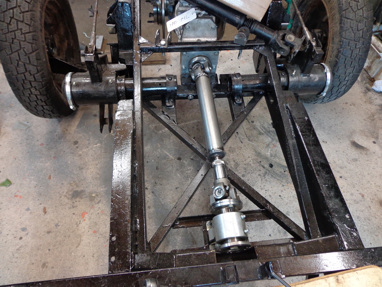

Finished Shaft.

Those joints what I have installed, are slightly different gaiters, but same joint. The other is originally from Transporter Syncro prop shaft and the other is from Bora drive shaft. Guess wich one lost its gaiter..? :lol:

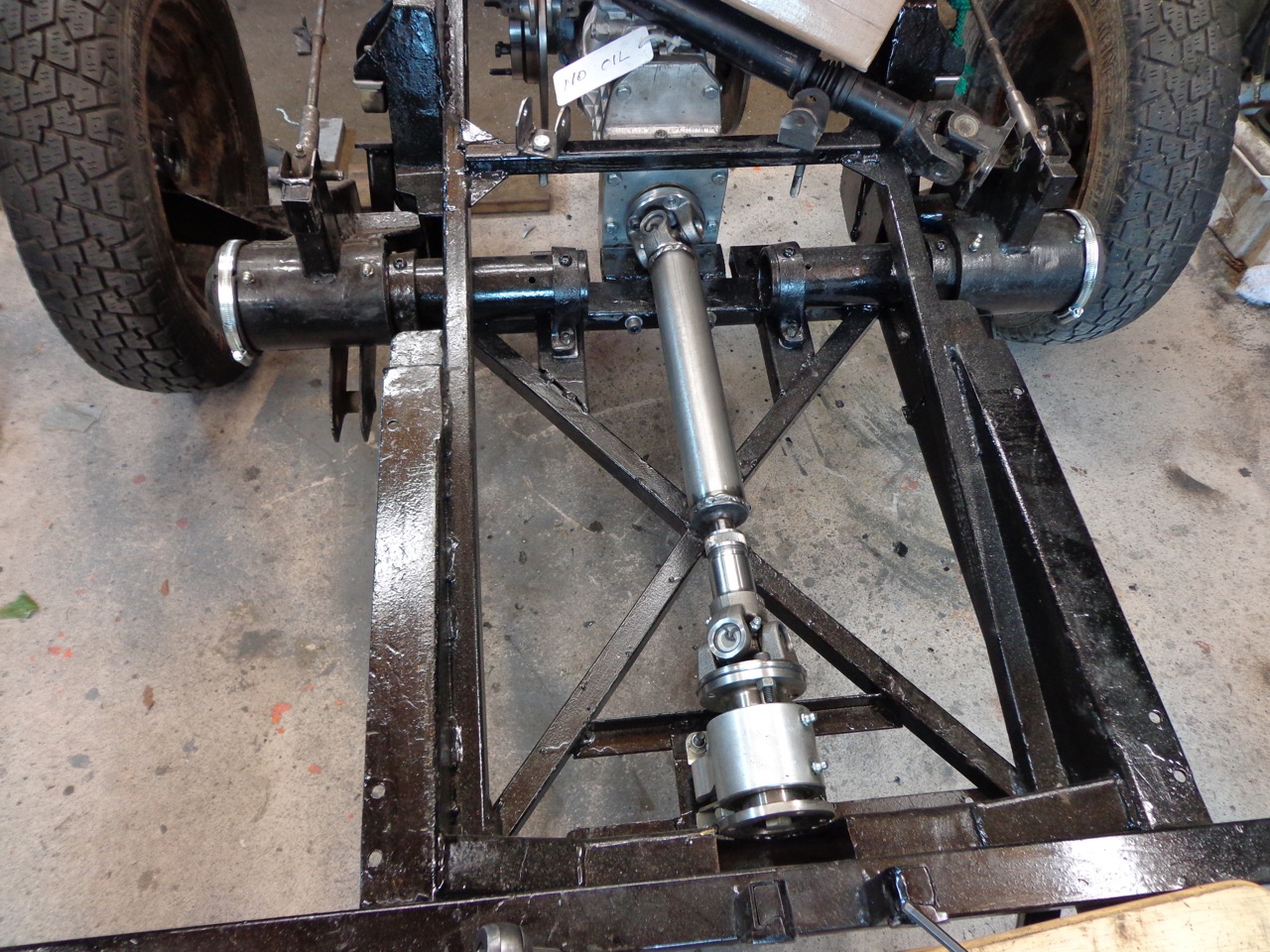

Picture with lever and cable, like them, from VW also??

The joint is just above the lever, what is from Bx as is the cable...
