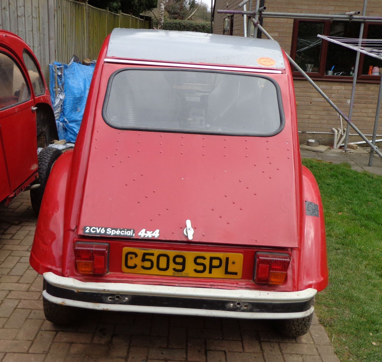

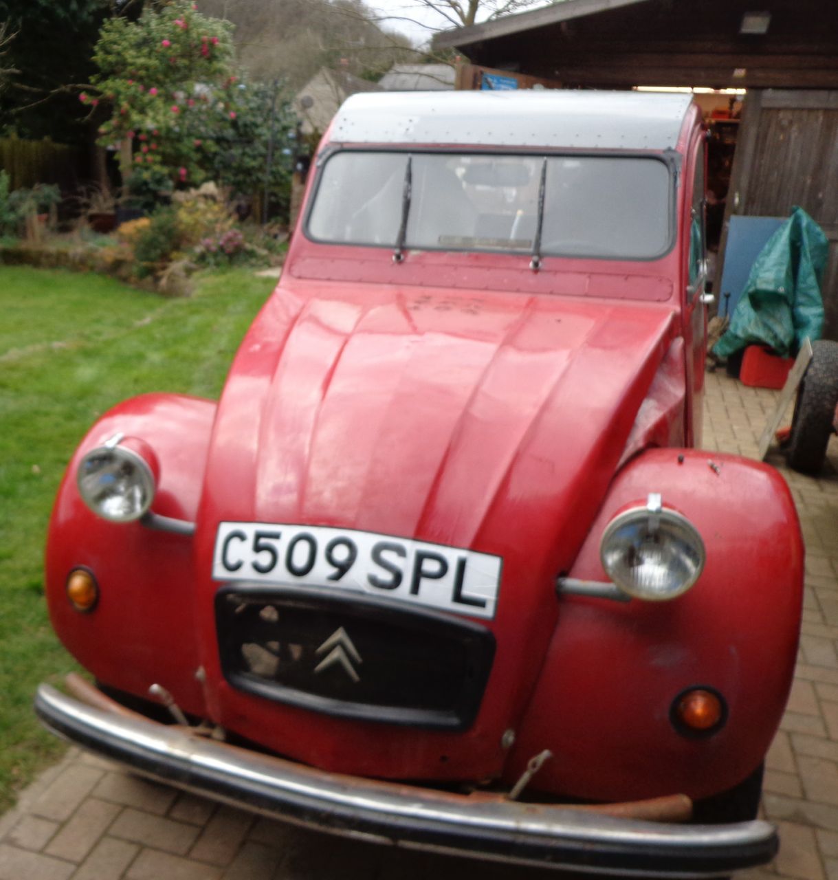

@Harley,
Some pics to help you Identify the Front and Rear of a 2CV
:lol: :lol:
F R O N T
Headlamps, Wipers and a Grill
R E A R
No Headlamps, No Wipers, No Grill

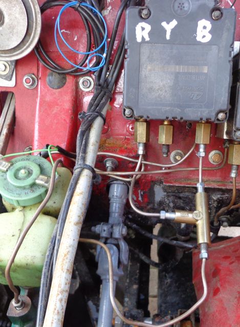

Traction Control Mark 2.
Front Brake Circuits.
Made some pipes today, so that the ABS valves can be used in the reverse direction.
Push the brake pedal down.
Set the chosen valve to be closed.
Release the brake pedal, and chosen wheel will be locked.
Bit of wiring and some switches to do.
March 21st, 2015, 6:13 pm
OK explain - why do you want the wheels to lock on
March 21st, 2015, 8:49 pm
When stuck, sometimes the wheels on opposite corners have little or no grip.
Thus if the wheels can been locked, you may be able to drive off.
