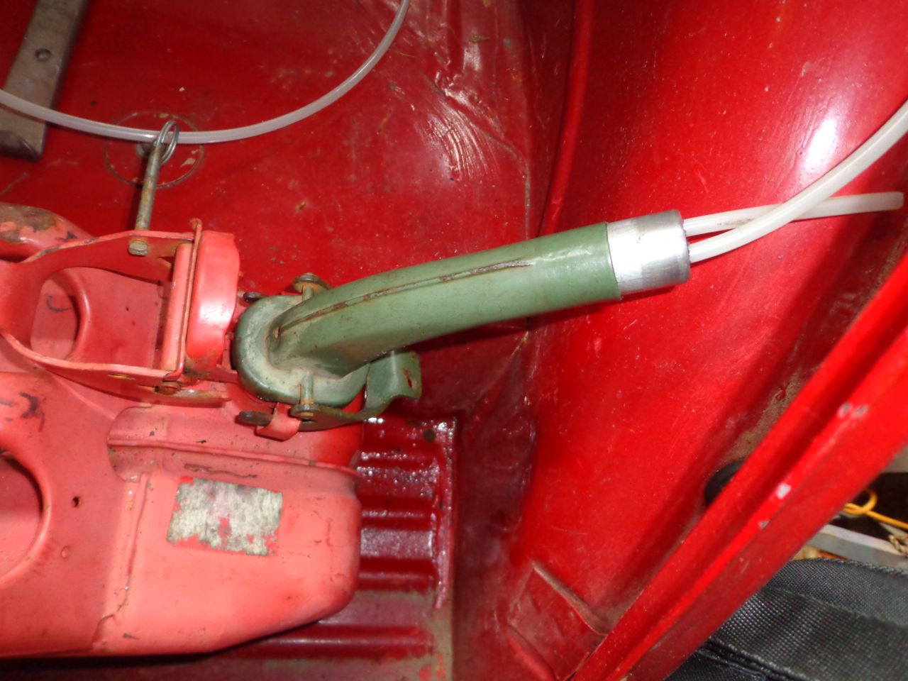

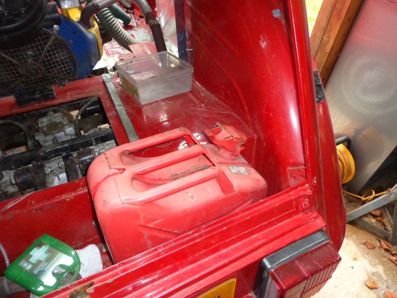

Not that happy with the fuel tank in the front, so the plan to fit a half size jerry can in the rear.

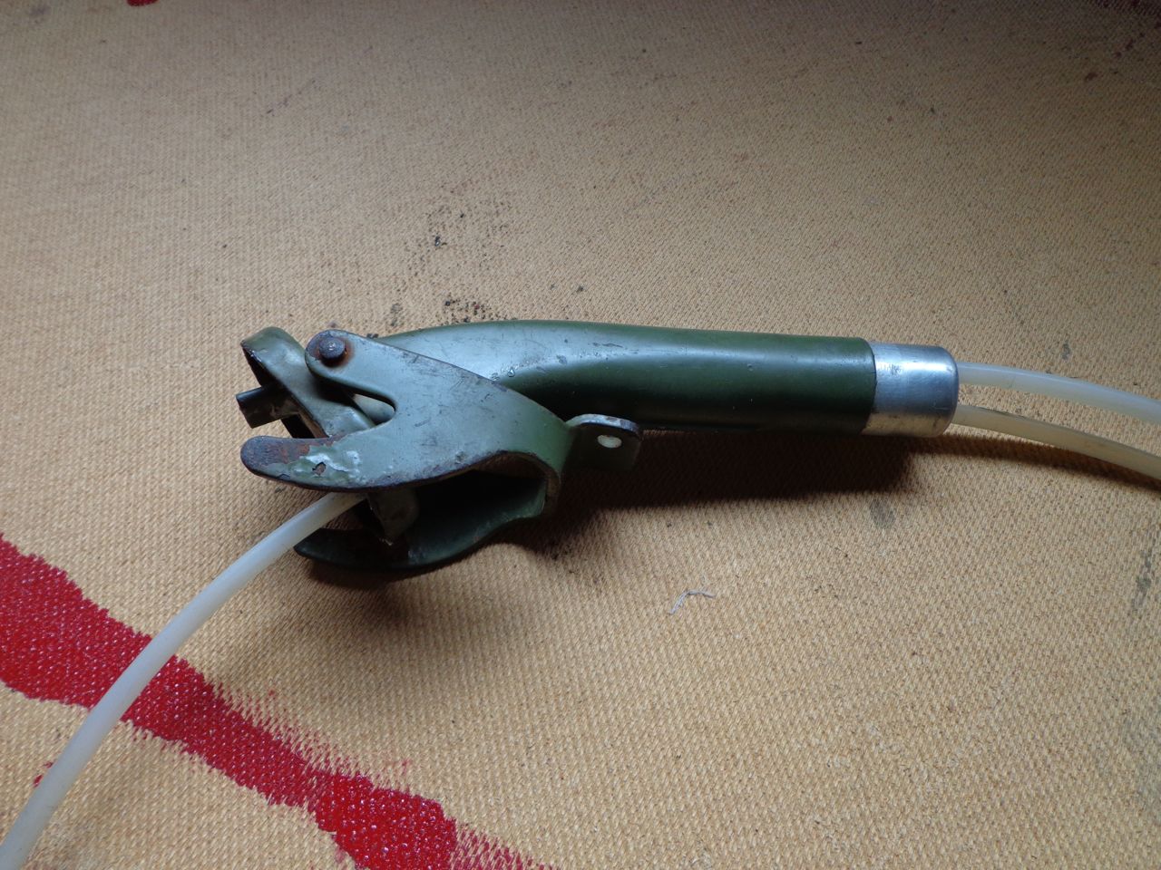

Made an adaptor from a standard jerry can filler pipe.
Pipe 1 is the fuel line, Pipe 2 is the breather. The standard breather hole is filled with Expoxy putty.

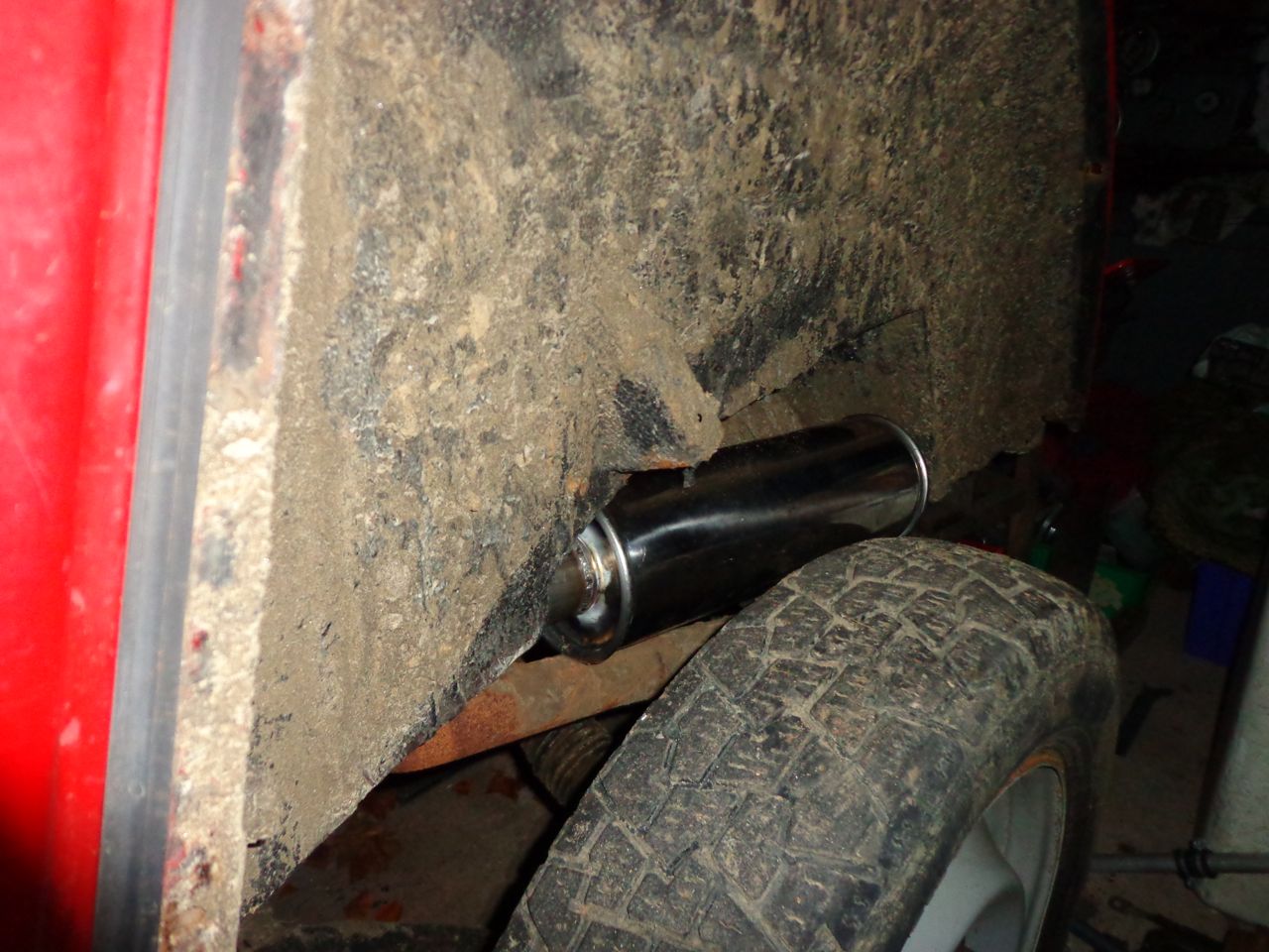

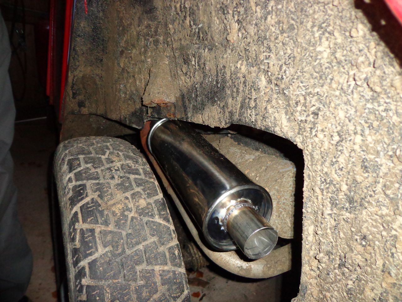

The beast is too noisy, so sourced some small silencers.
Need to make some new pipes to fit silencers one each side in the rear wing

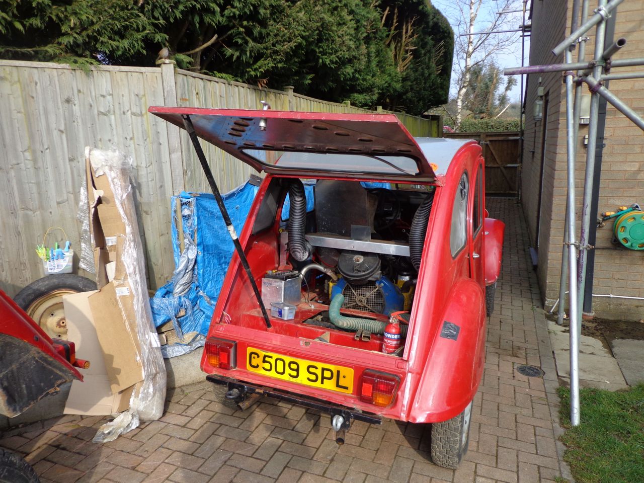

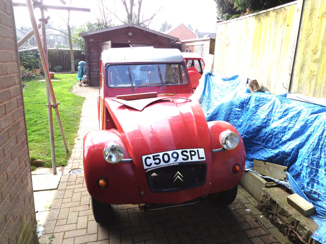

Going to Morvan at Easter.
It runs/goes but some improvements to be done.
Second Silencer.
Replace gear lever to the long version.
Fit Engine Cover.
Fit Rear Wing drivers side.
Add reinforcement to rear gearbox mount.
Bleed Front Brakes
If time semi-fiddle brakes.

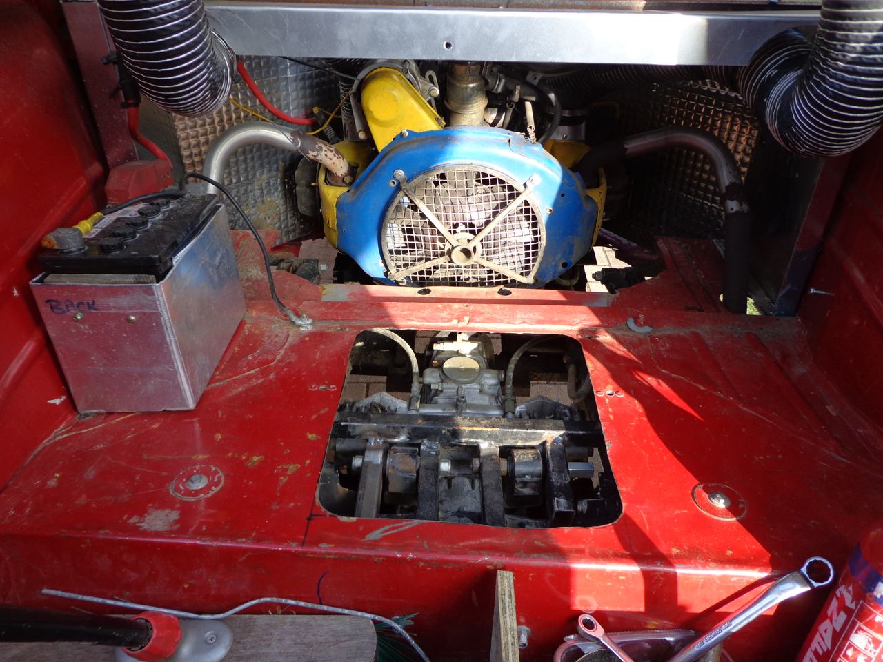

Added some braces to rear diff mount.
Not very tidy, but needs the body off to do a re-design.
Larger access hole now needs a new larger cover.

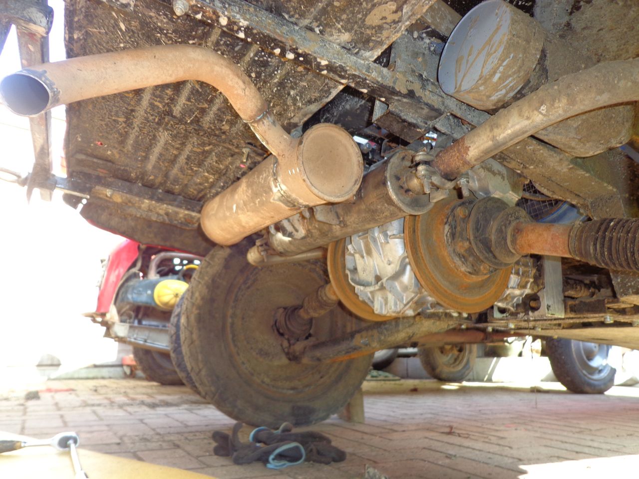

March 19th, 2015, 5:13 pm
Modified the exhaust by adding the damaged cross-box from the Bokkerijders event
Still not as quite as a standard system, but much better that it was.
Why chuck it in the bin?
Adapt and reuse...
