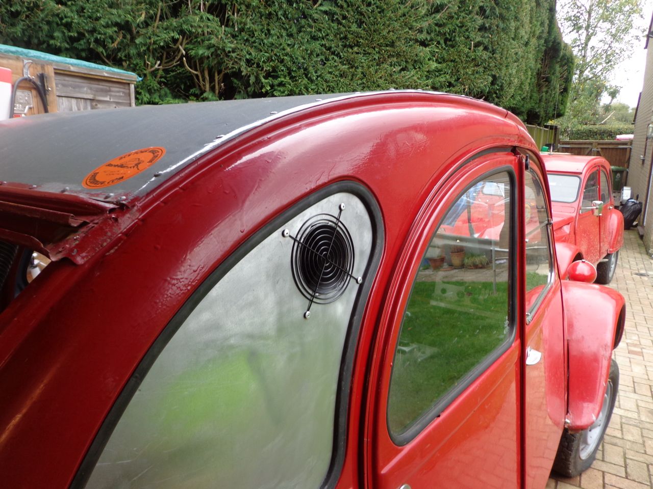

Fitted grills to my hot air ducts, looks like a target ;)

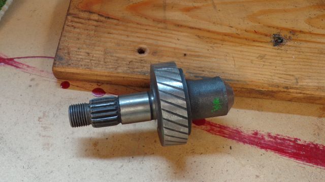

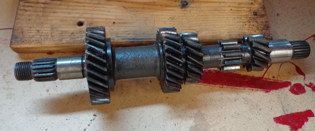

Redundant Layshaft.
Lay shaft cut down to make new input shaft

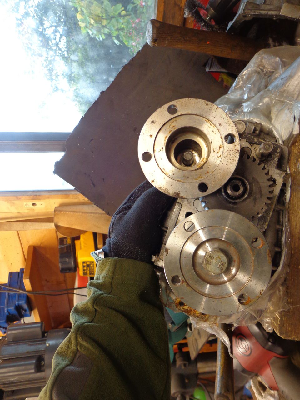

Drive Flange (internal splines to fit pinion shaft.)
Drive Flange fitted fits 1100 UJ flanges

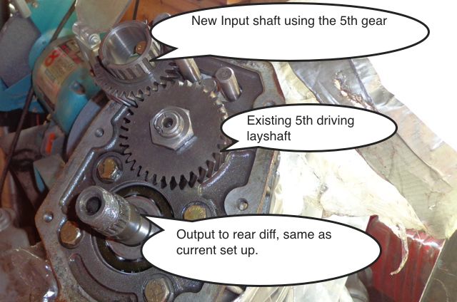

Measured up the positions for input flange and output flange, just enough room :D

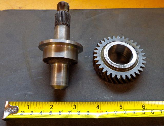

The cost to wire cut/spark erode involute splines onto these two parts would be £780 + Vat + shipping.
The old guy who did my last work (£105) has passed away, apparently he worked it the company as a hobby and liked do work for amateurs.
Could perhaps do a friction fit with some welds, but thats not a very good solution.
