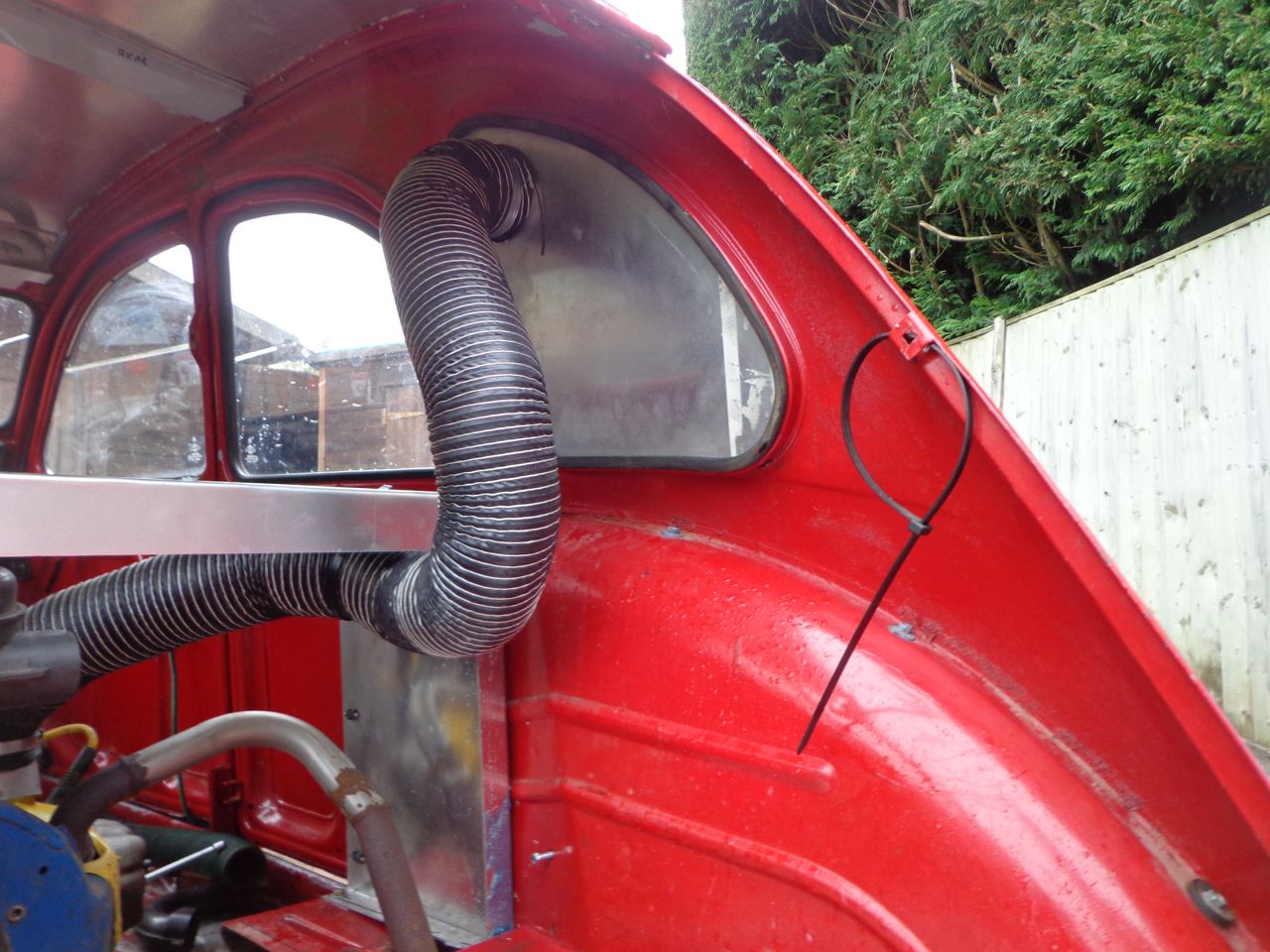

With the engine cover + sound proof, the car is much quieter, however the tunnel gets to hot to lean on.
All the air recirculates even though the engine compartment has no floor.
Got some large pipe to go from heat exchanger to the quarter lights.
Pipe.
Outlet point.

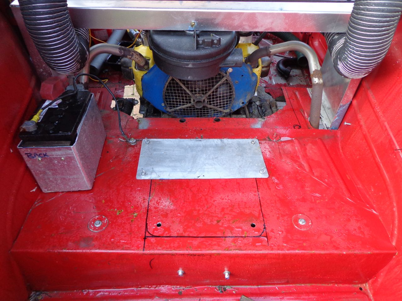

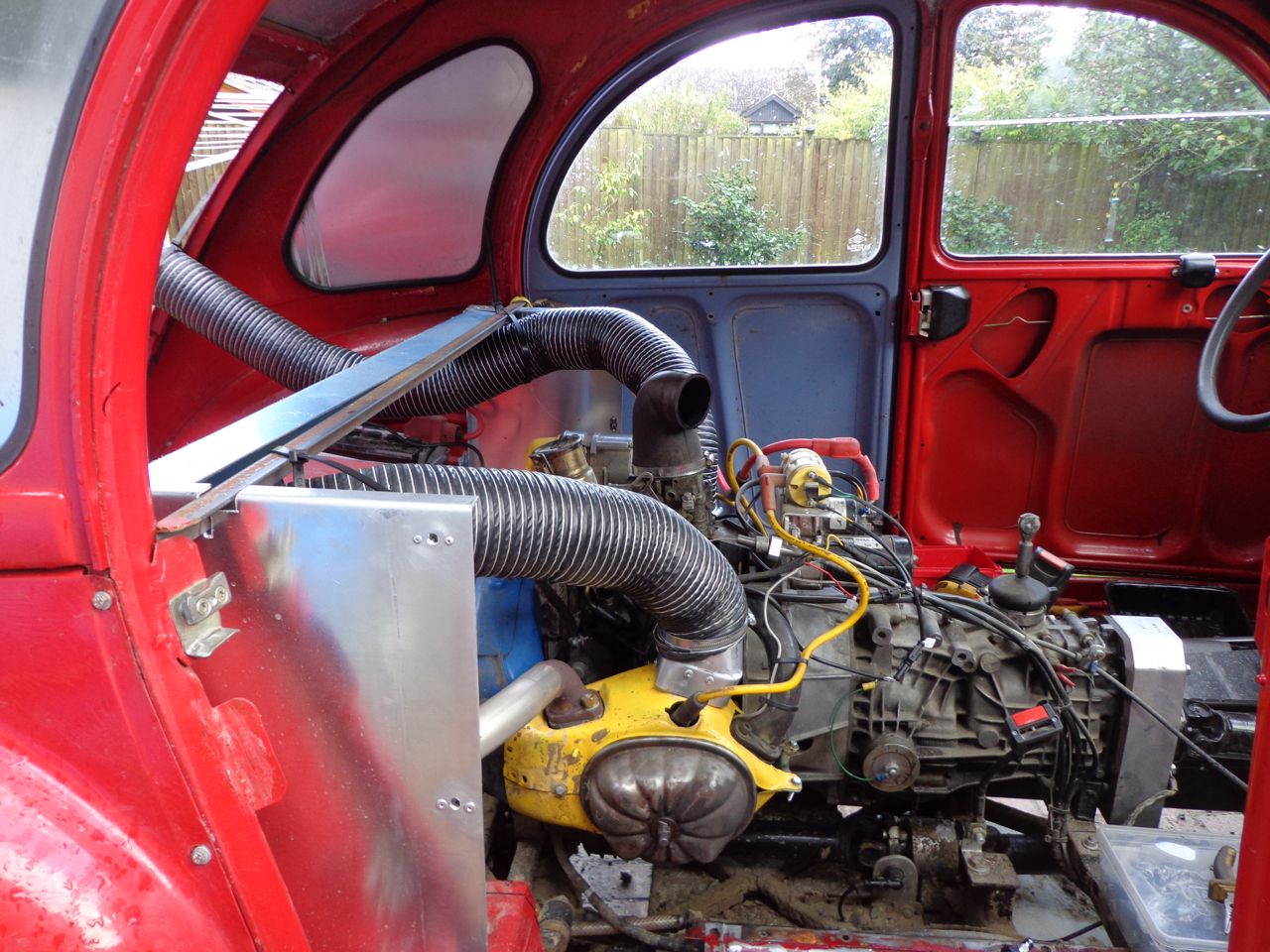

Made the Square to round adaptors on the engine covers, connected up the pipes.
Run the engine and the volume of hot air shows how efficient the 2CV fan is.
But the starter motor just gave up the :(

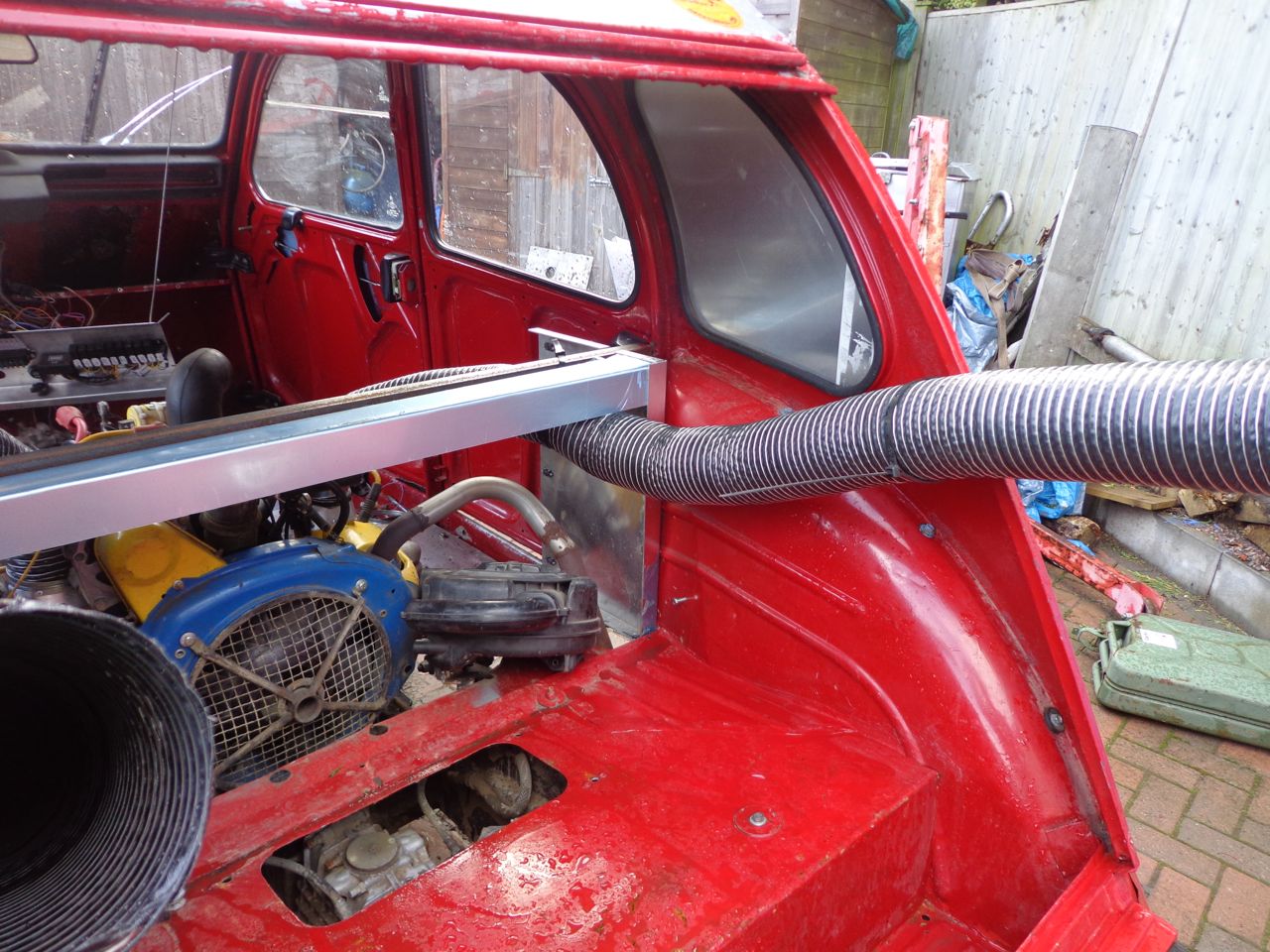

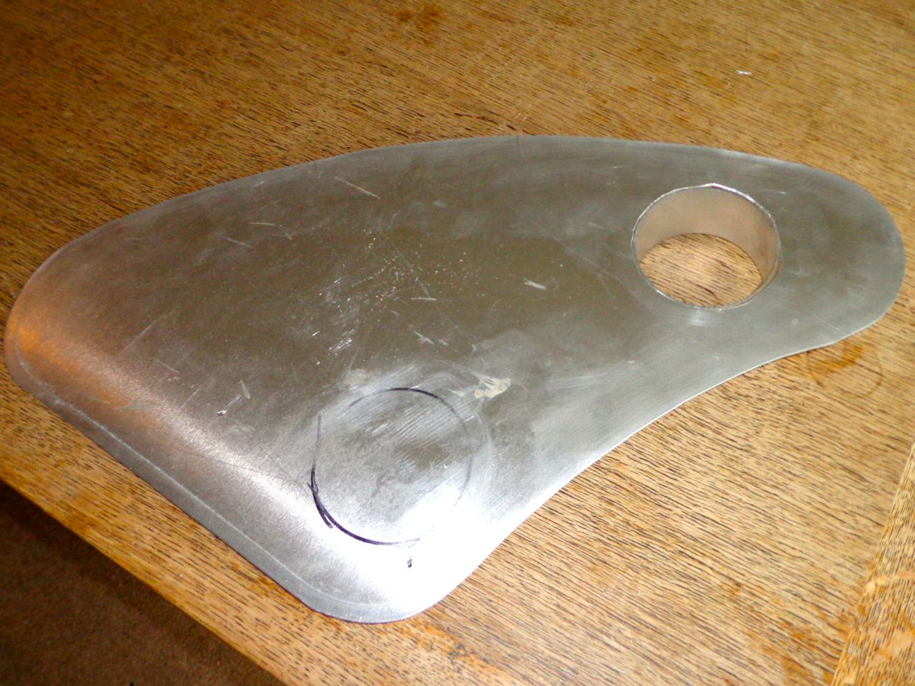

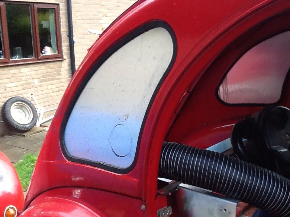

Got the pipes welded to the quarter light panels.

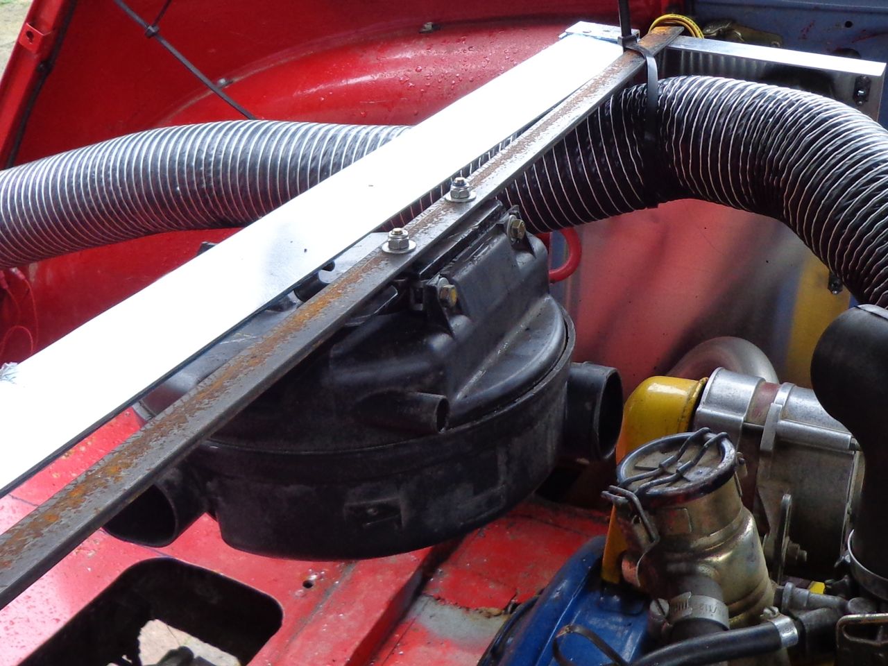

Fitted the pipes.

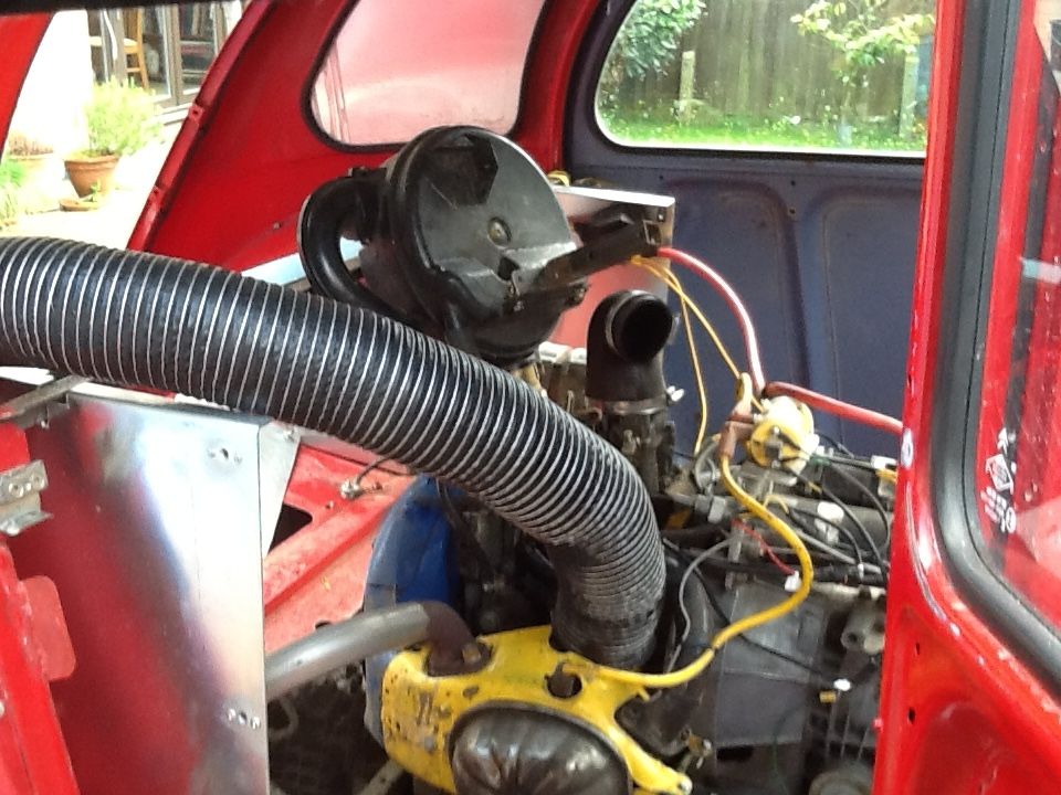

The room for the air cleaner was now to small so I fitted it upside down on the cross bar.

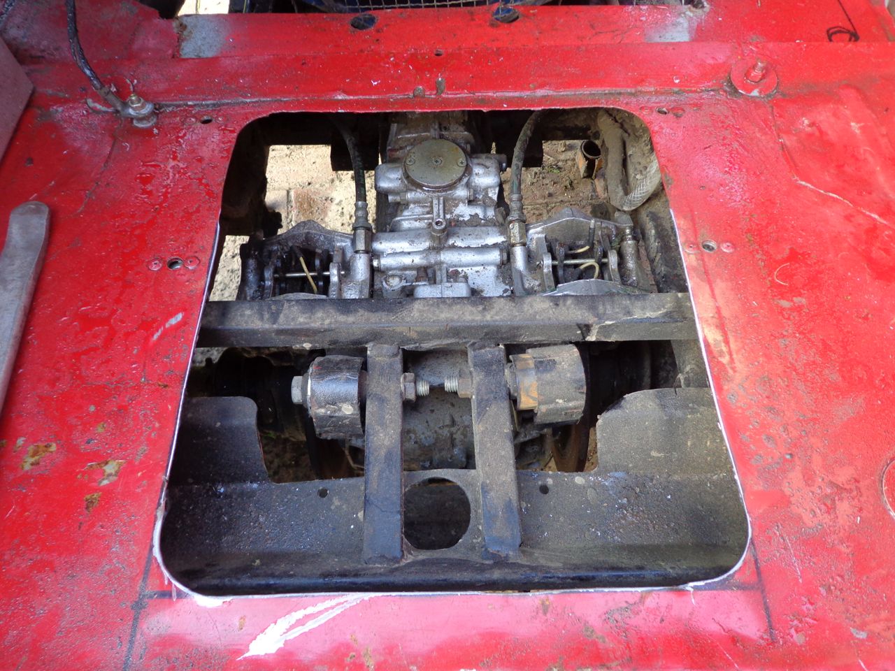

Design Once, Build many times..

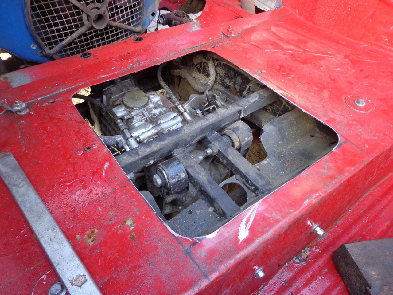

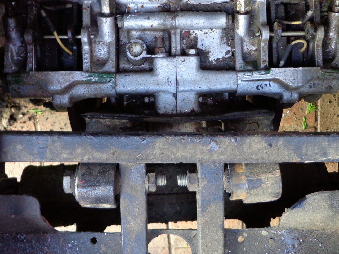

Current hole in the boot doesn't give view to the rear diff mounts.
Larger Hole.
Suprise,Suprise
Same as the front but not as bad.
