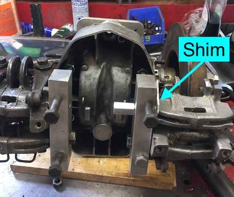

Measure many times... Still need shim to align with the brake disc...

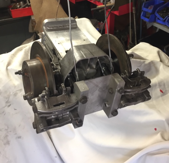

April 19th, 2024, 2:34 pm

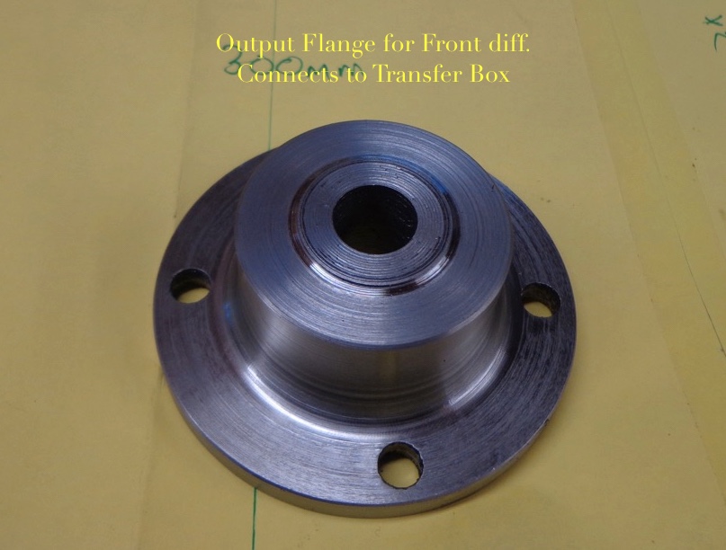

Supports for calipers done, discs dont bind, so happy.
Need to purchasesome steel bar to turn up the drive flange.

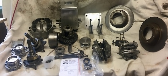

Pile of parts to be cleaned and assembled (eventually).

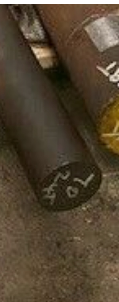

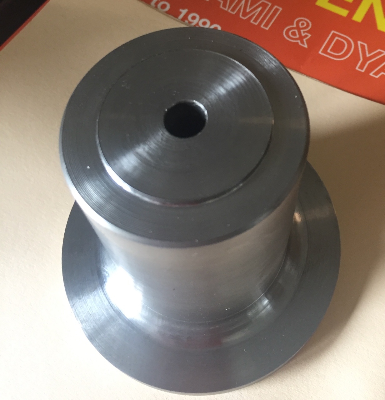

Stages to make a drive flange
Initial 90mm x 100m EN24 T Steel Bar.

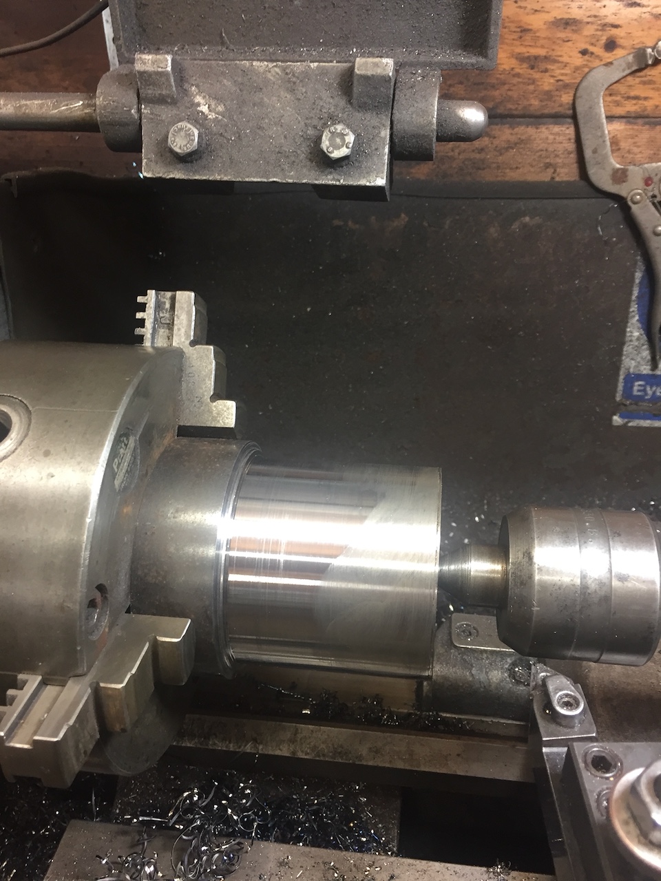

First stage of turning (between centres) as its a large lump of material,
This another , the new item will have a tail at 70mm.

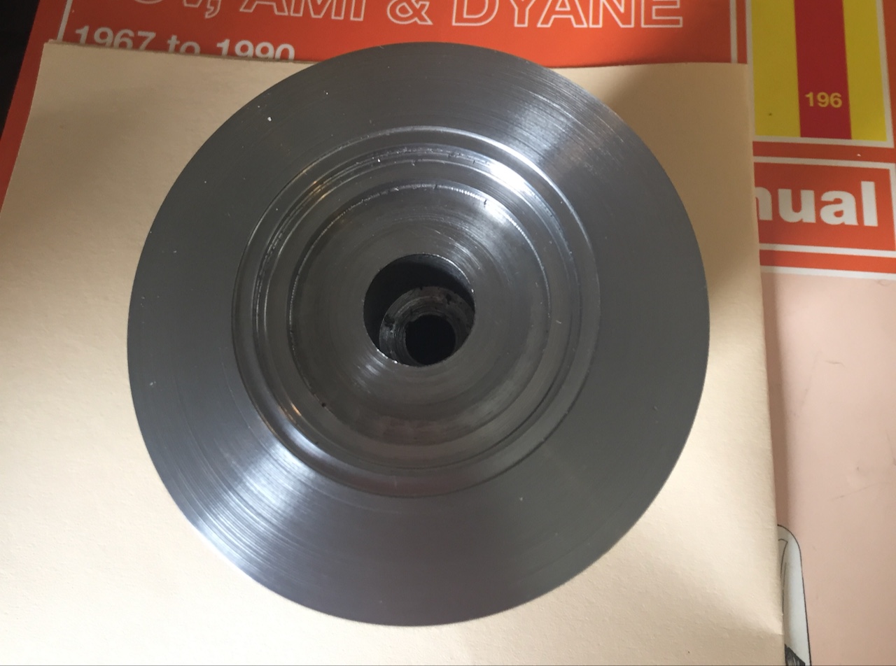

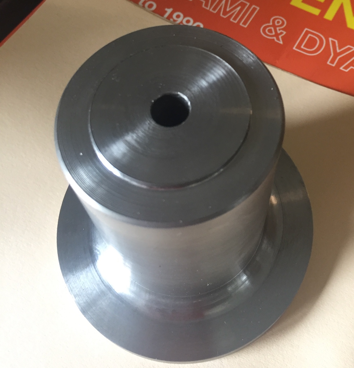

Now need to have the splines wire cut and to drill th 4 holes...
